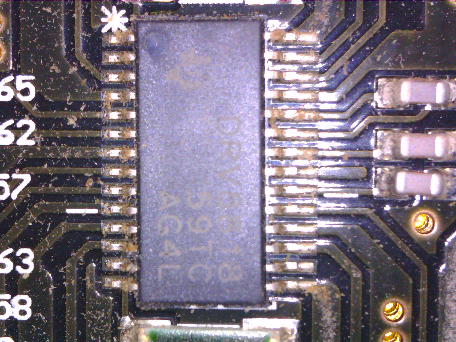

Looking around the board a bit more I saw this, a view of the driver IC and you will notice the dust on the pins, some even bridged with dust.
So whats the point to this…
Most of the dust I produce is from MDF and I doubt there is much to worry about here, but this did start me to wonder about dust accumulation from other types of material, especially if there is a metal element to it.
A common topic here is disconnects from static build up, or even seemingly random disconnects. If this has anything to do with that, maybe, maybe not, but I will make it a maintenance task to blow the controller out from time to time with some compressed air.
Can’t hurt and it if helps anything then fantastic.

Good find, and thanks for sharing.
I will add cleaning out the controller box to my list…
so, low humidity and you get static,
High humidity and the dust bunnies become conductive?
I’ve used silicone conformal coating for controller protection but don’t have long term use data yet.
Aluminum dust can cause some funny things to happen too
