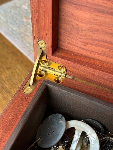

If you’ve more boxes in your future, check out quadrant hinges, they have a built-in lid stop. Brusso makes the standard, beware of inferior knock-offs. [Looks like I forgot to put the rest of the screws in wife’s box!]
Thanks for the kind words. As for the wine, I was told that a Bordeaux had the best chance of still being good in 10 years, and this one in particular got high marks for expected longevity. Fingers crossed.
Hopefully they don’t mar up your (their) box trying to get those flat blade screws out.
I looked at those - very nice. But I was set on hardware with a dark brass finish, and could only find good quadrant hinges in bright brass. Once the box was done, I couldn’t find a suitable padlock in dark brass, so I figured out how to fume brass. One way is vinegar and salt, but it left a blotchy and partially green finish. The trick was household ammonia. First wipe the brass with acetone to remove finger oils. A little bit of ammonia in a pill bottle. Suspend the brass inside (don’t let it get wet) and seal the bottle. Turned it from bright to dark in about an hour. The only downside is it smells like cat pee during the process :sweat_smile:
Assuming flat-head screwdrivers still exist in 10 years, the brass screws will come out easy - I pre-threaded the holes with a steel screw, so they aren’t in there tight. Just tight enough to keep the wine bottle from flopping around.
