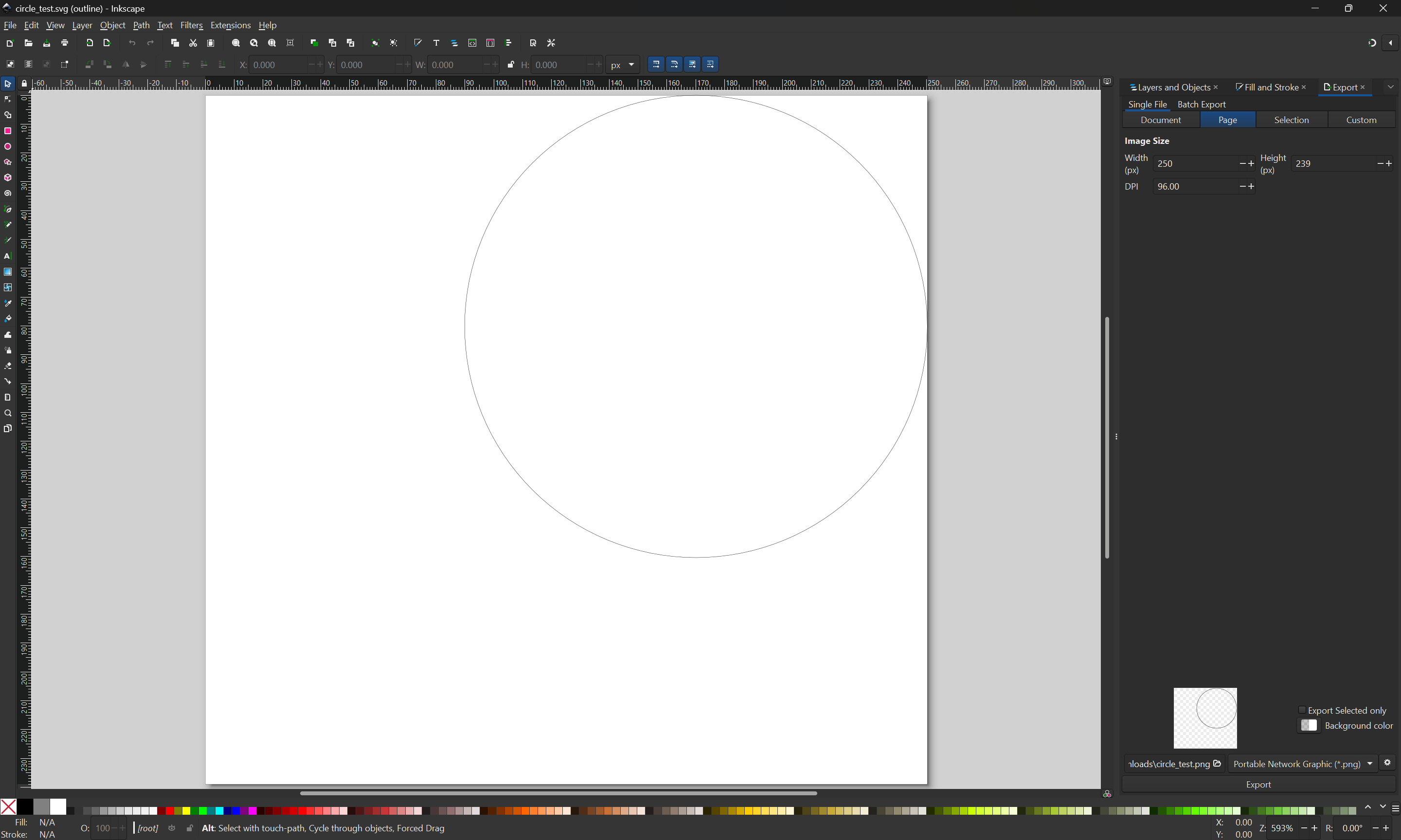

You could check it in Inkscape
I think this is an issue with CC, not Affinity.
I don’t currently have Inkscape but I have Graphic. When I export an SVG rectangle from there I get the same problem, snug on the Y but displaced on the X. Good idea though, verifying with another app.

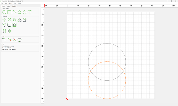

The specific behaviours being seen are:
  • some programs care about/show stroke width and include that in dimensions/positioning — others do not — Carbide Create does not
  • Carbide Create offsets from the page edge for left–right, but positions the bottom-most object at the Y zero coordinate

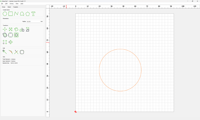

You can see/test this by making an SVG file which has a single object:
(in this case we will export this to an SVG file)
Opening the SVG in a 3rd party tool confirms that it is displace above and to the right of the lower left corner (which Carbide Create uses as origin):
If we then import this file:
We see that the left–right positioning is maintained, but the top–bottom is discarded so that the object has its origin along Y at 0.
The most straight-forward way to address this is to ensure that the lowest object along the Y-axis has its origin at Y 0 and that it has zero stroke assigned to it (if using a program which includes the stroke in the dimensions/positioning information) and the most straight-forward way to do that is to include a filled (but not stroked) object as a background.
