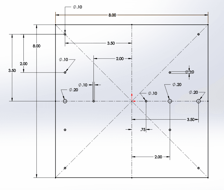

Does anyone know the dimensions of the table’s hole locations such that I can create custom fixtures that bolt into them?
As far as I can derive from measuring the table, the dimensions are as depicted in the attached photo.
Can anyone confirm that this is correct?
I don’t have the CAD in front of me but from memory those are close. The one thing to note is that the table is not exactly 8". We have them cut by our metal vendor but we do not profile the edge. Any dimensions should be from one hole to another, which is a dimension we control, but not from the edge, which can vary from lot to lot.
Rob

So I’ve sketched up what I think to be the location of the pins and threaded holes in the nomad table based off of centers. The 0.10 holes are just markers for the threaded holes.
- Can anyone confirm that this is correct?
- What is the diameter of the pinned hole?
- Can a pin be removed and used to locate stock?
It would be great if Carbide 3D would provide the CAD files for the bed. I’d love to custom make mine.
Just to close the loop here, the file is at Replacing the Nomad bed
