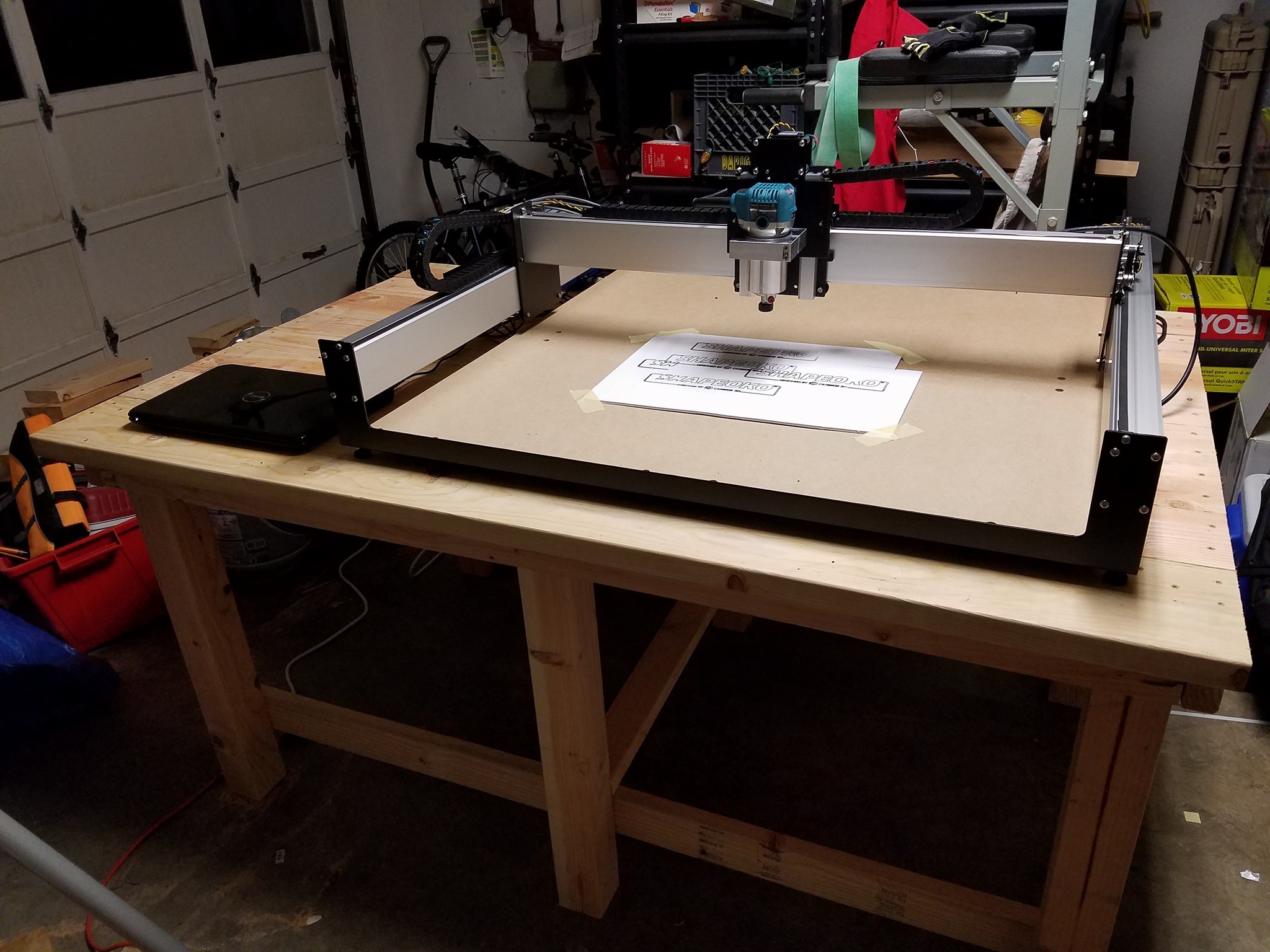

What are you using for a base for your S03?

I may be guilty of over-building again. Just got my top made tonight, using what I had laying around the shop. It will definitely be a monster when done. Shapeoko should be here tomorrow so need to get the base done!
You really don’t realize how big this thing can be until you see the base…
Ain’t no such thing as over-building. Precision has to start somewhere, and CNC is an excellent example of the “Wonderful One Hoss Shay” problem where the thing is only as good as the weakest part.
Built a big table for mine.
Chad, doesn’t it move around when operating? Do you lower it onto a surface and clamp it down?

I have a 4’x4’ table with casters. i am going to remake the top and make a torsion box. The center of my XXL sags a few thousands and I will make the new top and shim as necessary. I have the luxury of a large roll up door and can take my Shapeoko outside when the weather is good under a covered patio. Even with dust control the CNC Router is messy. If you do not have the luxury of taking it outside get dust collection right away. I have a Jet 1.5 HP Dust Collector but a shop vac with a cyclone separator will work. If you do not use a cyclone separator your dust filter will clog quickly. It is not static vacuum that removes the dust is is cubic feet per minute (CFM) of air flow that removes dust. A clogged filter reduces the CFM and reduces your dust removal.
I went with the Dewalt Table saw stand. Perfect fit for S3 and sturdy.
I used the Kreg frame work for mine.
Would you believe an old dinner table with legs cut down, and added support underneath assuming it would hold a tank of water, originally for use in my greenhouse. It has been recycled since it was available for my CNC workbench. I recently bought a couple ea of 2 drawer and 5 drawer file cabinets for my shop and the two 2 drawers went in under the table, fit perfect, and raised the table about 3 inches (much better to work on now). The table is still solid.
