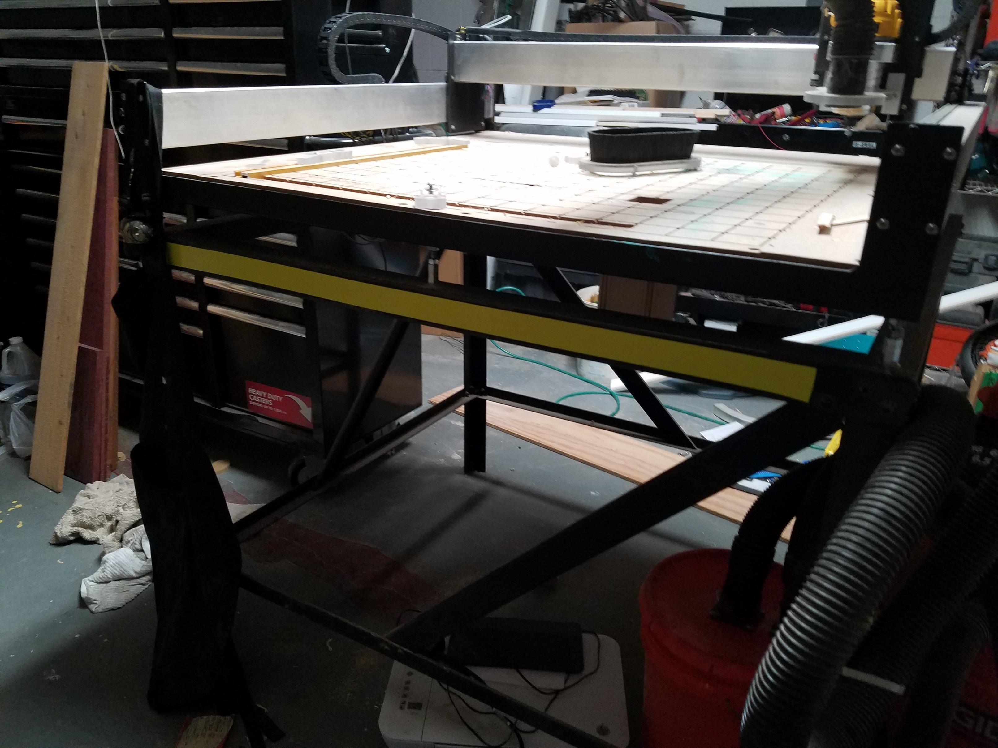

I built my XXL table with a very similar system. Made the top 48" x 48" out 3/4"plywood. It is solid as a rock!!!
2x2 angle iron with adjuster bolts for securing and leveling.

This looks extremely rigid. Do you have any support in the center area of your wasteboard?
I have another piece of angle iron with the same adjuster set up. unfortunately I added it as an after thought and my double thick waste board “Sagged” ooo so slightly. Not a big deal, I have an 1 1/4" fly cutter that I level the waste board with. Ray
Thanks, Ray… so you added another adjuster/angle-iron section it sounds like… XXL’s have natural sag, so I am just wondering where it was added and what effect it had on your overall machine leveling? This notion of trussing the wasteboard frame vs. tramming the wasteboard is yet another exercise on my long list of TO-DO’s for my Shapeoko.
What I desire to avoid is a pocketed primary wasteboard/base surface, as I want to mill “larger-than-my-cutting-area-stock”, and pocketing seems to be counterproductive to that notion.

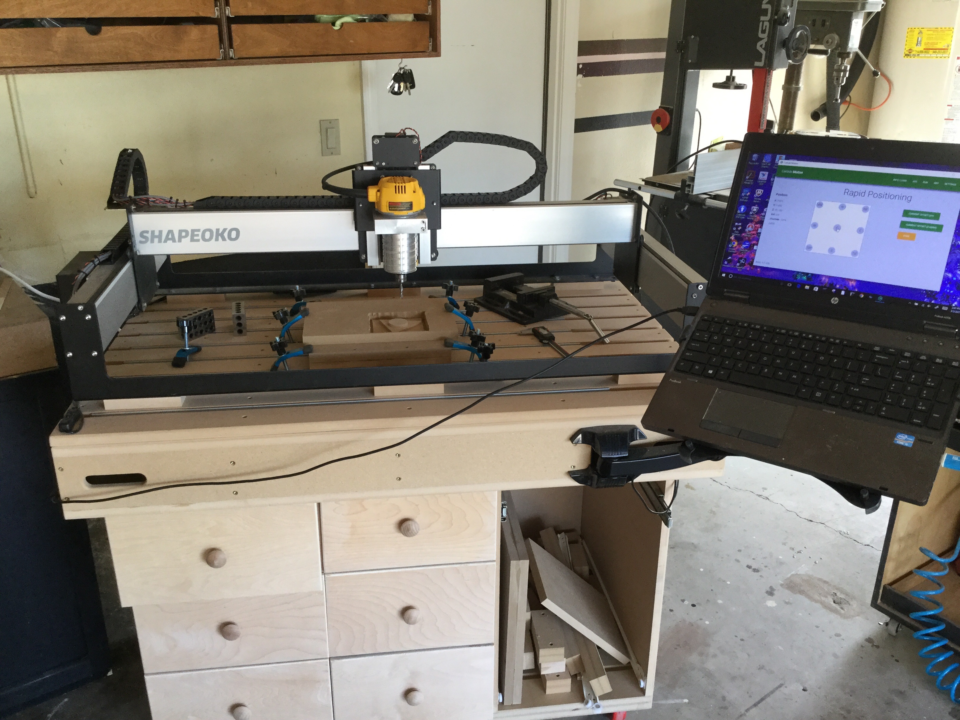

After a year or so with a SO3 with a sea of holes wasteboard I started running into various limits.
So, I got the XL upgrade kit and built a torsion box. Then a rolling cabinet to put it on. It’s still a work in progress but I’m real happy with the increased y axis clearance and multiple work holding options.

Very nice work Kevin, I’m envious.

Nice work on the cabinet Griff. Love the laptop holder. Also the Laguna in the background looks very nice.
Thanks Kevin. I received my 10’ USB cable yesterday so that problem is solved. An enclosure is next on my list. Just have to manufacture the time.
