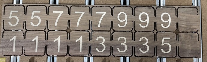

The numbers are .45” walnut with maple inlay. That was a double sided carve. I put even numbers on one side and odd on the other. Needed 3 of most numbers and 4 of the 1 and 2. I cut 2 blank ones just in case I messed some up but it all worked out. They were on a single board and each side inlay was on a board.
After gluing and running through the bandsaw and drum sander:
And then finally cutting them out:
