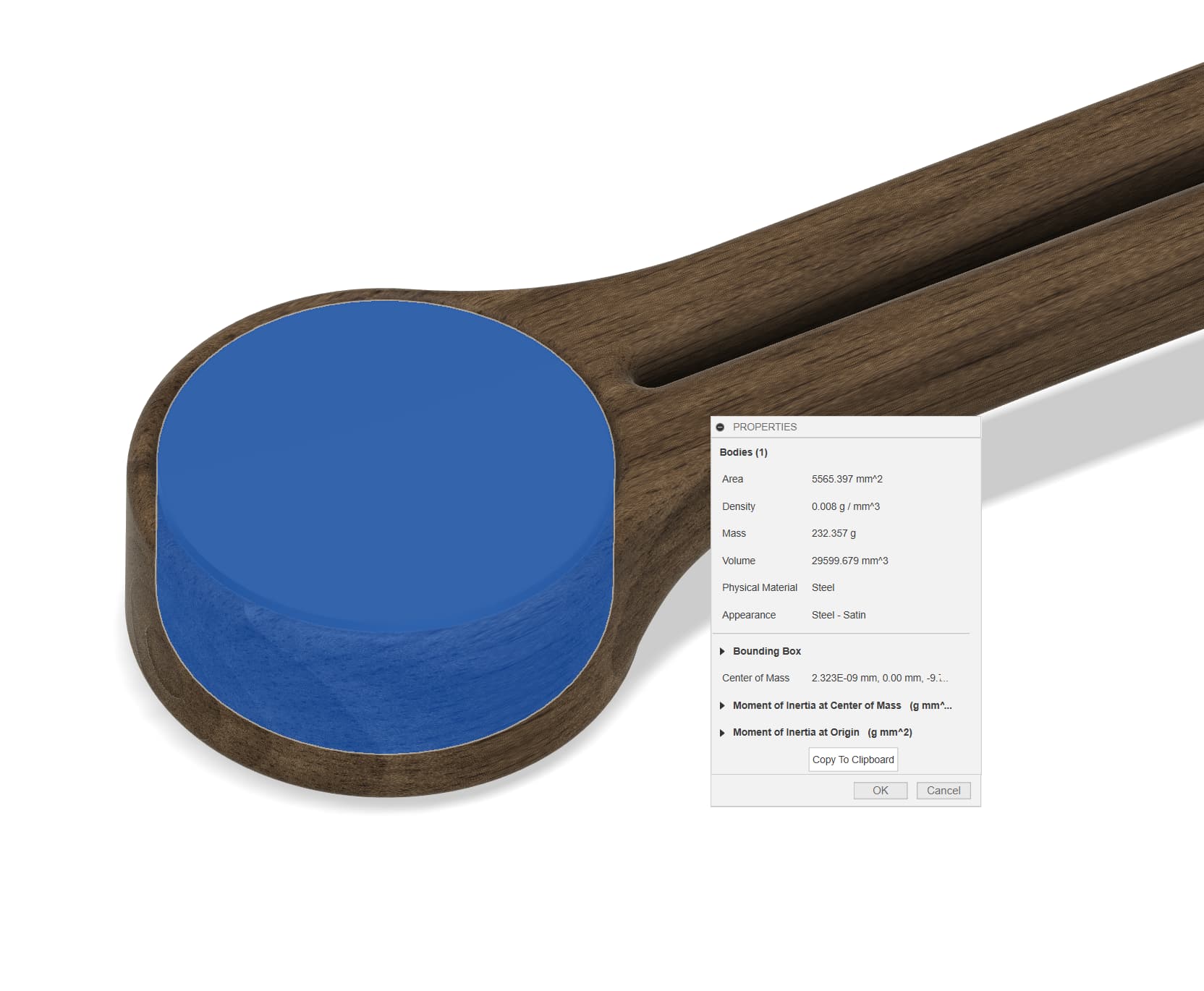

Prototype of a “Coffee Scoop n’ Clip”, seen these around and thought I need one of these and maybe something to add to the list when I go to the markets.
Edit: here’s the Coffee Scoop n’ Clip 3d model (.stl)
Scoop Main Body.stl (588.6 KB)

How did you determine/calculate the volume of the scoop?
So coffee scoops are 2 tablespoons which converts to 29600mm^3 and I wanted the scoop to fit in 1" thick stock. So used some math to calculate the diameter of a cylinder with a specific height (space remaining inside the scoop area). I also use Fusion 360 for my CAD/CAM and when you select “properties” on a body it gives you the volume of the object. So with the “combine” tool (boolean operation) I created a body that represented the volume in the scoop. Also took into consideration the fillet in the bottom of the scoop so once that feature was added used math to determine the extra height I needed to extend the inside of the scoop.
