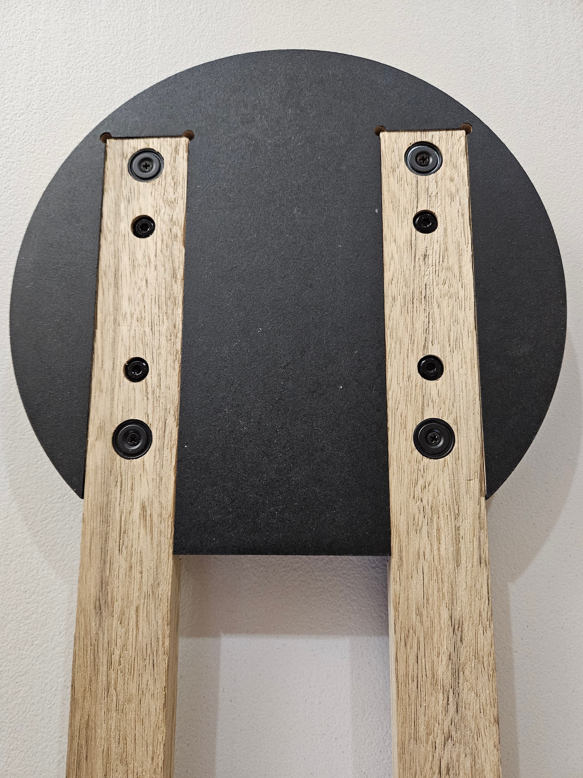

Tyler was close… It’s 11"x11".

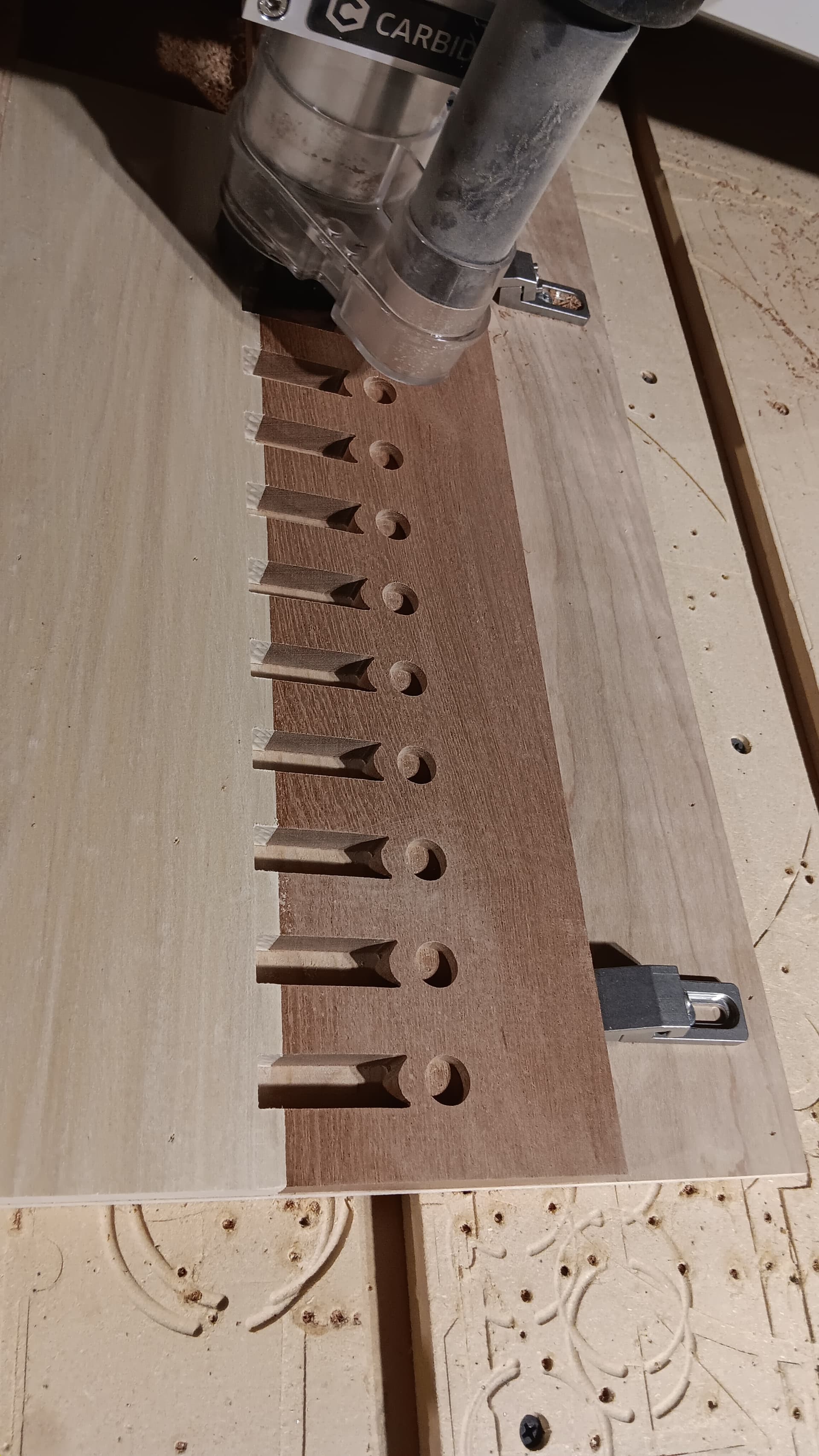

Trying to replicate some moldings.
Looks like you’ve either NAILED IT…or getting really close! Good job
Does the “new finish” look remain or will you attempt any ageing process? Just curious, no opinion either way, just wondering what final finish will be.
Gotcha,
“NAILED IT” - LOL!

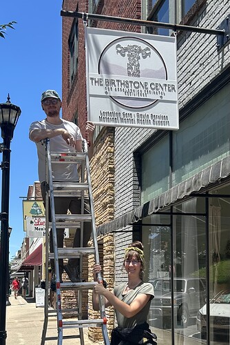

The final finish will be paint. The material is Sapele for weather resistance. A total of 60 linear feet is required.
It’s good to have a daughter and son-in-law to hang our signs…I hate doing it!!

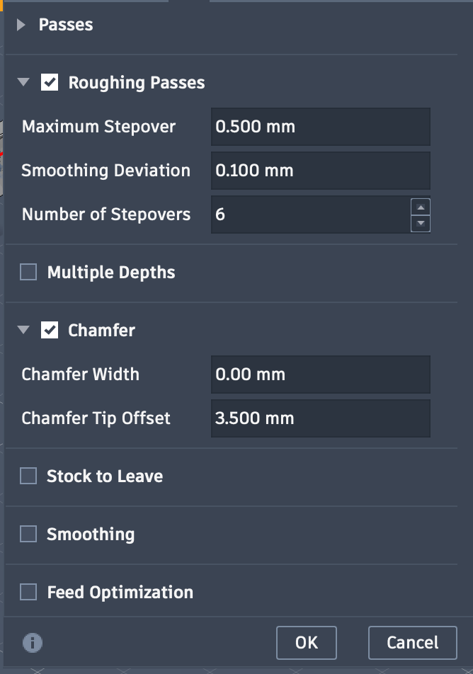

What tool did you use for the chamfer? Can you share speeds and feeds as well?
Thanks
Hey, that’s been a while :wink:
The chamfer cutter I use most, and used there is this one from Trend
It’s meant for wood but I’ve found it to be fine in Aluminium, brass and plastics too.
Here’s the cutter settings from Fusion, the finishing stepover was 0.25mm, on Aluminium I use either WD40 or Isopropanol as a lubricant to keep the cutter clean and the surface finish looking good.

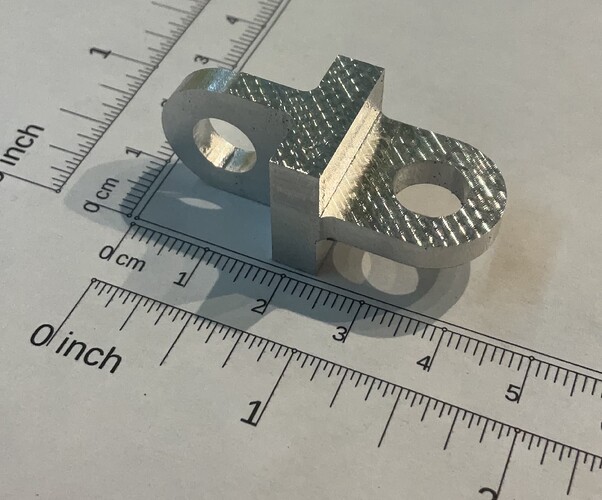

(Inadvertently) decided to face my stainless steel C3D Gator Tooth clamps with MC Etcher.
Accidents happen…
That is the story of my life!
Now it’s even lower profile :ok_hand:
What’s the other workholding item in the photo? Looks like two rods with a non-marring end cap. I’ve never seen one that looks like that :slightly_smiling_face:
Haha yeah. I would’ve been happier if the grub screw wasn’t sticking up out of the rear clamp and detonated the blades on the McFly when it caught.
Back in the day, before OneFinity, the company sold SuckIt dust boots and these Oops clamps (3D printed components with metal rods) for the Shapeoko too. They still sell the products but don’t support other machines.

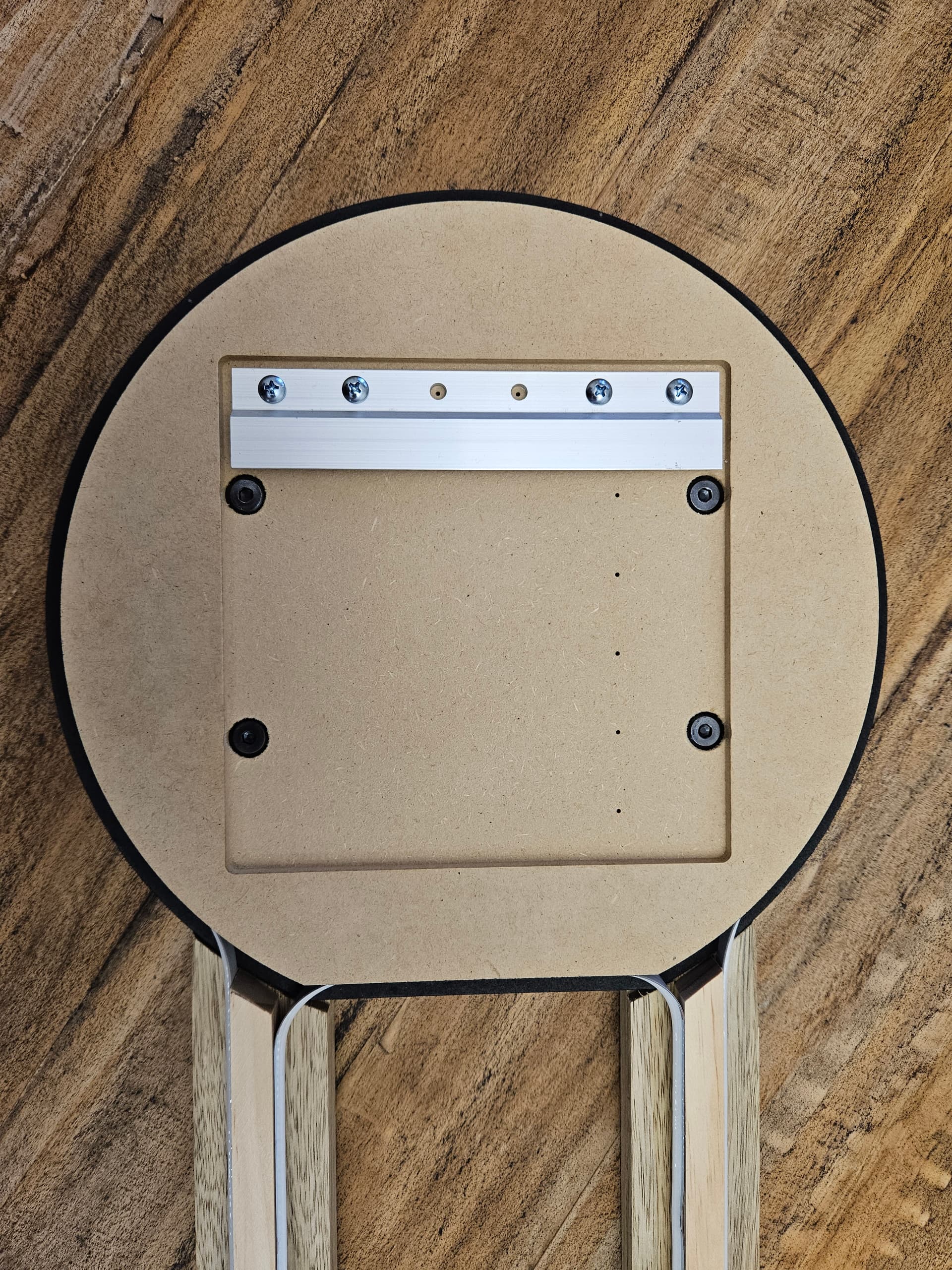

Latest project was a gift for my daughter - an LED-backed wall light. This was a lot of fun to design and make!
I wanted to be able to easily swap decorative end panels, so added magnets in a square to make it super simple.
