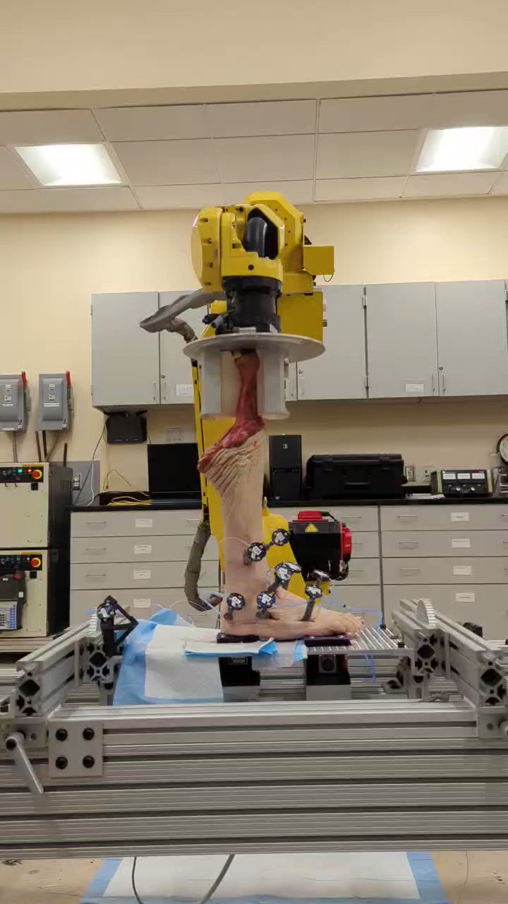

I cut the base plate and gear angle on my HDM. @SLCJedi cut the parts attached to the robot. I think on an HDM as well?
