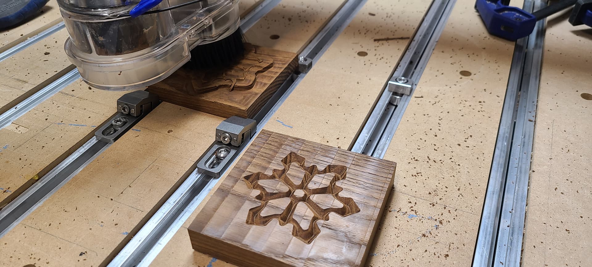

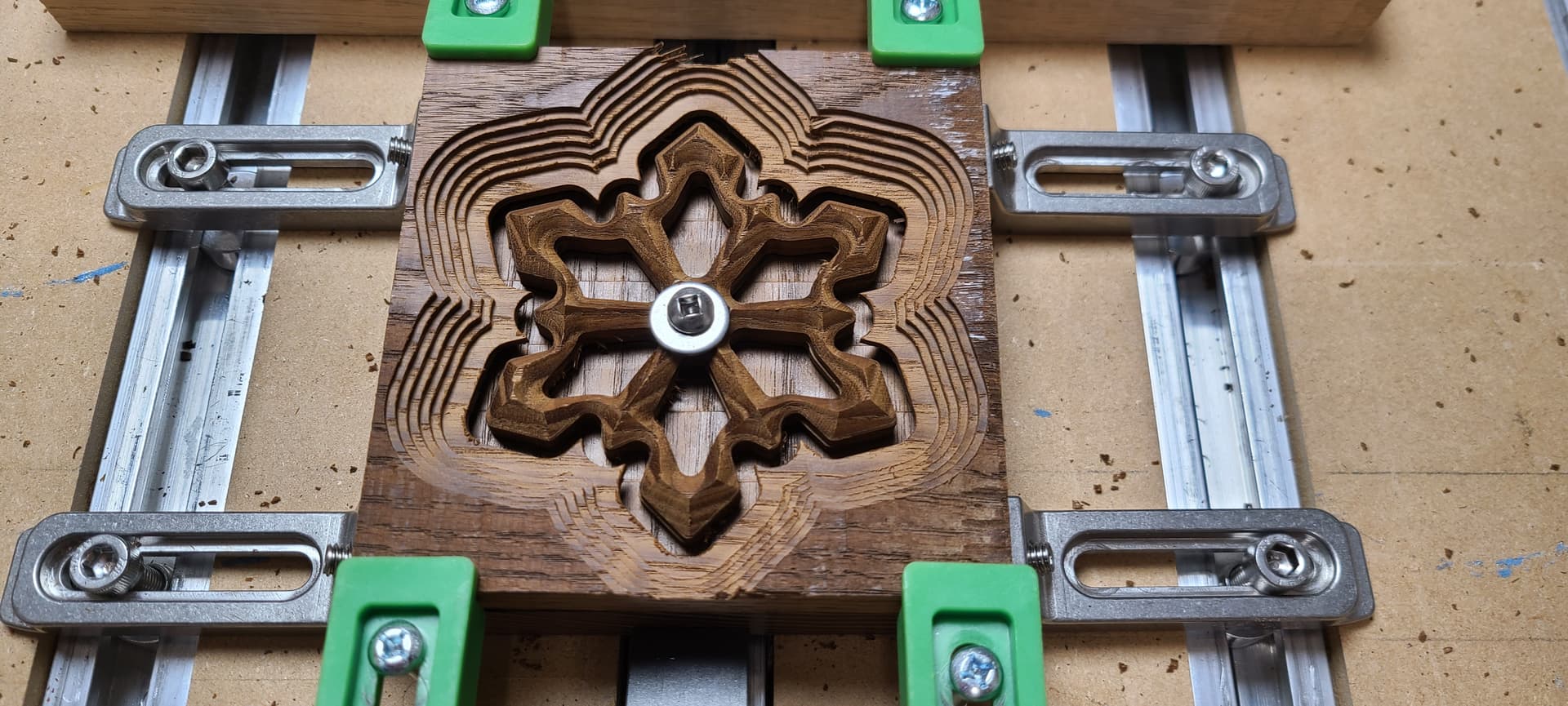

Making snowflake Christmas ornaments that require 2 sided milling. Started by making my flip jig which is the female engraving of the ornament to secure it after the first side is milled and ready to work the second side.
The first side in progress before doing the last toolpath, a 45 degree contour on side 1.
Before cutting the ornament free I started by milling out the inner detail to then be able to secure the snowflake with a screw/washer in the center.
End of running the job, lots of clamping but now it’s only the screw/washer holding it in place sitting snugly in the jig engraving below.
End result, I feel like it needs a little bling… Maybe some brass with the year (2022).
Patrick, I was wishing to see both sides of the ornament. One side fits into the female part of your jig when you cut the other side, but I lost (in my mind) which side you’re showing in the last photo. Is it because both sides are exactly the same? :smiley:
That is correct, both sides are identical so pretty much the same toolpaths run both sides, The intent of the jig was:
  1. Make sure the snowflake is squared with the machine when I flip it
  2. Zero off the Bottom-Left-Top corner of the jig to easily realign snowflake pattern even if flipping it.
  3. The first side when flipped downwards fits tight into the female engraving of the jig so it locks into place with the clamping
