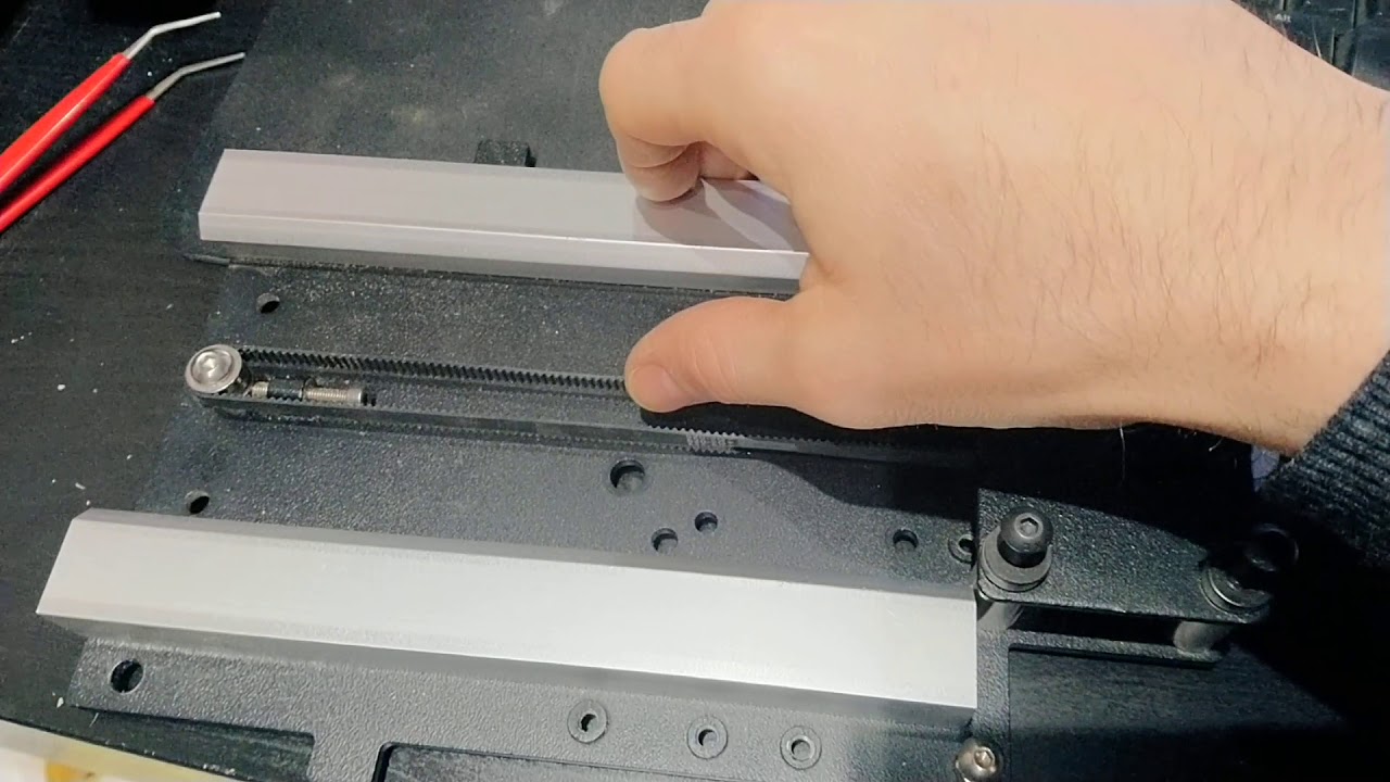

I would have, but I upgraded to an HDZ a long time ago. However, I pulled out my old Z from the box of spare parts, and setup a makeshift Z-belt assembly of something that feels/looks similar to how tight I used to have my Z-belt:

Thank you!! That is incredibly helpful.
