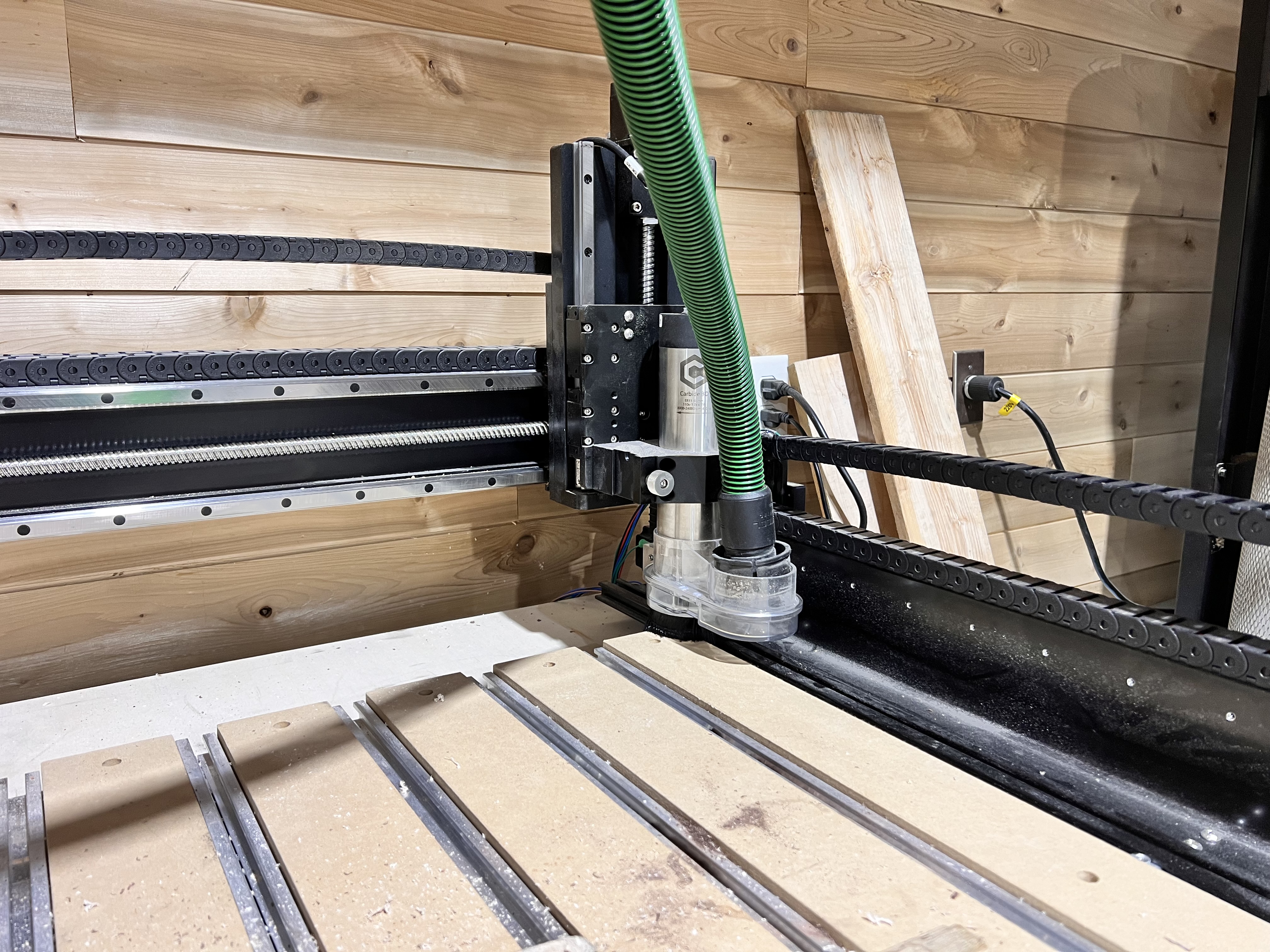

So I pressed stop today in the carbide motion software (pauze, stop - then red stip that asks if you want to park and turn machine off). CNC parked smoothly, no problems. However, when I turned the machine switch to “off”, my spindle dropped down to the bed… first time this happened. Do I just start it up again as normal?
Yes, the low friction of the HDZ ball-screw will sometimes allow the Z-axis to drop thus.
If this is a problem we have a gas-strut to address this:
I usually put a block of foam under my HDZ.
I have the 80mm. Should be already in there then?!
Check in with support — depending on when you placed your order the 80mm VFD may not have included the Gas Strut — not sure how that is handled.
Thanks will do this via email
Just bought the 65mm spindle. I think it would be good for Carbide to suggest this strut. I didn’t even know it existed until I ran across this thread.
the strut only comes into play usually (if you got a craazzzyyy perfect ballscrew and ballnut by chance you will experience it more often maybe) right after re-lubing the machine. The only time I usually go through it unless i bump the machine and i have a bunch of extra stuff on the Z axis, (chip shroud, sweepy, air blast, vacuum hose bracket in 3/4 ply, vac hose)
Long story short a strut is however much $$ but a small block of foam under the park position is like a dollar. The only real exception to this is if you experience frequent power outages or use cutters that cost more than the strut.
