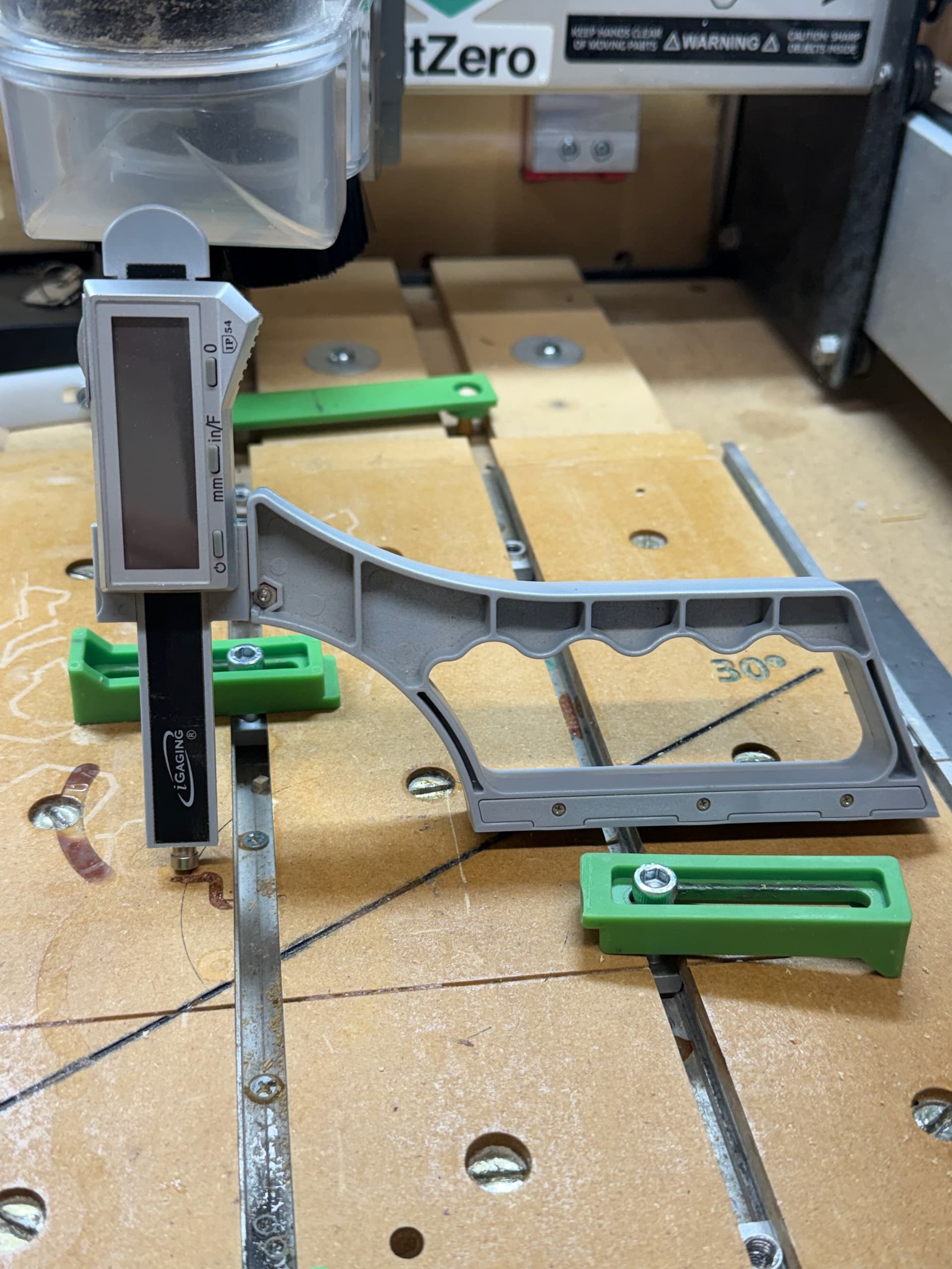

A scroll saw works really well for cutting tabs. Also, not mentioned so far is a height gauge for measuring stock thickness. I measure / verify stock thickness after clamping to the spoil board with a iGaging Height Gauge.
