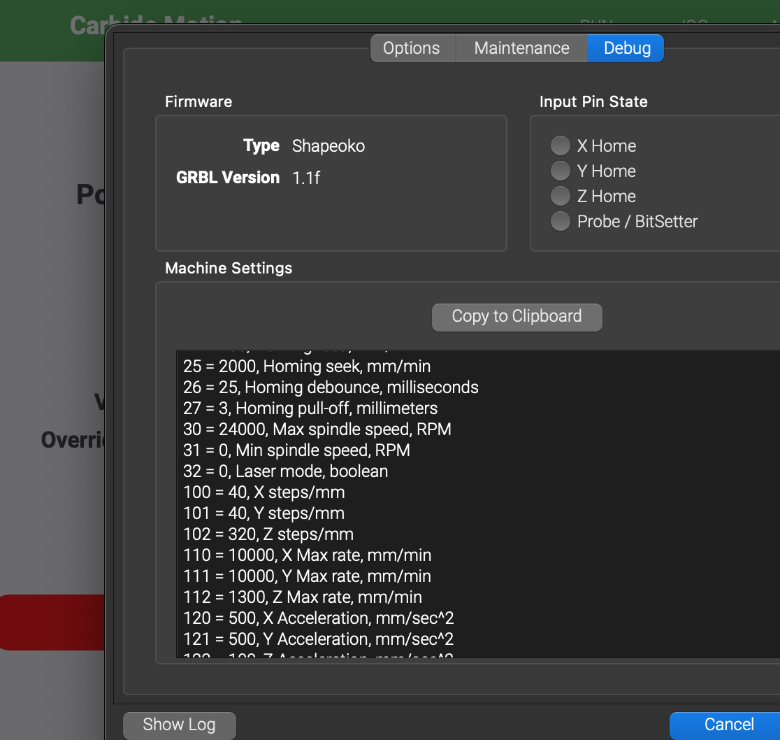

The Gcode differences seem trivial ( ignorance here). The one big question becomes the Z-Axis. Does anyone know if CM ignores the Z moves when the $32=1 and M4 is used ?
GRBL seems to support the Z axis movement.

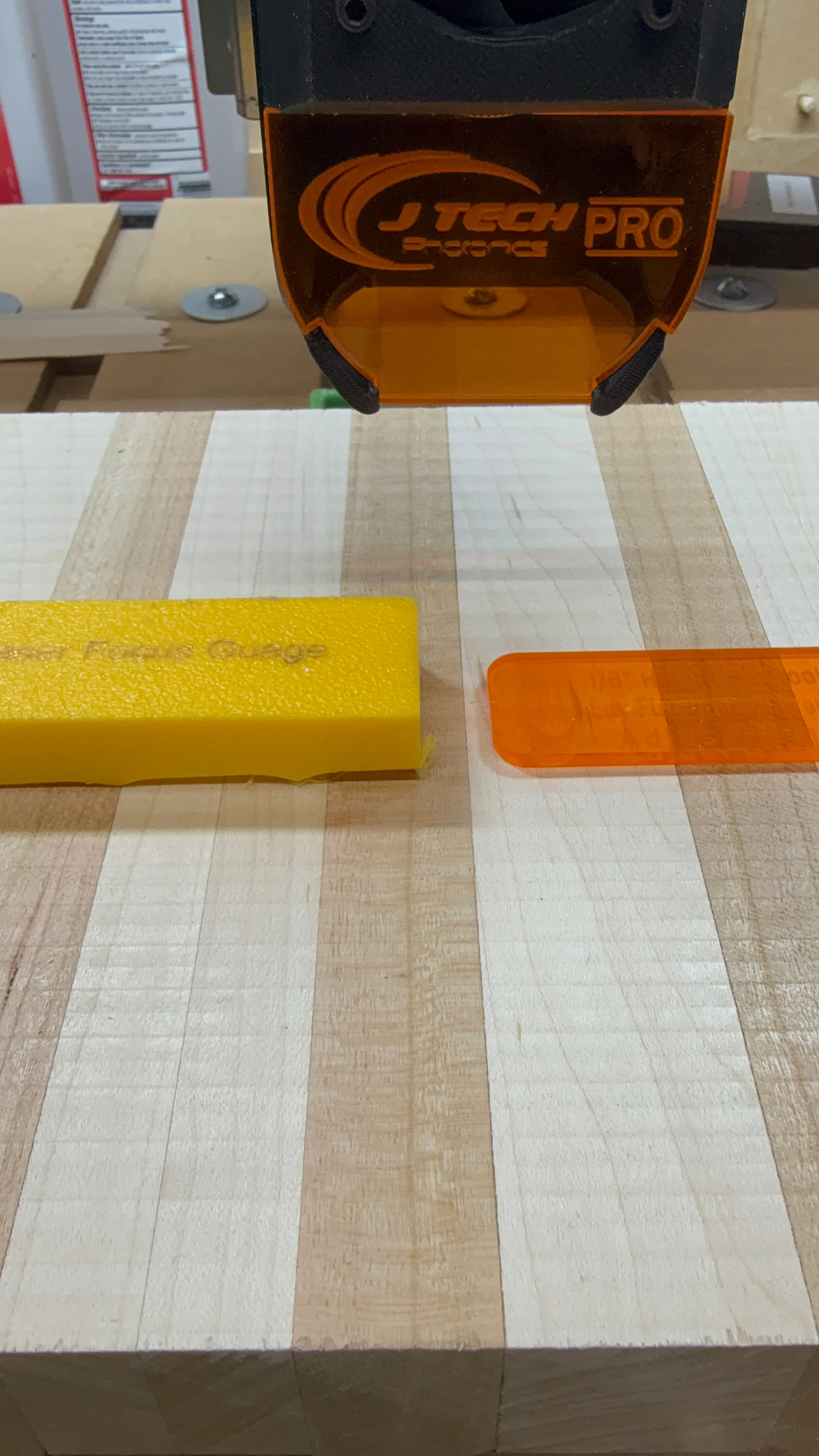

I’ve asked jtech about the focal distance of their lasers. I expect they would work but the chimney that goes down to the workpiece would likely need to be cut back for clearance.
Maybe it could be replaced with relatively long brushes to catch a good bit of the smoke :man_shrugging:
The question I’ve really got is regarding the focal distance (maybe the wrong vocab) of the laser and how it interacts with the total z height you’ve got to work with.
Happy Easter folks :wave:
I had a laser marking project some time back where I needed to burn an image into a pocketed area. I got with JTech about changing the focal distance so I could clear the walls of the pocket with the laser during the burn. No problem at all. I went from the standard 1/8" gap to 1/2" by refocusing the screw in lens.

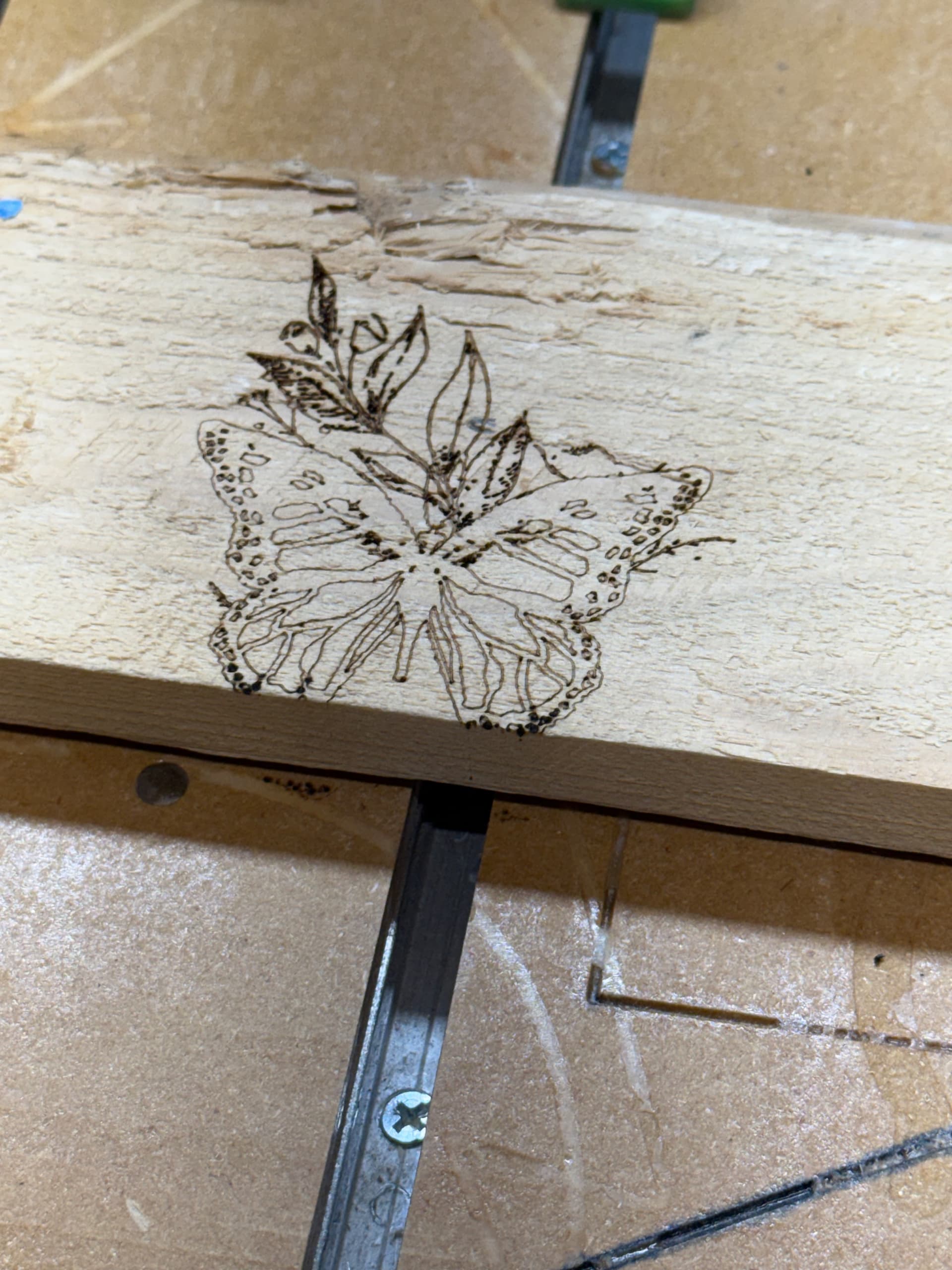

I had a little time to kill today and figured I’d try sending a .c2d from Carbide Create to Carbide Motion to drive a laser. It worked very well.
Lasering with Carbide Motion
Thanks for showing that ! The crickets were deafening !
That seems equivalent to setting a bits “length under collet” manually, which makes sense.
This is still a planar tool path, with an offset Z.
Have you tried a path the follows a changing Z path of some sort, with a fixed Z offset ?
EDIT: What app created the toolpath/code ?
EDIT 2: Never mind, you used CC. Time for this guy to go to sleep.
Did you use M3 or M4 ? Good night…
The toolpath was configured as one would do with a plain 2D object. I selected a MC Etcher, DOC = .001 and used a spindle speed to 8000 RPM. With a max spindle speed of 24000 rpm 8000 would give me roughly 33% laser power, (M3S8000). I just left my retract height alone for the test, it was set at only .050 anyway.
In Carbide Motion I sent $32=1 to put the Shapeoko controller in laser mode after setting zero’s. At that point I sent the .c2d to CM and unplugged the signal wire at the VFD from the Shapeoko.
I’m sure one could make the laser follow a contour tool path the same way one would set up a roughing and finishing path. The interesting part would be defining a single line to follow the elevation changes on a topo project.
