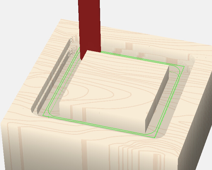

What would cause a pocket command to do all of one side
Hi guys, what would cause a pocket command to run all the way to the bottom of the cut and then go cut the other side all the way instead of switching both sides of the cut in turn?
If it’s a single region, it’s a bug (undocumented feature). Typically happens on narrower regions.
The only recourse I know of is to program each depth in a separate operation.
If it’s separate regions, again that’s just the way it works. It actually saves time by not bouncing back & forth between regions.
Can you post the file?
