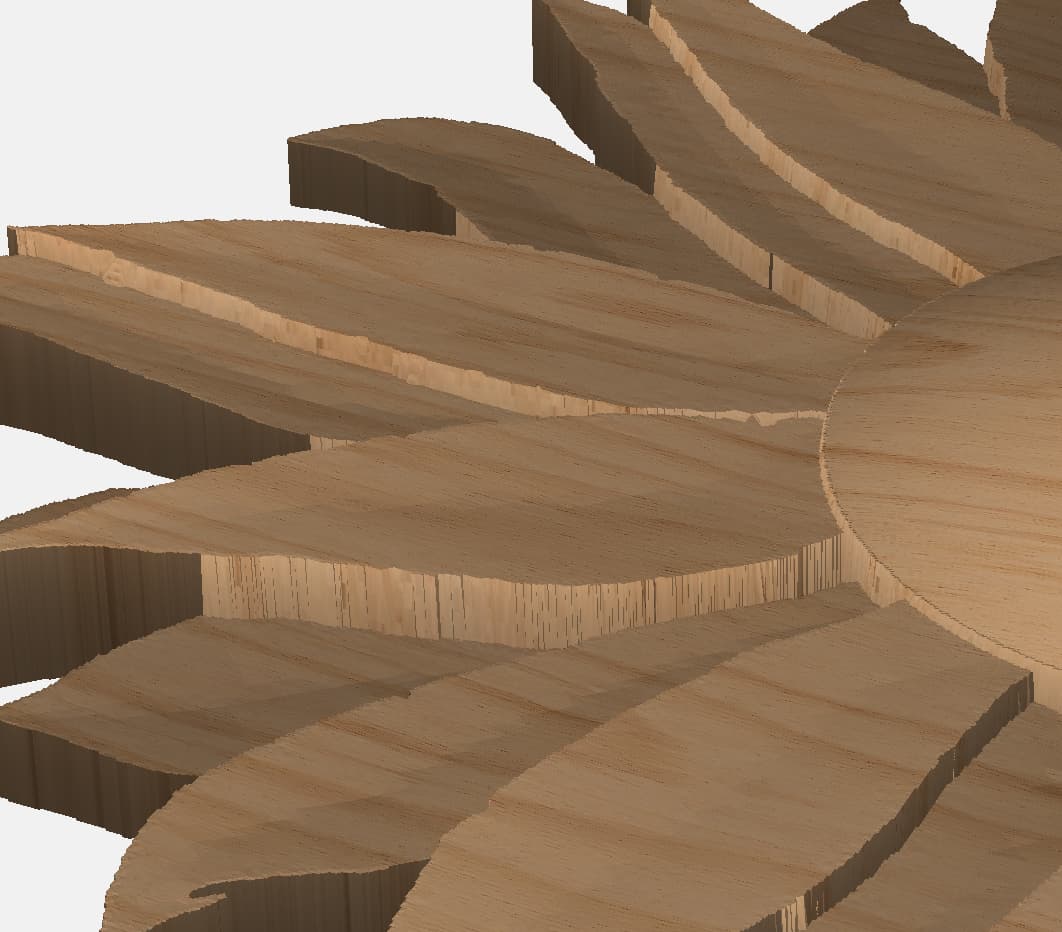

This is the sunflower from above.
Still needs v carve lines
There is a small arc on leaves from outside to inside. Plus leaves are cuffed
Used CC Pro

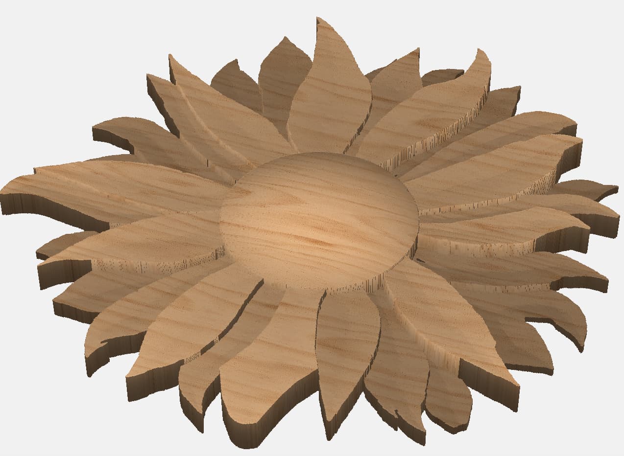

Josh this is a quick cut on to flowerish pot above.
Inside/top cut for 8 peddles. Needs outside/bottom cut. Like inside and outside of a bowl.
I would make two bowls, one a little larger then the first. then stack them. Would look nice.

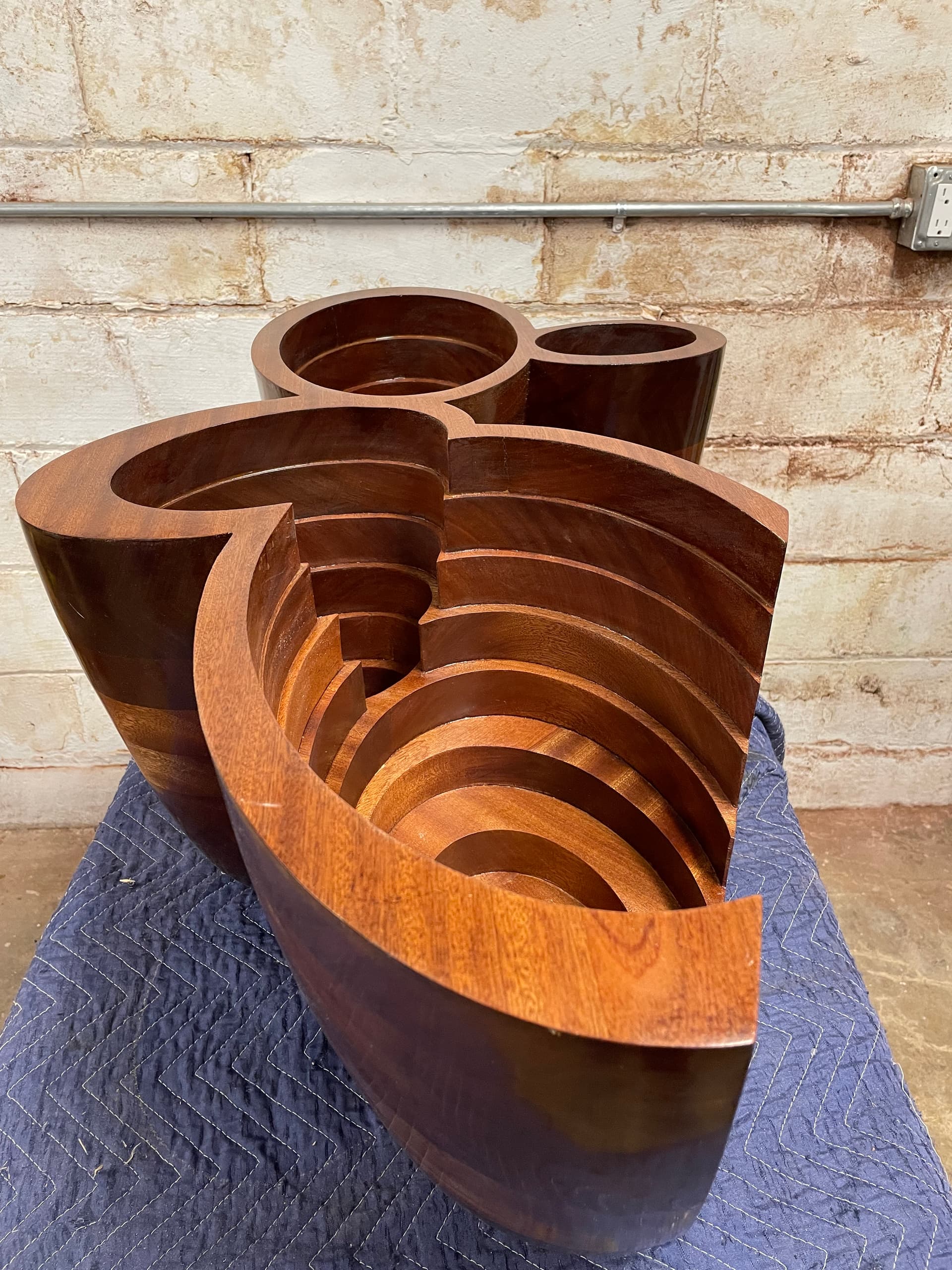

I just booked a job for next year…will be making these tables under glass. I plan to cut each layer upside down, with separate contours for each layer, and use modeling to get smooth outer profile. I’m guessing there’ll be a little math to calculate the position of each layer to make sure it lines up within sanding tolerances of the next layer.
I don’t know if there are any special functions needed…just how to know the size differential from the top to the bottom of the outer angles so that each layer can line up correctly. I’ll also need to be able to model a curved vector in which only one side is angled up…that might be a little tricky.

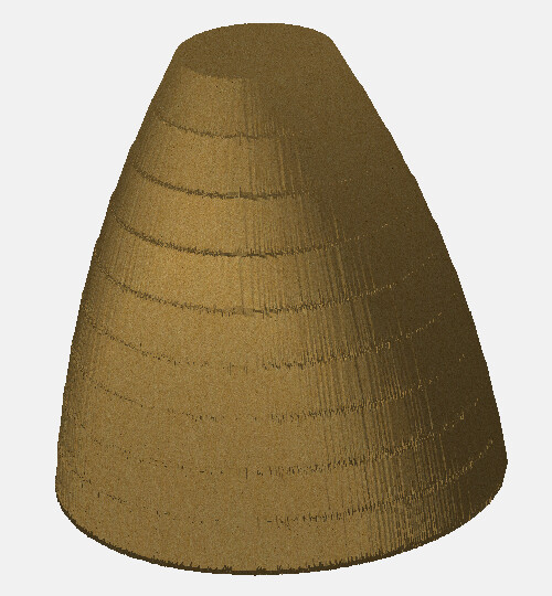

Playing around with 738 and how you would do that currently.
Came up with this by modeling it in NX and measuring the angles & diameters
But the best I could get the model was to use 2" tall limited angled components.
Tried with round, but it looked a lot worse.
I can sand the outside smooth. I think the challenge is going to be cutting curved components that have a cross-section that looks like this:
One side modeled, the other side flat - as it goes around a curve
OK…not too bad. I had to do a little playful finagling, but ;I’ve got enough technique to know I’ll get it.
I needed to create a false perimeter to get the angle to be one-sided.

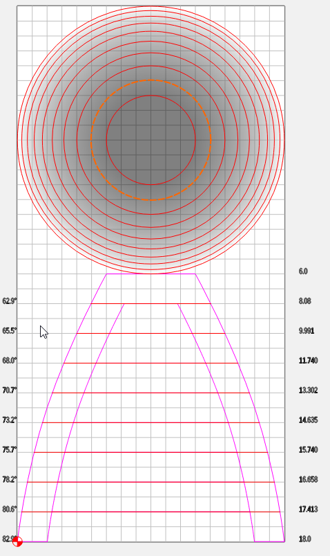

I would highly recommend drawing up a side / section view like I did above. Then you can just measure each layer to get dimensions. No guessing or trial&error.
Pro-Tip: You can run 2 instances of CC. Do your section view in one, and your workpieces in another. ![]()
