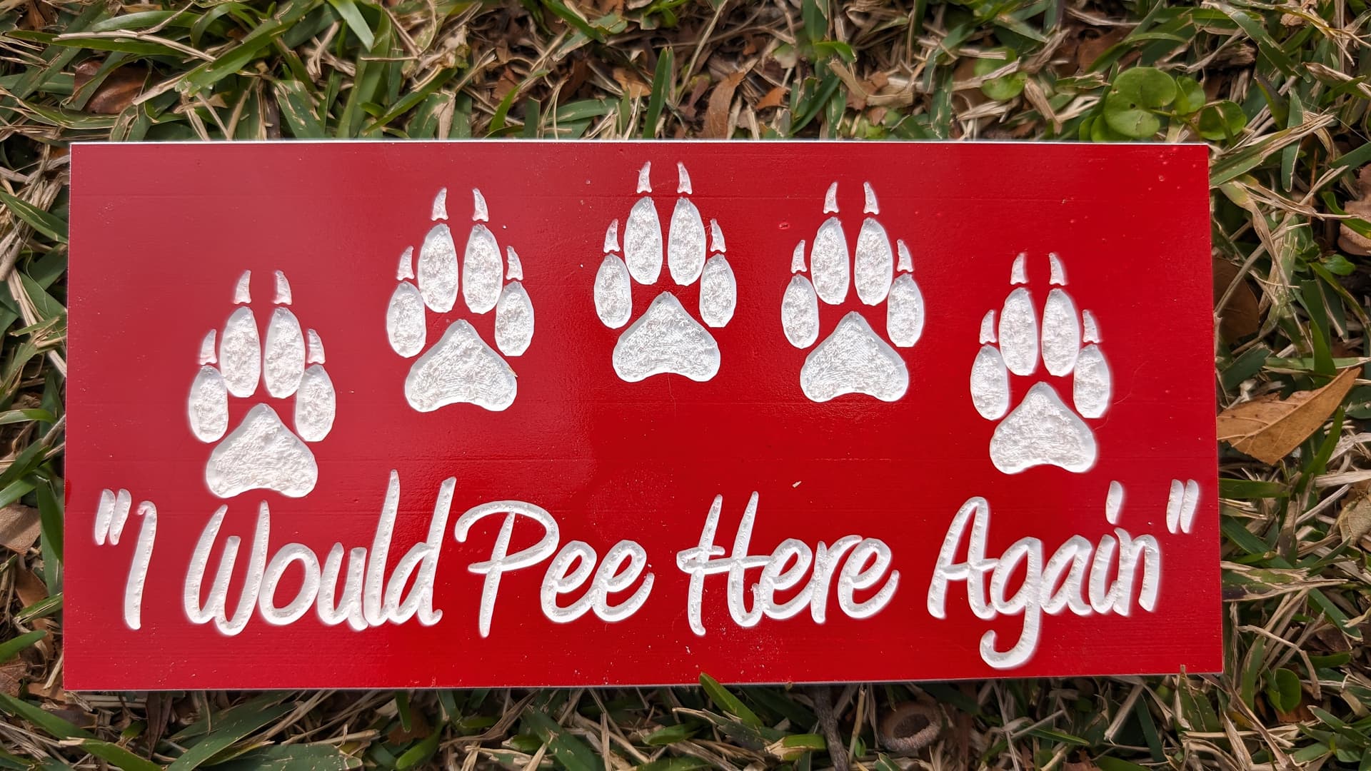

Expanded PVC cuts well with a vbit.
Expanded PVC 60 degree v bit. The krylon fusion paint should have cured 24 hours but it was just a test.
Using an O flute for the clearing in those large areas would really clean up the flats.
I rather like the textured appearance and feel it suits the informal nature of the sign well.
