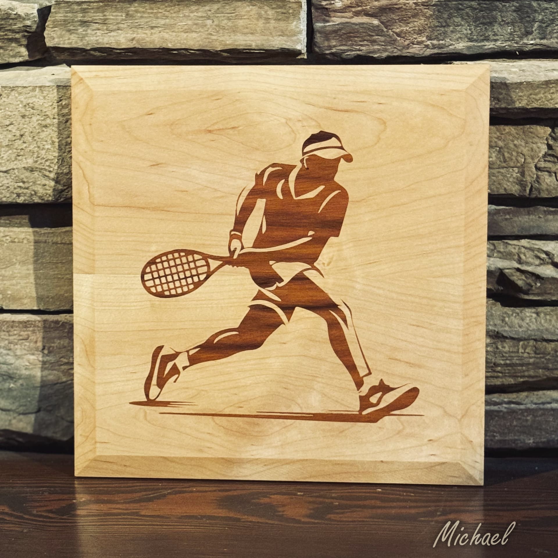

Project was 250mm x 250mm (~10"x10")
#251
Last pass DOC - 0.95mm
Feed - 1500mm, 18k RPM
Stepover - 2.5mm
Golden Boy - 1/4" x 1" Upcut Rougher
