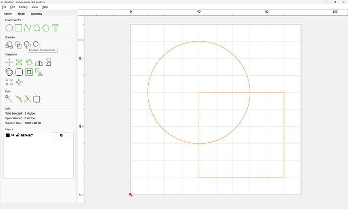

After you create several items and then select two or more the Booleans operation show up to use

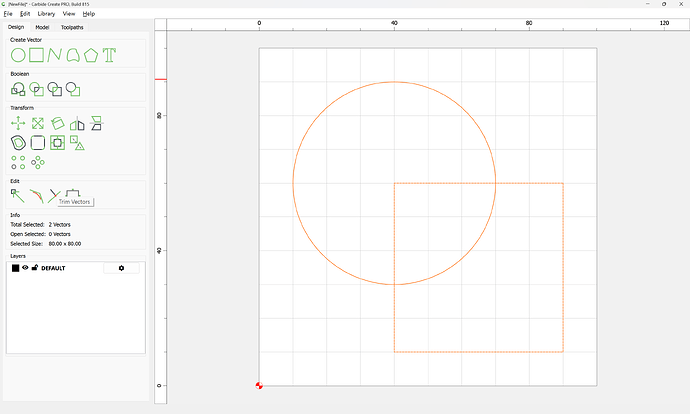

As noted, Boolean operations are contextual in that the UI for them only appears when two (or more) items are selected:

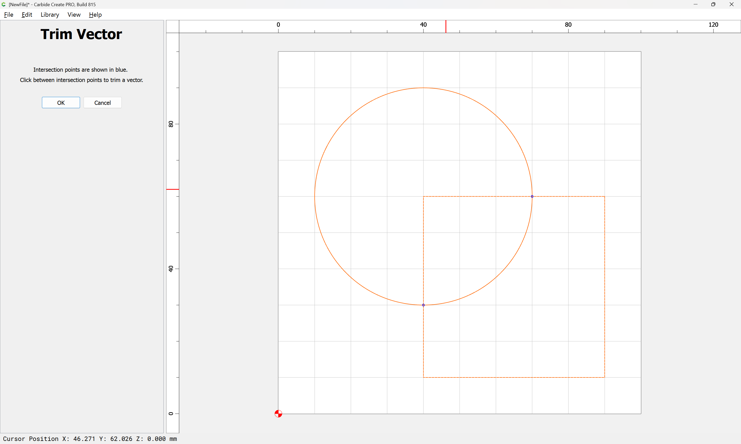

That said, it is often a better idea to use Trim Vectors which gives one direct control over what is removed and what is not:

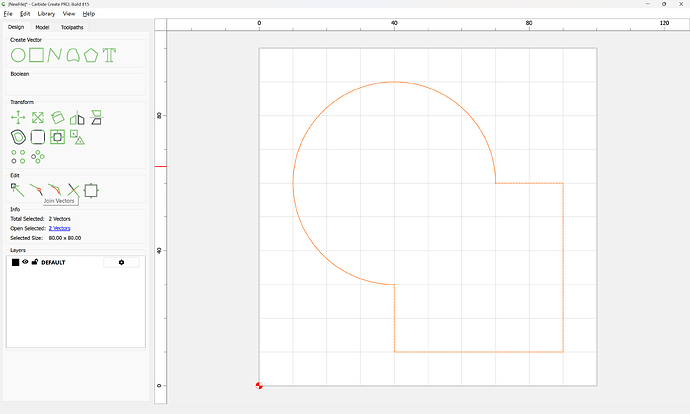

and then affords one the chance to join things together:
