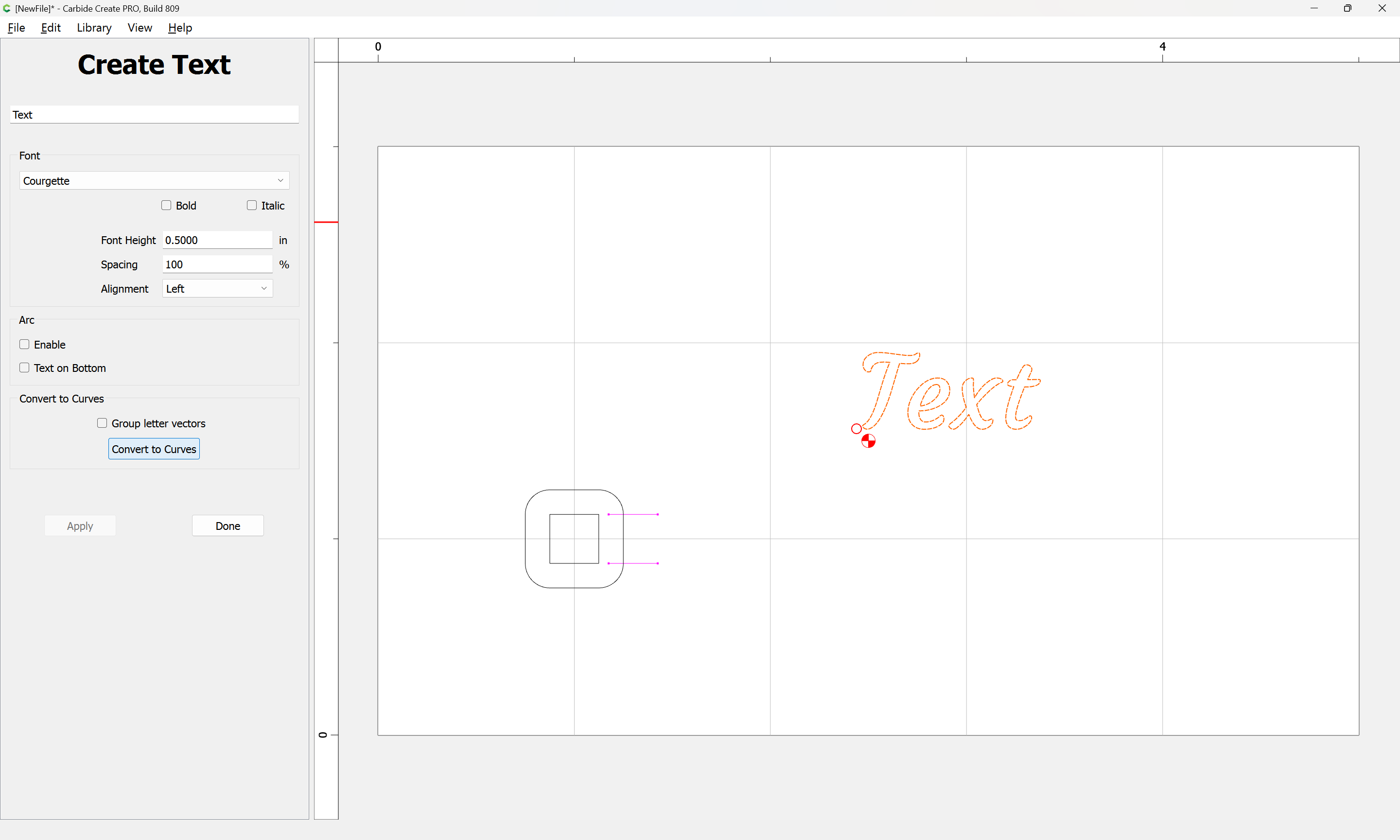

There are three sources for fonts in Carbide Create:
  • bundled with the program (apparently these were licensed — I think there’s a promotional font which includes some naming) — I don’t know if this has changed with various versions or no
  • currently installed on the operating system the application is running on EDIT: which the OS makes available to the app — as noted, it may be necessary to “Install for all users”
  • installed into the “fonts” folder in the Carbide Create folder accessed under the “About | Open Data Directory” folder
The best solution is to always duplicate text to a “Text” layer and to only assign toolpaths to copies of the text which has been put through the “Convert to Curves” button:

Note that fonts must be technically correct in order to work (not having a space character for example will preclude their being loaded).
If you have trouble with a specific font, please let us know the specifics of it, including a link to it (if it is freely available).
A further concern is that there is an upper limit on the number of fonts which may be accessed — removing unused fonts may make others accessible.
