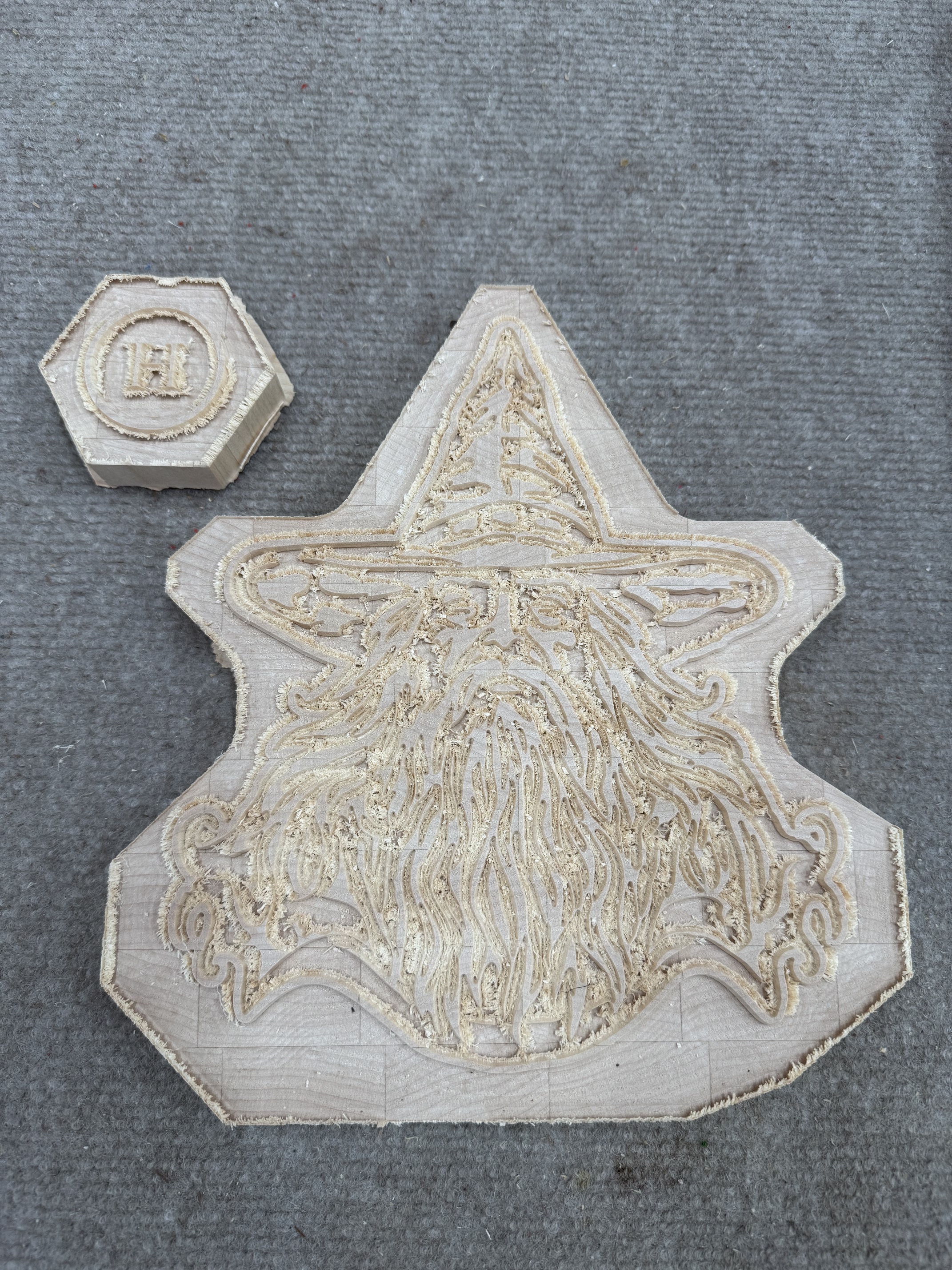

Hey Folks,

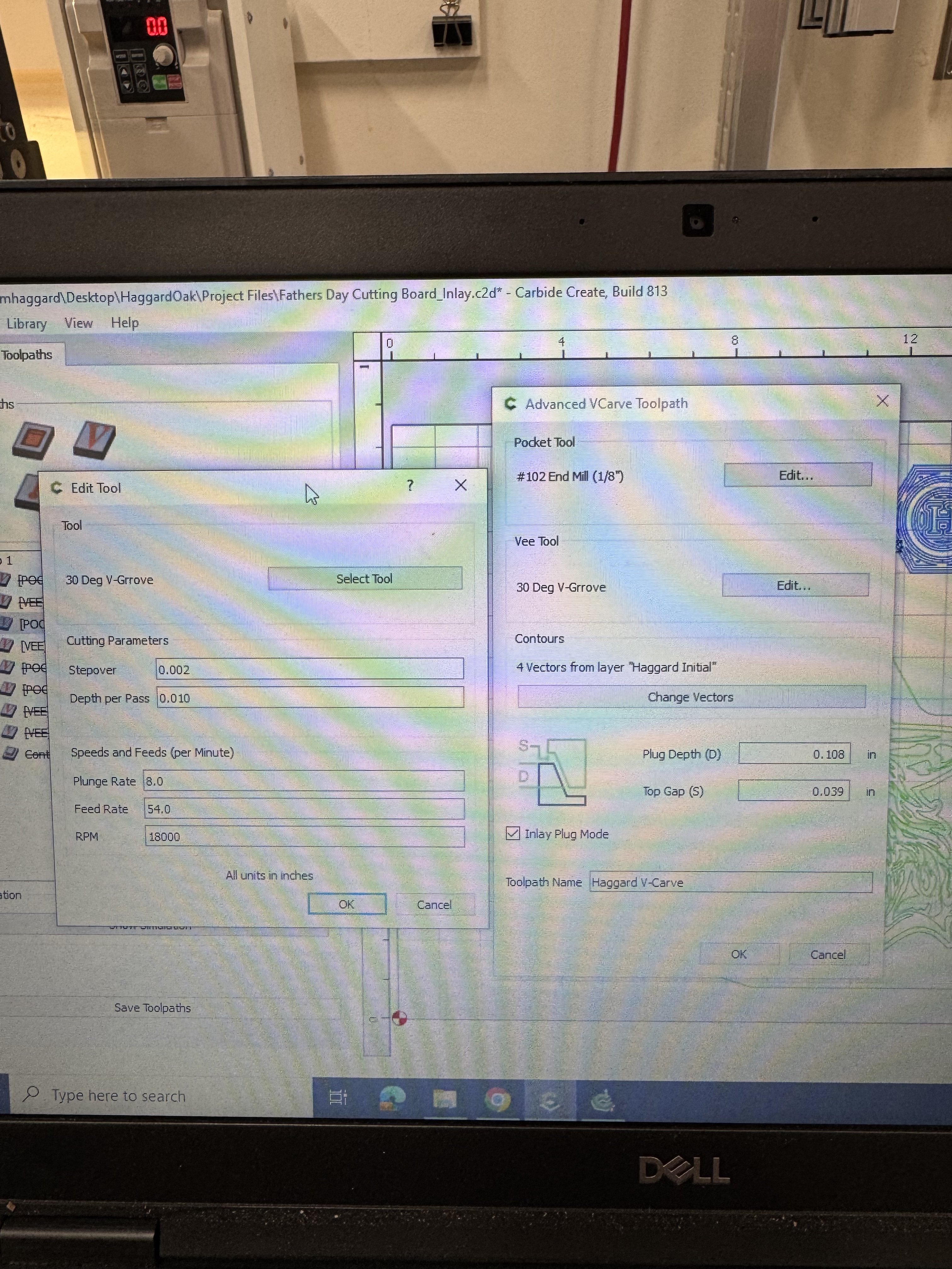

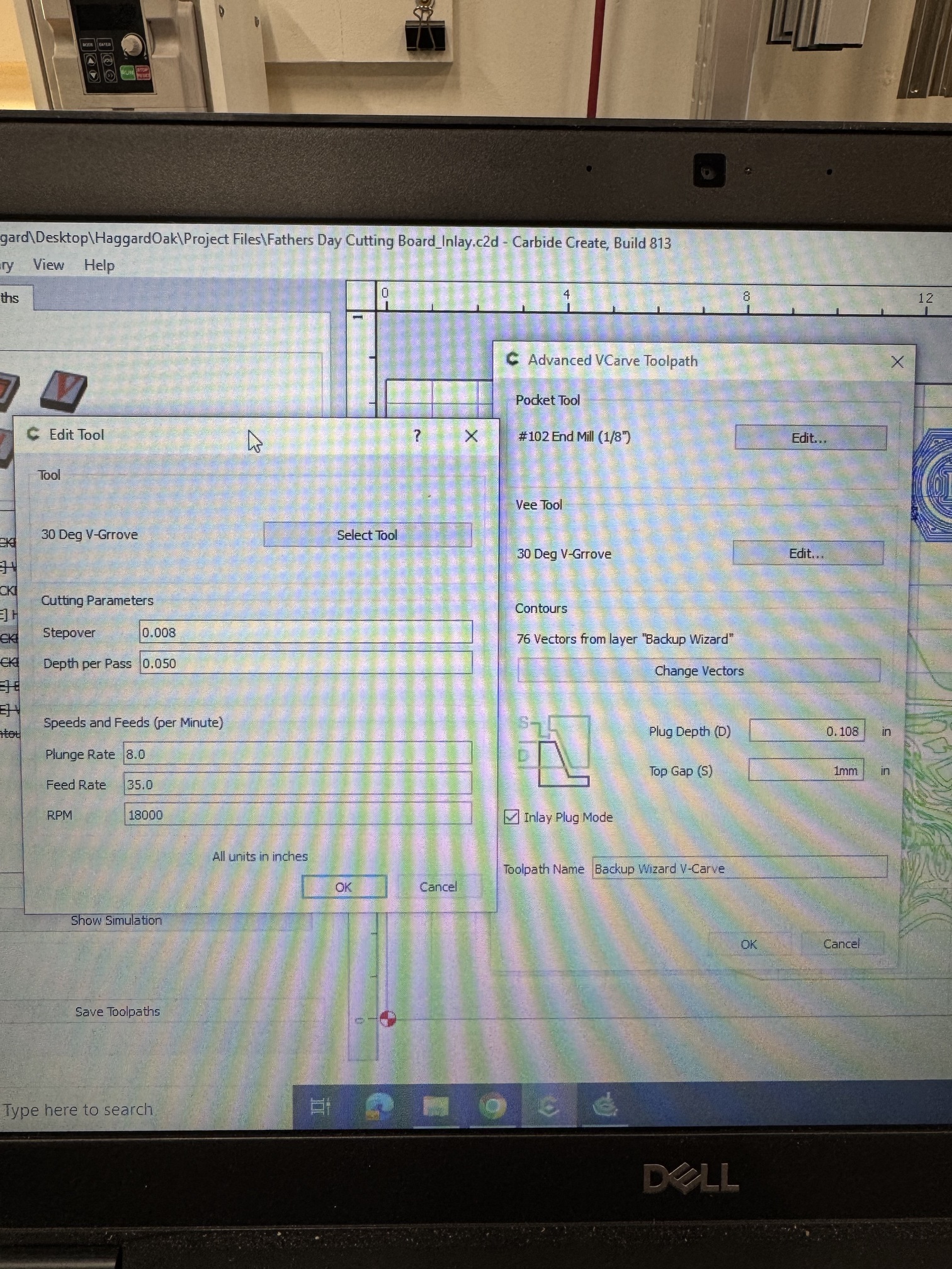

Need some help troubleshooting an issue with an inlay project. I’m getting some serious whiskers on my end grain maple plug. I’ve tried two v-carve depths and the shallower one (.108”) seemed to be worse in terms of ability to remove the whiskers. Some of them detach easily while others in the narrow crevices are not removing cleanly.
Im using a 30 deg v-bit (425-VG30) and started with some setting I found around the forums. A little more research pointed me to a smaller depth of cut and step over with an increased feed rate. No dice. Settings for both attempts attached.
Any advice would be greatly appreciated!

I just dupe the toolpath, disable the pocket part, then set the Depth per Pass to greater than the Max Depth.

So I tried the finishing pass today, and unfortunately it didn’t remove the fuzzies despite what appeared to be some extra cutting.
Think I’m going to try the program on some face grain to see if there’s a difference. I also might try a less detailed carve with the 60 deg v-bit to test the range.
