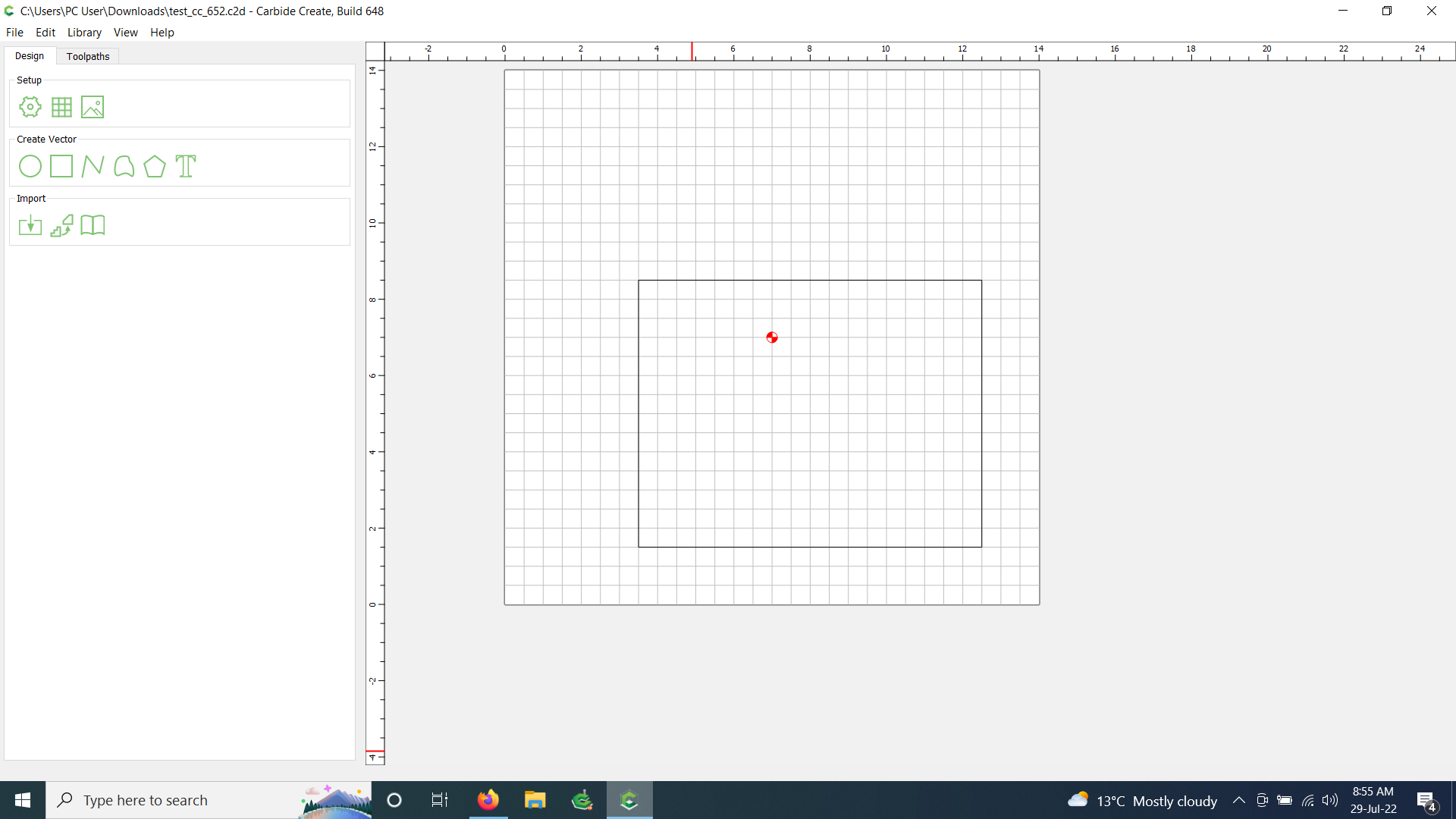

Why are my c2d files now saving without any data
I have been working on a project and trying different fonts. I can design the toolpath, view the simulation and generate the Gcode file. However when I try to save the design file it saves as 1Kb of data viewed in explorer and if I then close the file in CC and then try to reopen it the file is blank - no previous setting, no data, NADA. I then have to start again at design stage rather than just being able to open the old file, change the font and try it again
I am sure I am doing nothing different to saving previous files and at a loss to know what is happening
I am using CC 648 build (for the first time) and have used earlier builds in the past.
Probably no point in attaching the c2d file as it is blank :grimacing:

Guy,
Thanks for the quick reply. Your test had a pocket cut as attached. My test file actually had some text in it when I saved it but nothing shows when I open it although the .NC gcode file appears to have data and works when I run it on the SO3
Will,
I will send the .c2d and .nc files to support as you suggest. The c2d file shows correctly in CC and converts to gcode but when I save and reopen the c2d file this is what I get.
File extensions are correct when viewed in Explorer
SORTED!!!
The thumb drive I was using to save the file to was almost FULL…not enough room to save the file. I deleted a large file from the thumb drive and everything now working OK.
