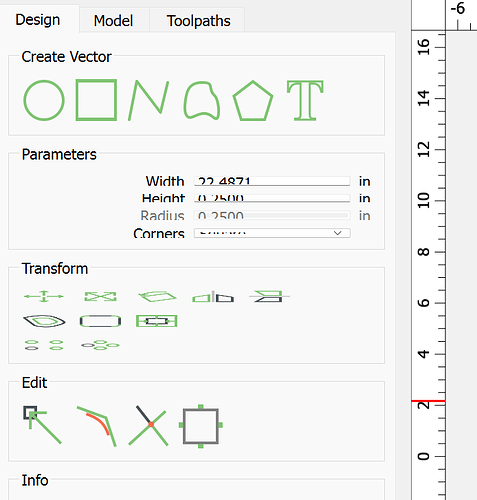

Why are they "scrunched"?
I keep getting some of the various parameter setting squeezed down to where they are hard to access/read. I’m using Win 11 on a 15" laptop but it does the same on my 17" laptop in the house.
The resoultion is set at 1920 x 1080. Sometimes to even get a “scroll” area in the parameter section, so I can get down to ok or cancel, I have to change from full screen to smaller and them back again to full screen for access.

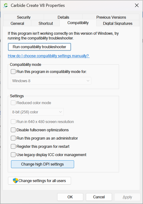

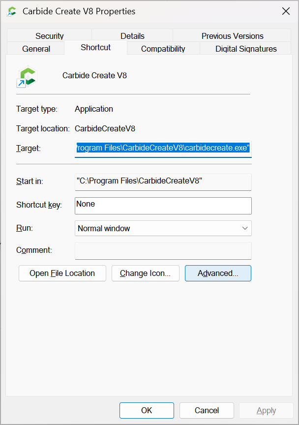

Also check the program properties by right-clicking on the icon and getting to the dialog:
go to the Compatibility tab:
and choose “Change high DPI settings”
and make sure nothing is set there which overrides the Windows setting.
EDIT: Conversely, if that doesn’t work, experiment with the settings here and see if you can get a better result — if so, post about it here and make a note of it for the future.

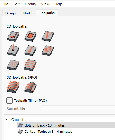

Here is how small the font and parameters show up now.
Just FYI

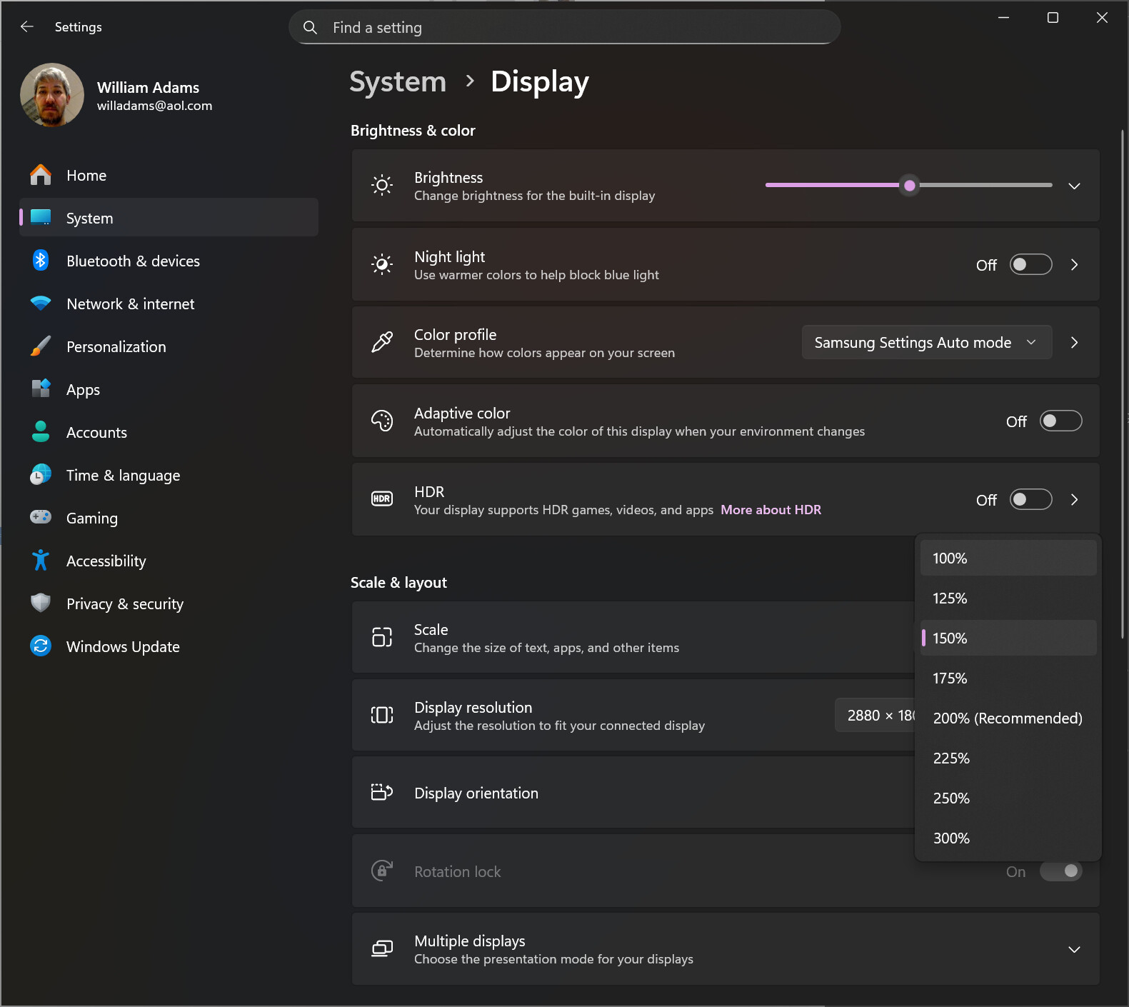

Like most things in life, it’s a tradeoff — my suggestion would be for a higher resolution and/or larger display (both if possible) — I posted screen grabs showing various settings for my Samsung Galaxy Book 3 Pro 360 at:
Appreciate the info. I am currently running at the 125% as a comprimize between size of display and not having to go back and forth as described above. Hopefully this may work for a while.

It may be associated with a “scrolling” code area in the program, as it seems that as an example, when specifically in the edit path window the scroll bar is not present unless you change from full window screen to partical and back…nothing else changes, but then the scroll bar will show up so that you cn get down to the ON or CANCLE.
