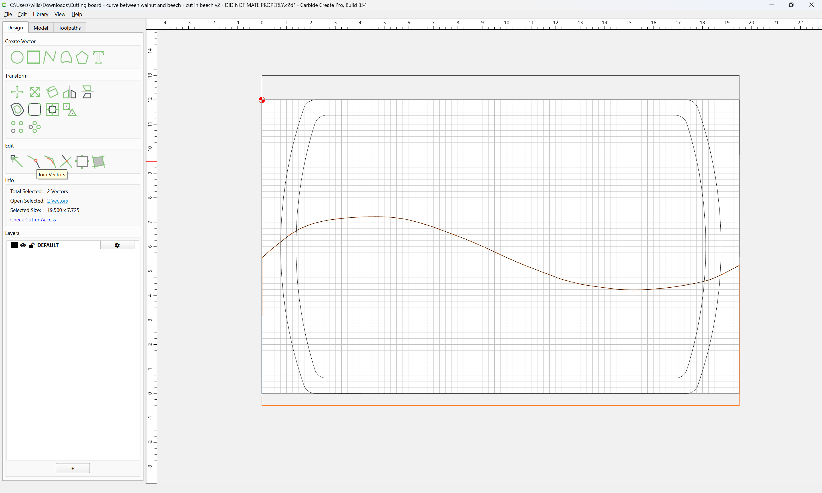

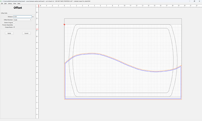

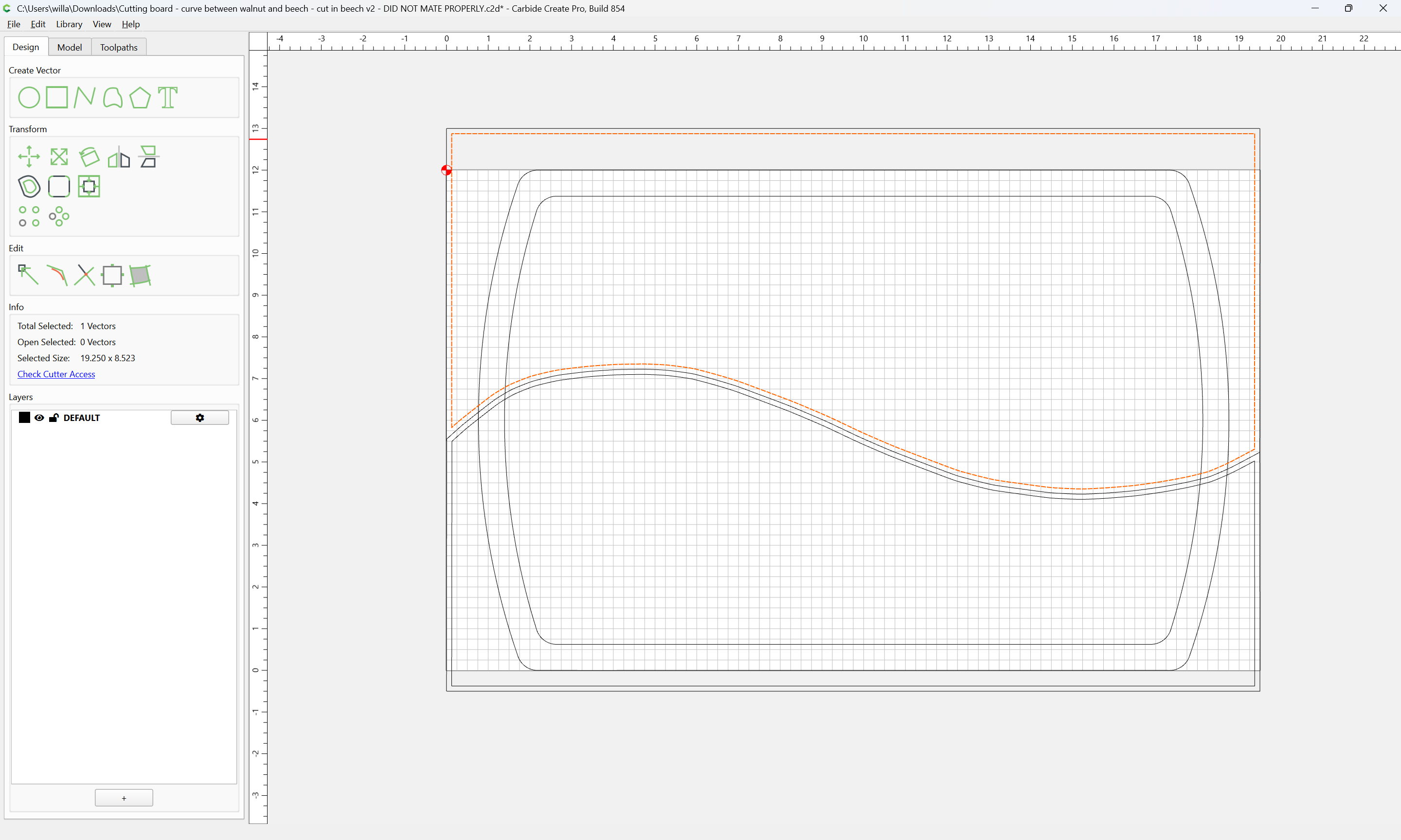

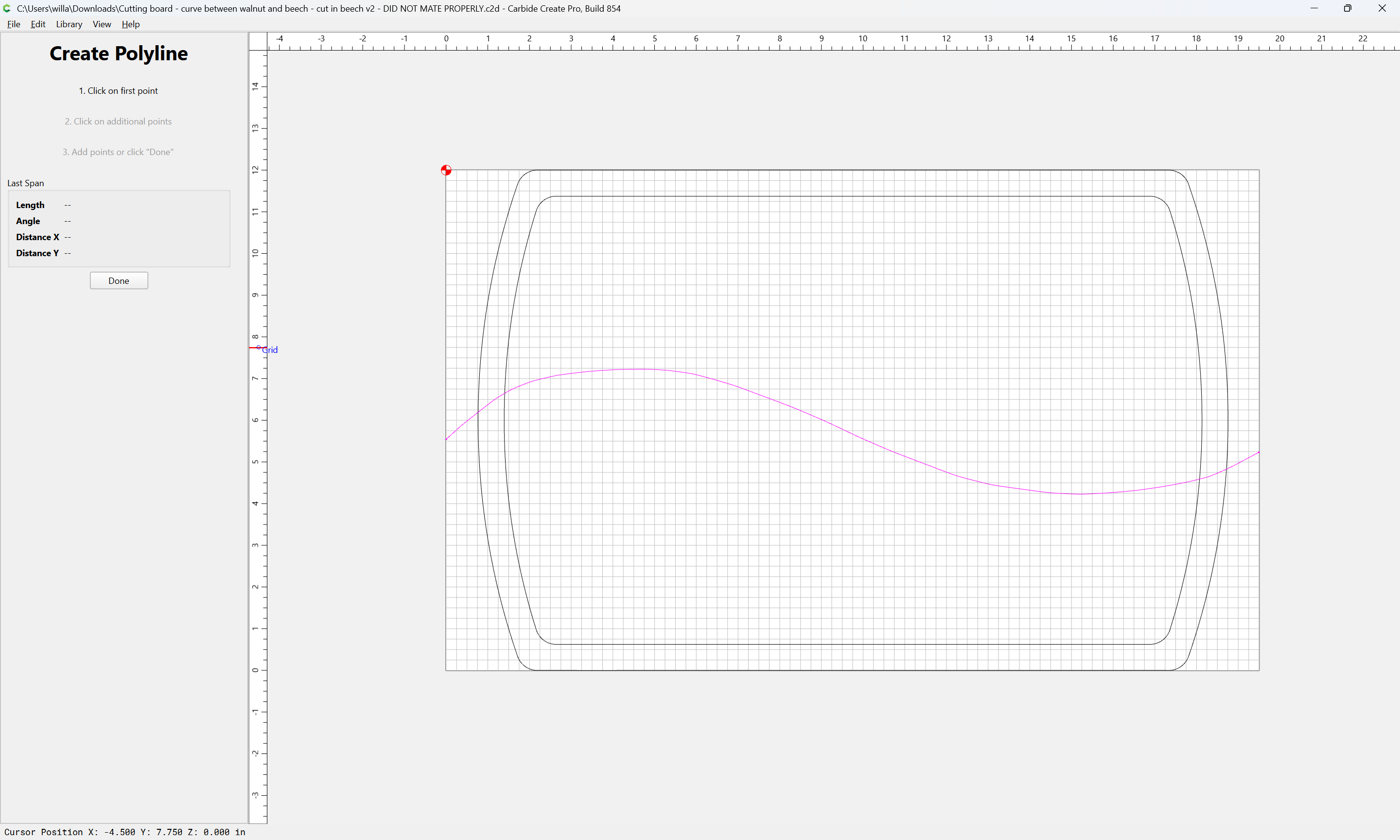

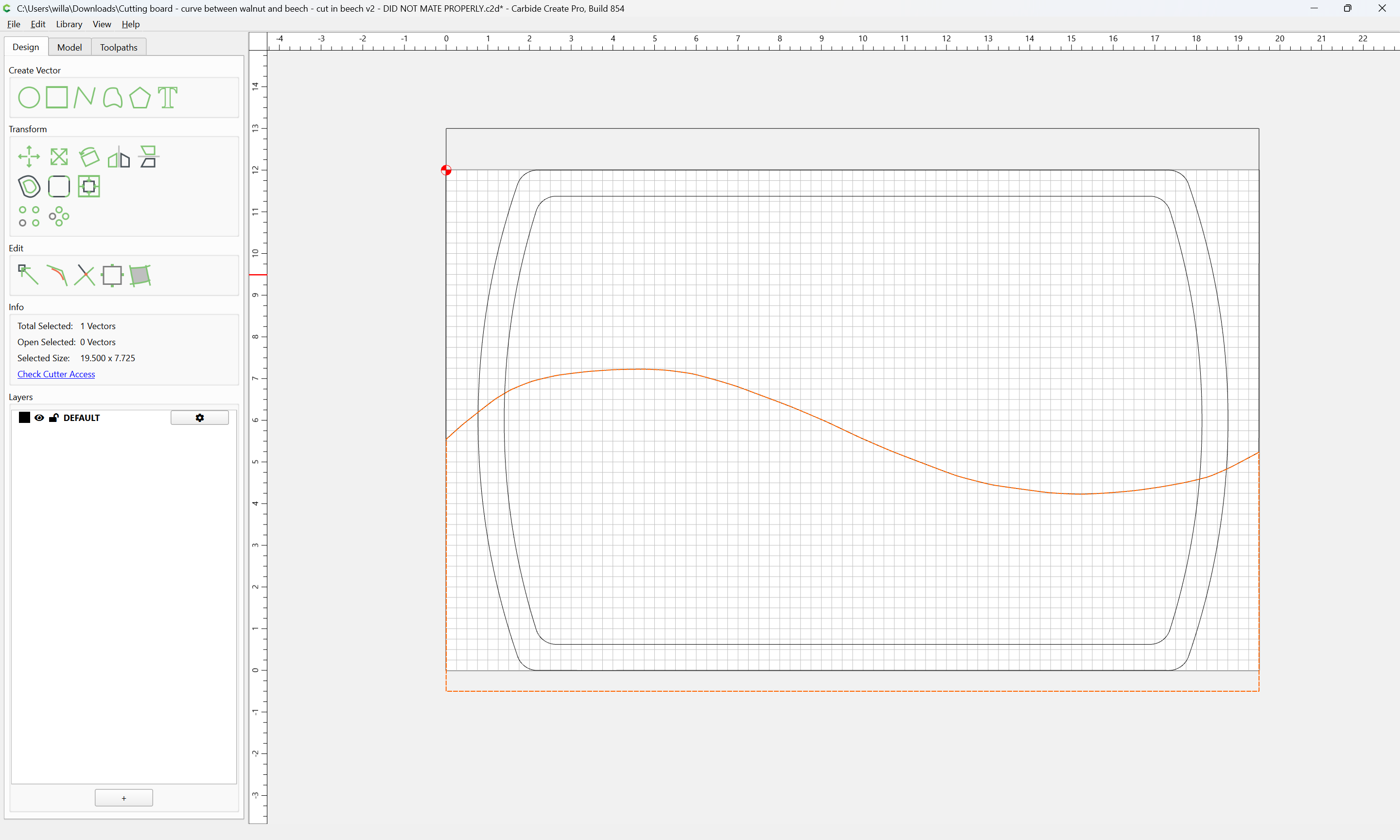

A two-tone inch-thick cutting board, top half beech, bottom half walnut, glued together along a sinuous curve: seemed like a job cutout for an S5P: cut identical curves in beech and walnut to a depth of 0.65 inches using a 1/4 inch #201 endmill, cut down the middle of the routed channels with a bandsaw, trim out the curves with a table-mounted flush trim router bit.

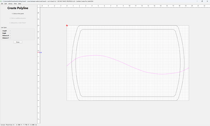

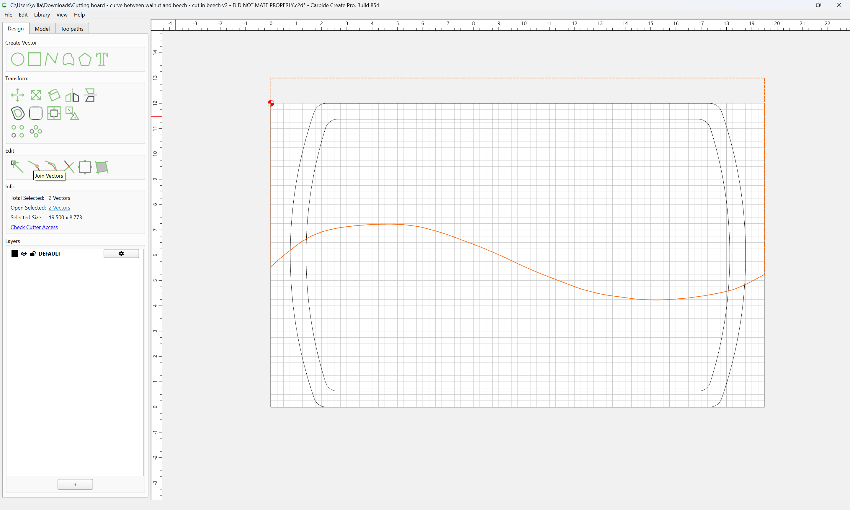

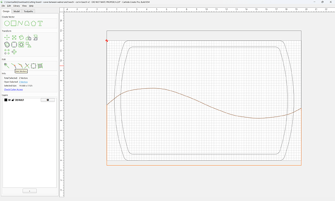

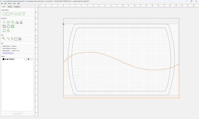

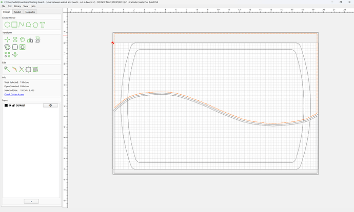

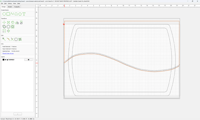

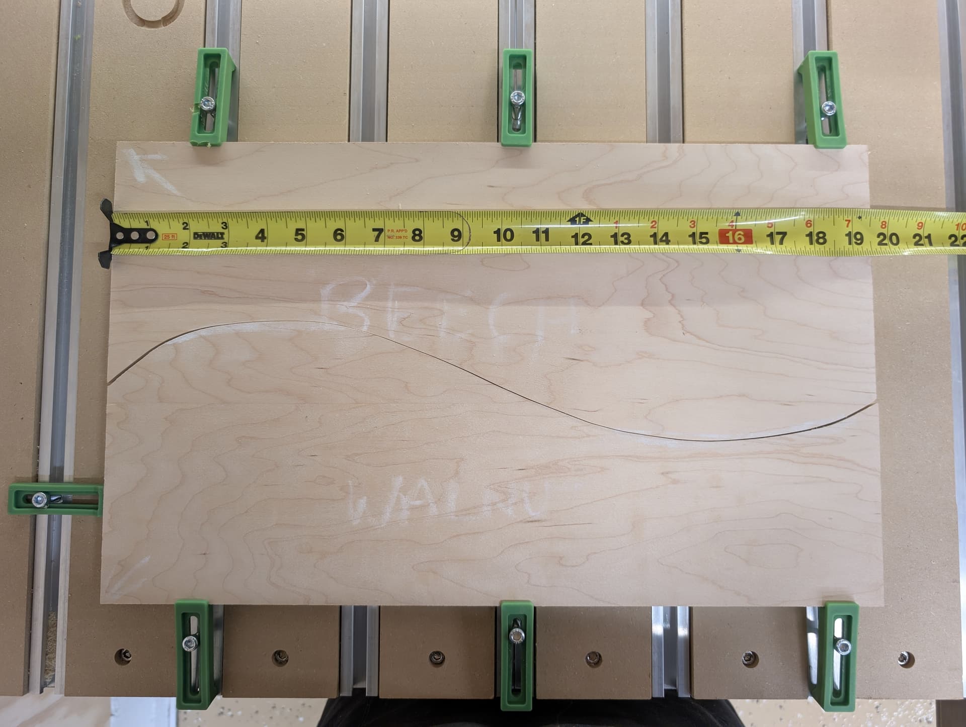

As often happens, practice belied theory: the two curves fit poorly, especially at the ends. I made two prototypes in 3/4 ply. One used a contour toolpath with no offset, the other had an inside cut on one board and an outside cut on the other - same poor fit in both cases. The pieces didn’t move during milling, the cuts were vertical. The curve, made in Carbide Create > Create Curve, is identical between the two cut files.
Any insight into why the curves don’t mate properly? I’m new to this CNC stuff.

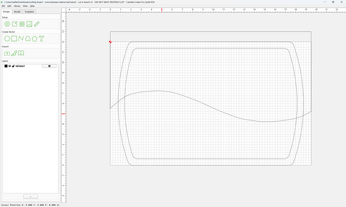

Cutting board - curve between walnut and beech - cut in walnut v2 - DID NOT MATE PROPERLY.c2d (208 KB)

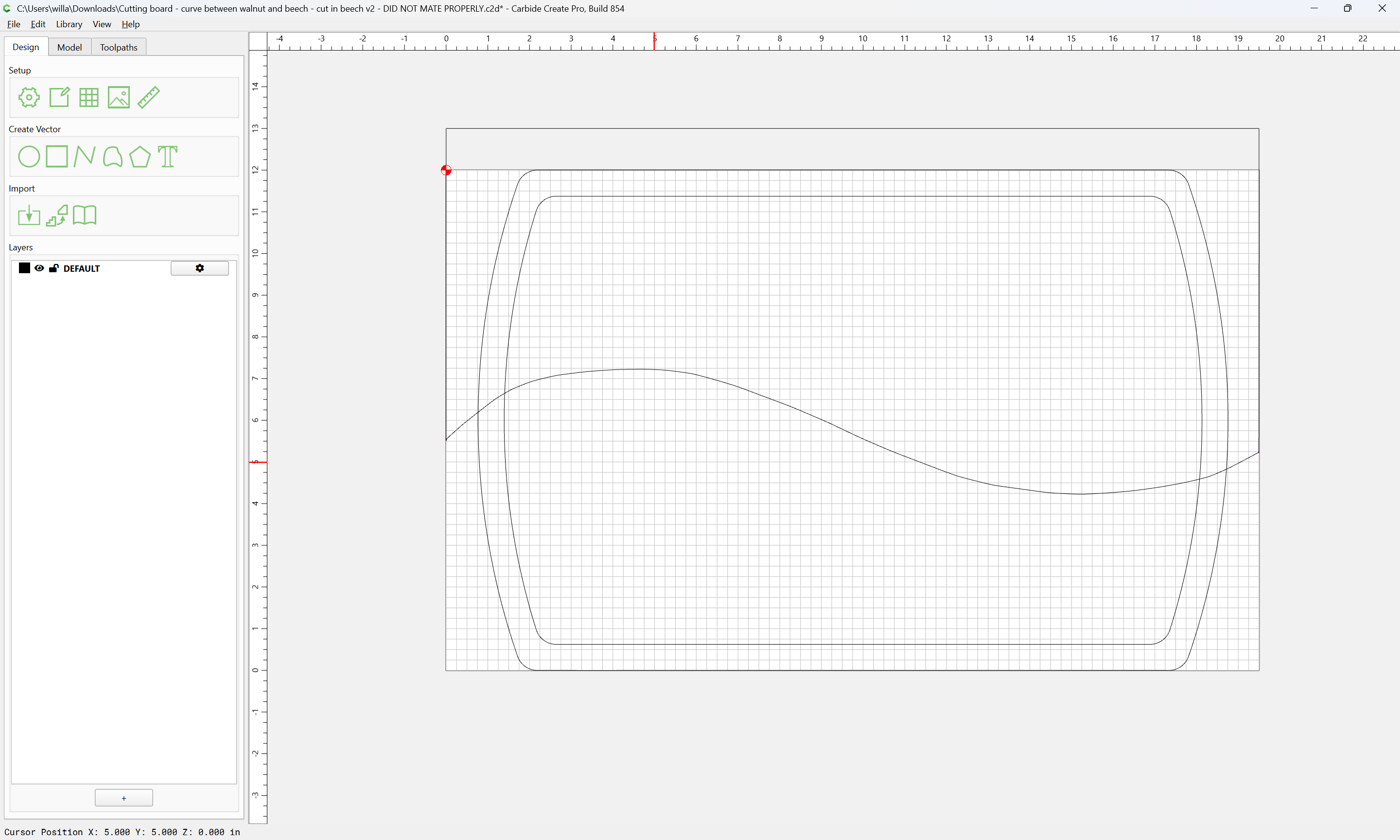

Cutting board - curve between walnut and beech - cut in beech v2 - DID NOT MATE PROPERLY.c2d (208 KB)
You can’t cut online. You have to cut one on the inside and the other on the outside.
OR, sandwich in a 1/4" thick spline to fill the kerf… :wink:

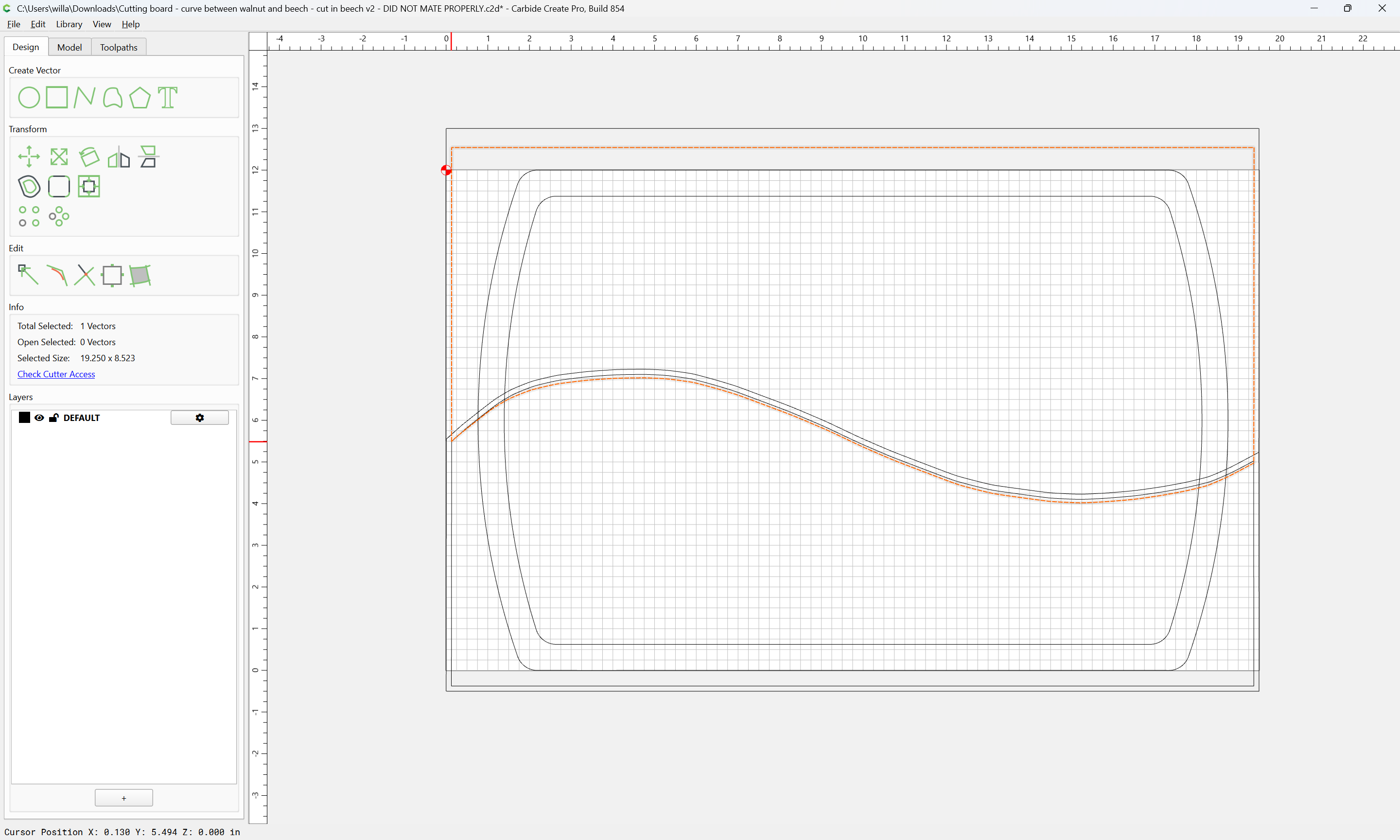

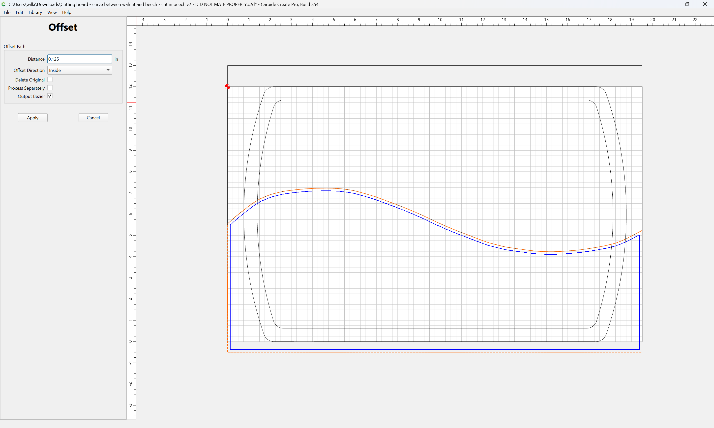

To show this graphically:

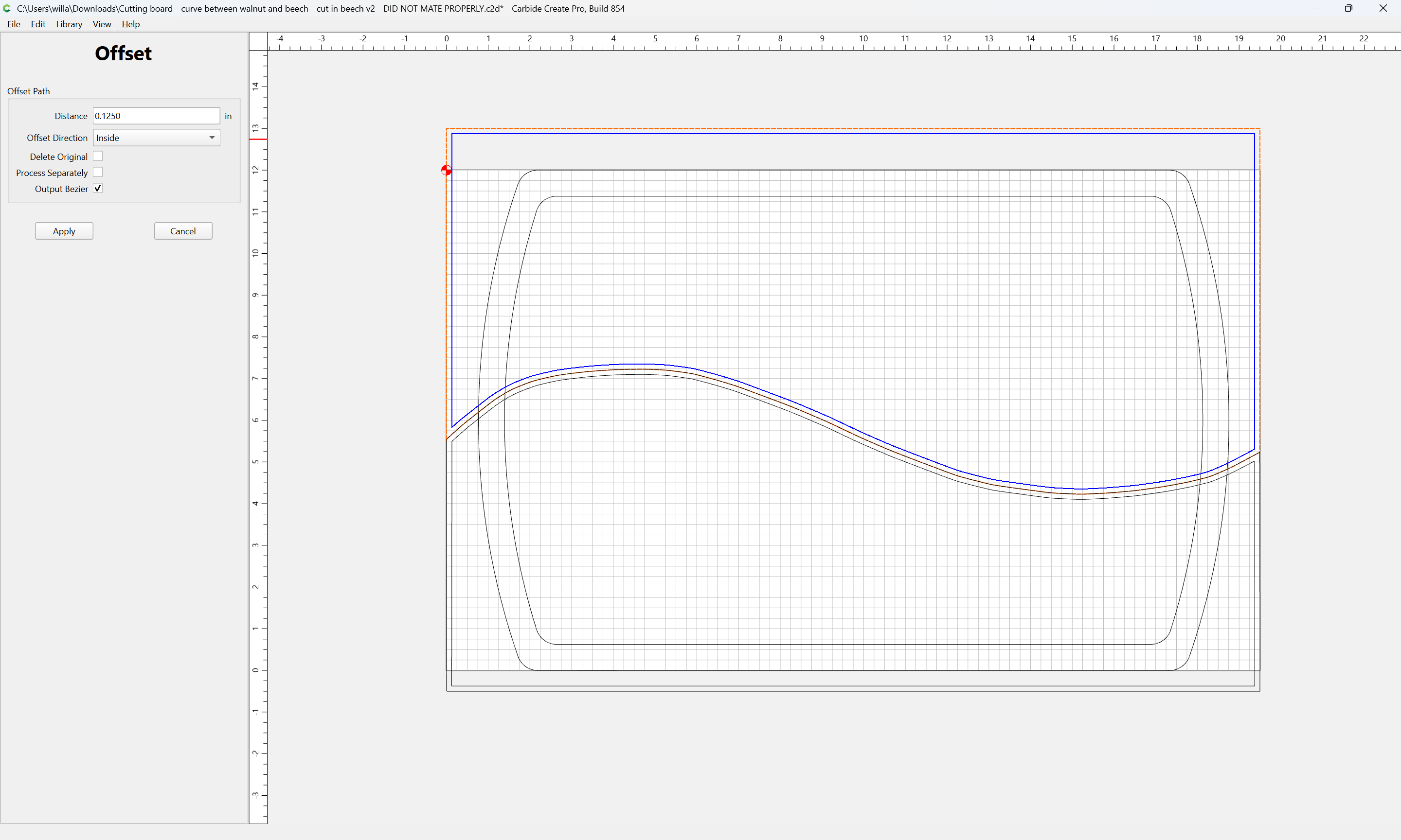

If we then inset each by the radius of the tool used for the cutting:

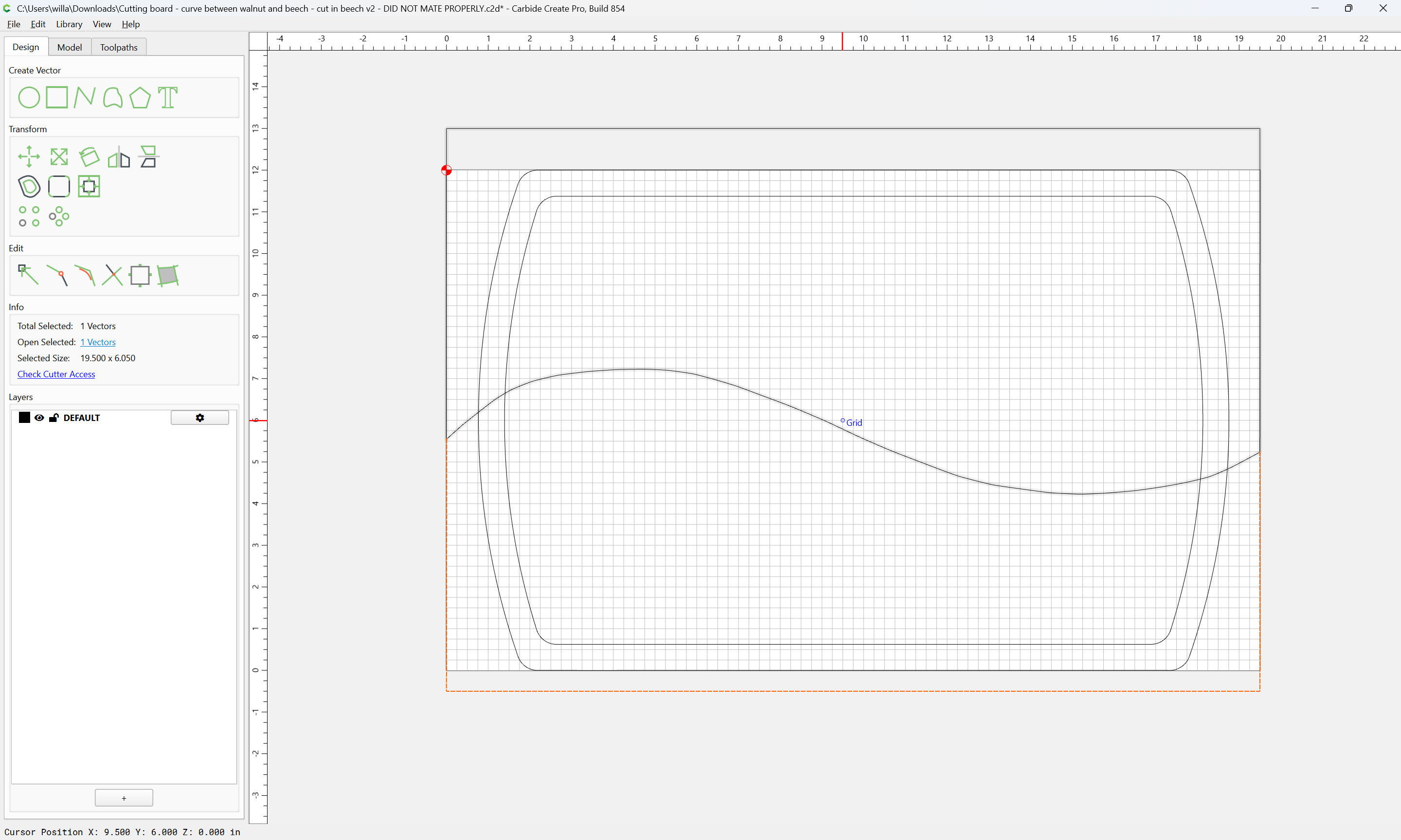

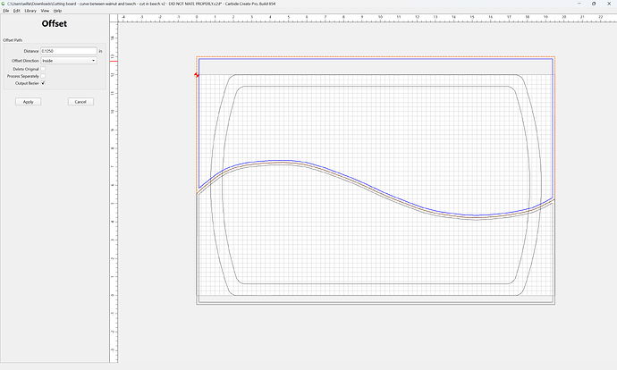

We can see that when we try to fit the two parts together:
they do not line up.
It would be necessary to cut to each side of the line for each part.
Thanks Will, for helping me understand what happened. That’s a clever way of checking the fit.
