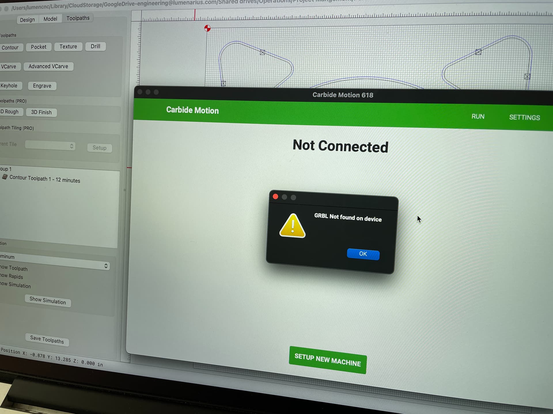

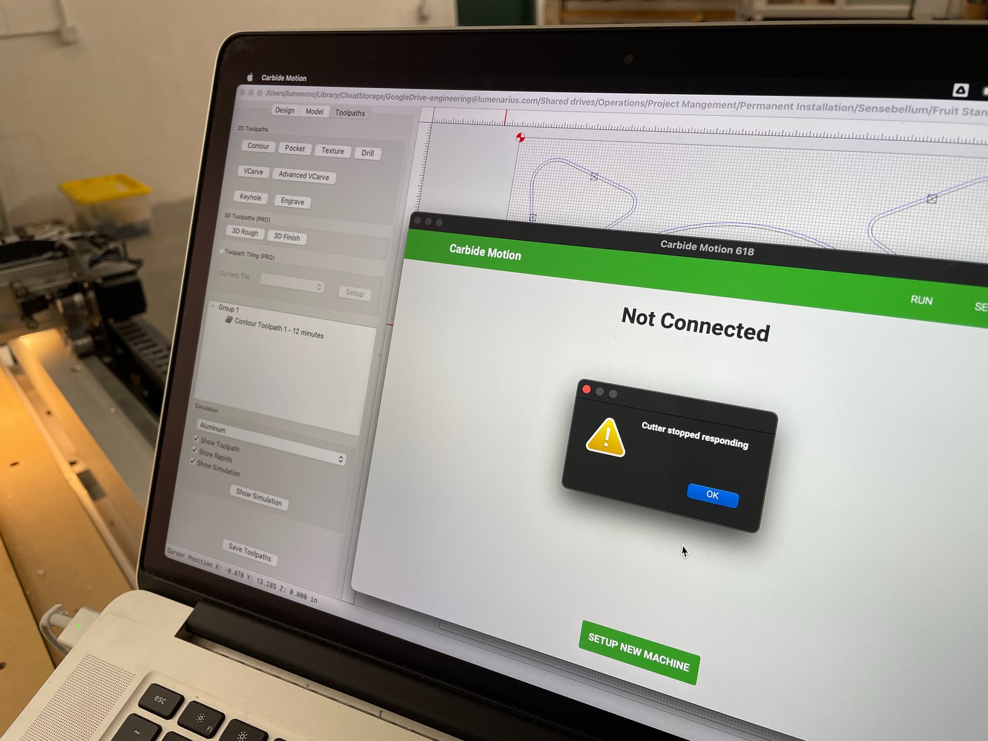

Why Does Shapeoko 4 Pro XXL Keep Crashing/Stalling/Pausing during job?
Every few weeks my machine gets a hizzy fit and starts crashing/stalling/pausing at random points in a job.
This hasn’t happened for a while but on a recent series of projects it has happened 3 times in a few minutes and it is becoming problematic.
I would like to see what we can do to determine what is wrong and keep it from happening in the future.

These are very very basic shapes and I am not running any custom firmware or G-Code.
It will crash in different locations and I have to power cycle the machine to get it to re-initialize.
Thankfully it keeps the 0 or this would be really bad!

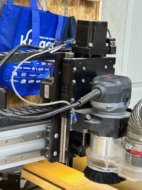

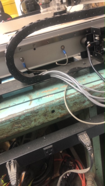

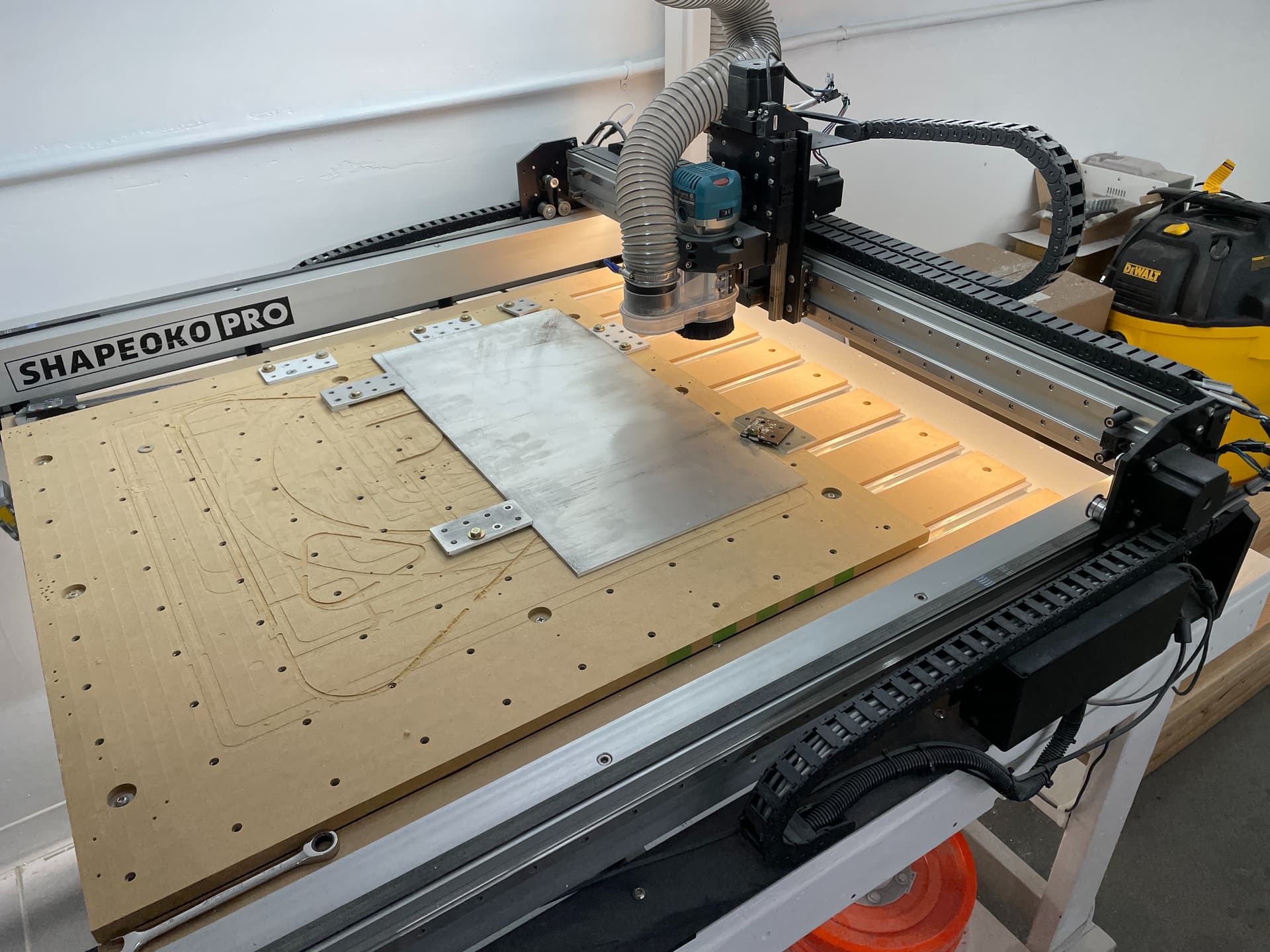

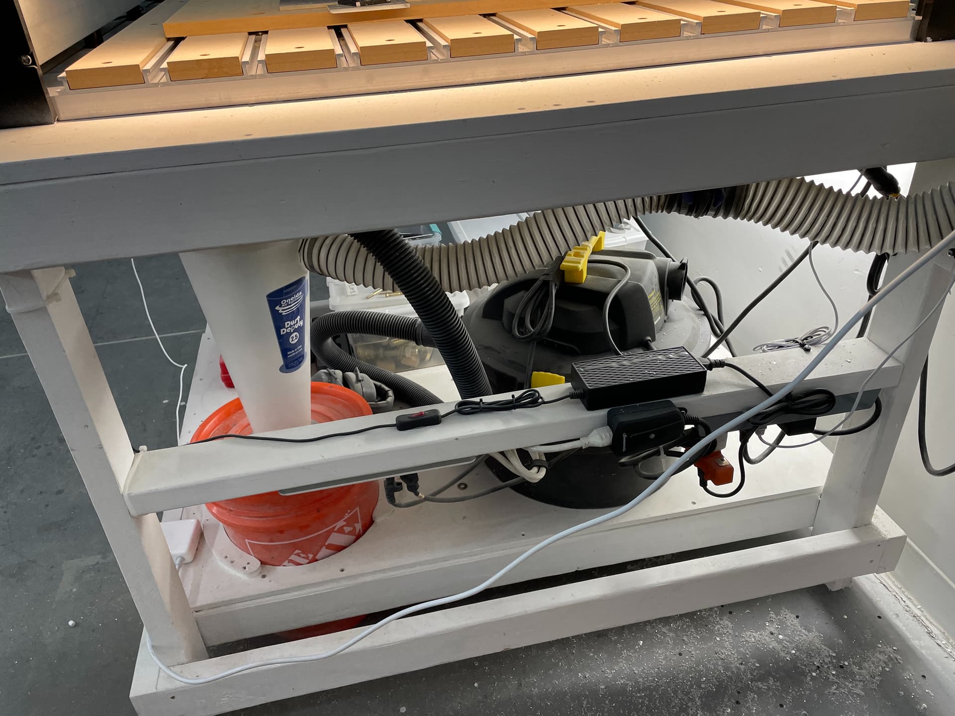

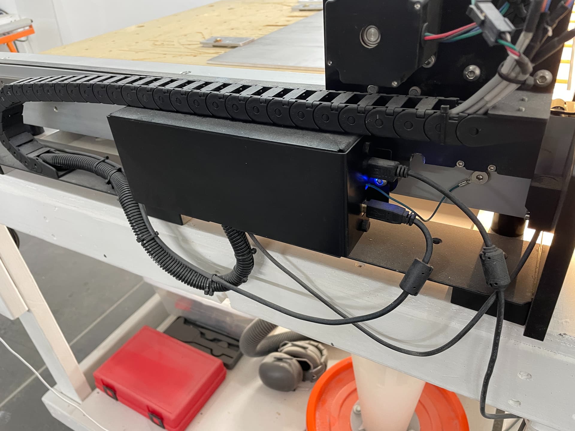

Okay I have taken a moment to look over the entire machine and cannot find any obvious grounding issues.
The USB cable has ferrites, none of the data cables are running next to air hoses or AC lines, also the circuit is properly grounded to the wall outlet.
Can anyone please take a look at the pictures of the setup and recommend and further action to mitigate this freezing possibly caused by grounding or EMI?
Thank you!

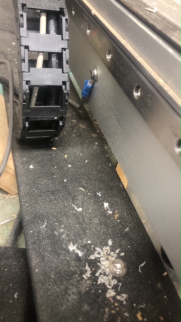

One More…
And another…

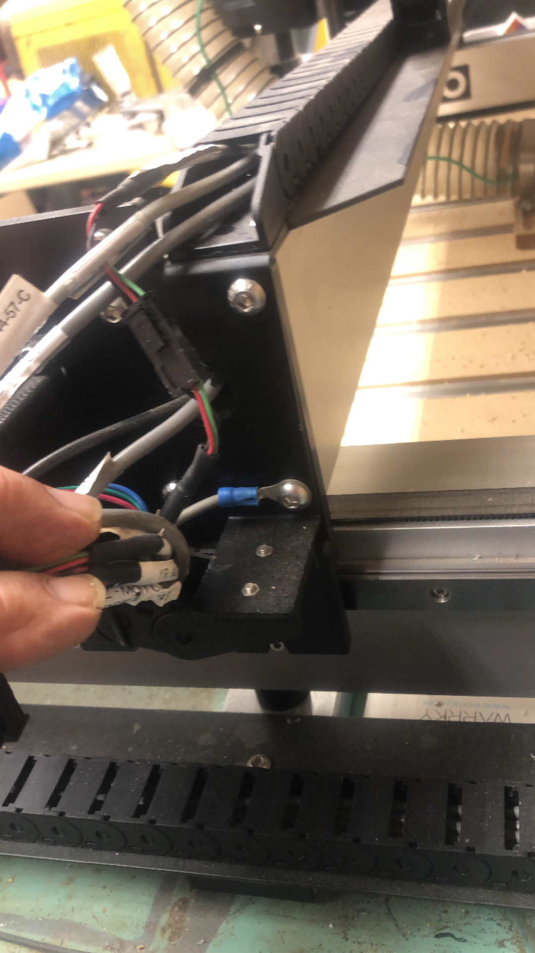

I ran grounds to everything. Case in point,the “Z” is powder coated, no way to get ground properly to dissipate static. I grounded the “Y” also as you will see.
Anywhere there was powder coating I cleaned a bit of it off to ensure a good ground. Oh and it is the grey wire…
Hope this helps.
I bought an electrical plug, some cheap ( maybe 24 Ga) uncoated copper wire., and a grounding bar. I ran the wire inside my vacuum hose, out, and back to the grounding bar. I ran a strand of wire to the ground on the plug and plugged it into the same circuit as my machine. I then used a multimeter to ascertain other parts of the machine were grounded. They were not. I ran wire to ground everything except for the trim router. I used to not be able to cut plastic. Now I can. The ground bar is the key to avoiding ground loops. Try it. It’s a very cheap solution.
I agree here. ground your gantry with a stranded wire 18 awg ish, down the drag chain, back down to the ground point on the Y rail. (that green wire coming out of the controller and attaching to the Y rail frame).
However I would try this first as it is easy. Move the controller’s P/S away from all that AC electrical. ( Mine was a single Vacuum AC wire passing by the Controllers Power Supply ) Yours appear to be right on top of a bunch of AC power bars next to the very EMI noisy vacuum. Simply move it and its cable way from all that AC stuff.

@Zman has done a great job of grounding everything. I would add that any noise that is picked up by all this grounding has to go somewhere, Right now it goes to that small green wire. back to the controller and then down a small power cable that has a choke on it, through the P/S and finally electrical ground . That is not a great path back to electrical ground. So you could add a better ground path to the same point on the Y rail. Redirecting the noise around the controller to a better ground. A 16 AWG wire running from the Y rail ground point to the same electrical ground that the P/S is plugged into.
You are beefing up the ground so the EMI noise has a nice easily path around the controller back to electrical ground, not through the controller.
Also the job of the choke on the DC cable is to be a high resistance for high frequency current changes ( Noise ). We use chokes to prevent noise from passing. But this is the only ground path back to electrical ground. We need noise to have a easy path back to electrical ground. not through a choke and a thin wire. So just provided a better one. :slight_smile:
The reason for the choke is to try to reduce noise coming from the power supply to the controller. So if we do this then we need to add a non restrictive ground path back to electrical ground.

I did not show everything. It all goes to ground at the Quad outlet. I also dropped a few ground rods, one at every corner of my shop. Have a single lead from the machine to a rod. Overkill, maybe.
Awesome, Nice work, Yep didn’t see that, I was trying to be clear for future reference to others. What I saw looks great :slight_smile:
