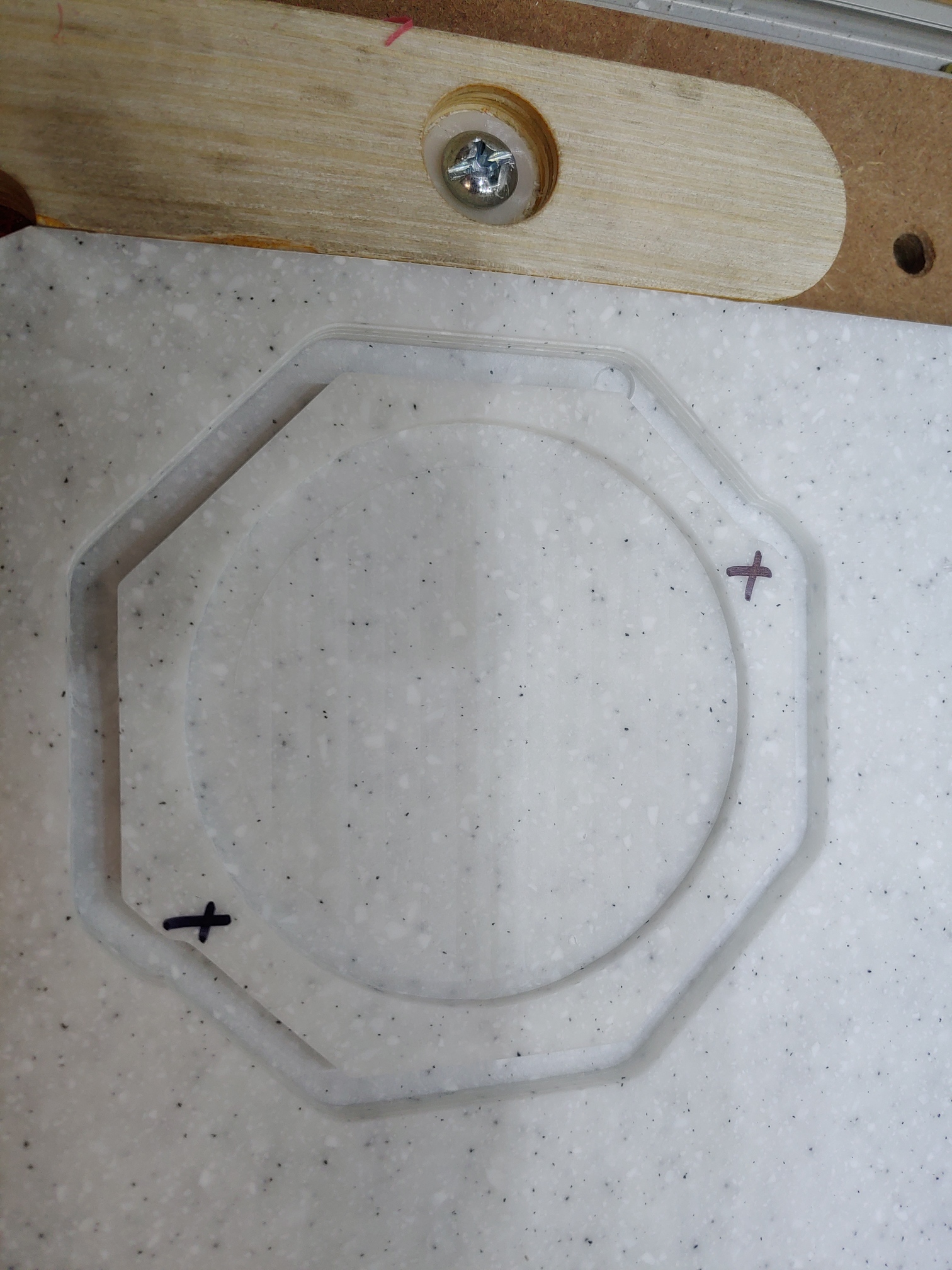

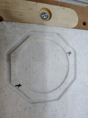

Why does this keep stepping over!?
I’m losing my mind. Why does this keep happening. There is NO step over in the design. I’m using Aspire. For some reason this only happens on shapes with angles, and it’s constant. Any time I have repeated angle moves this stupid step shows up!
If I rezero the machine, it hasn’t moved. I have copper wiring for grounding everywhere. The circles are perfect. Why???

It seems like it’s always in the same line in the hexagon - the one to the left has a smaller deviation too.
Is the material Corian?
It is. All I can come up with is static interference but I have everything grounded really well. I have cut these before without issue. I also redrew the hex shapes…same issue. It does always happen at the exact same place as well, thats why I’m so frustrated.

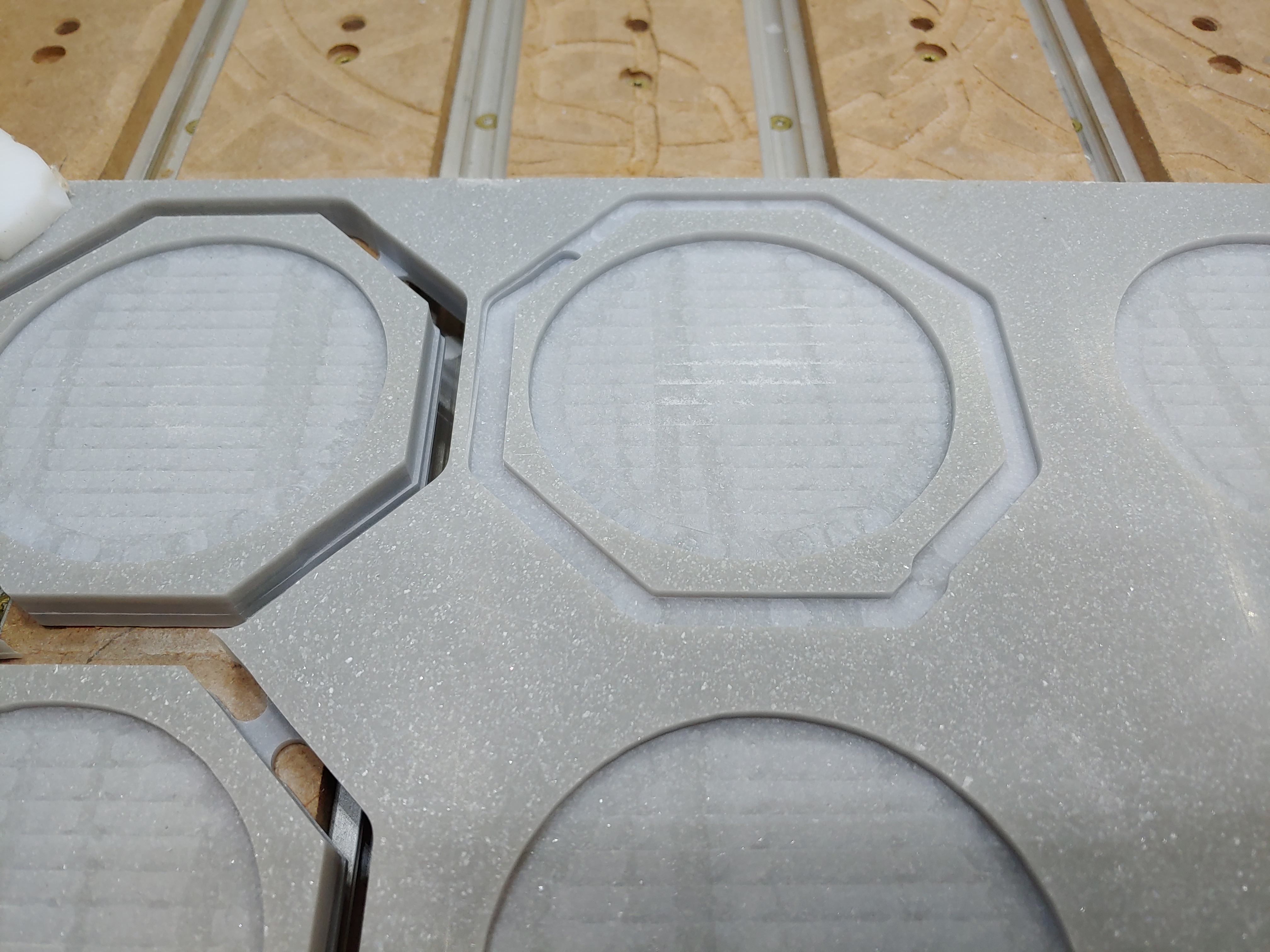

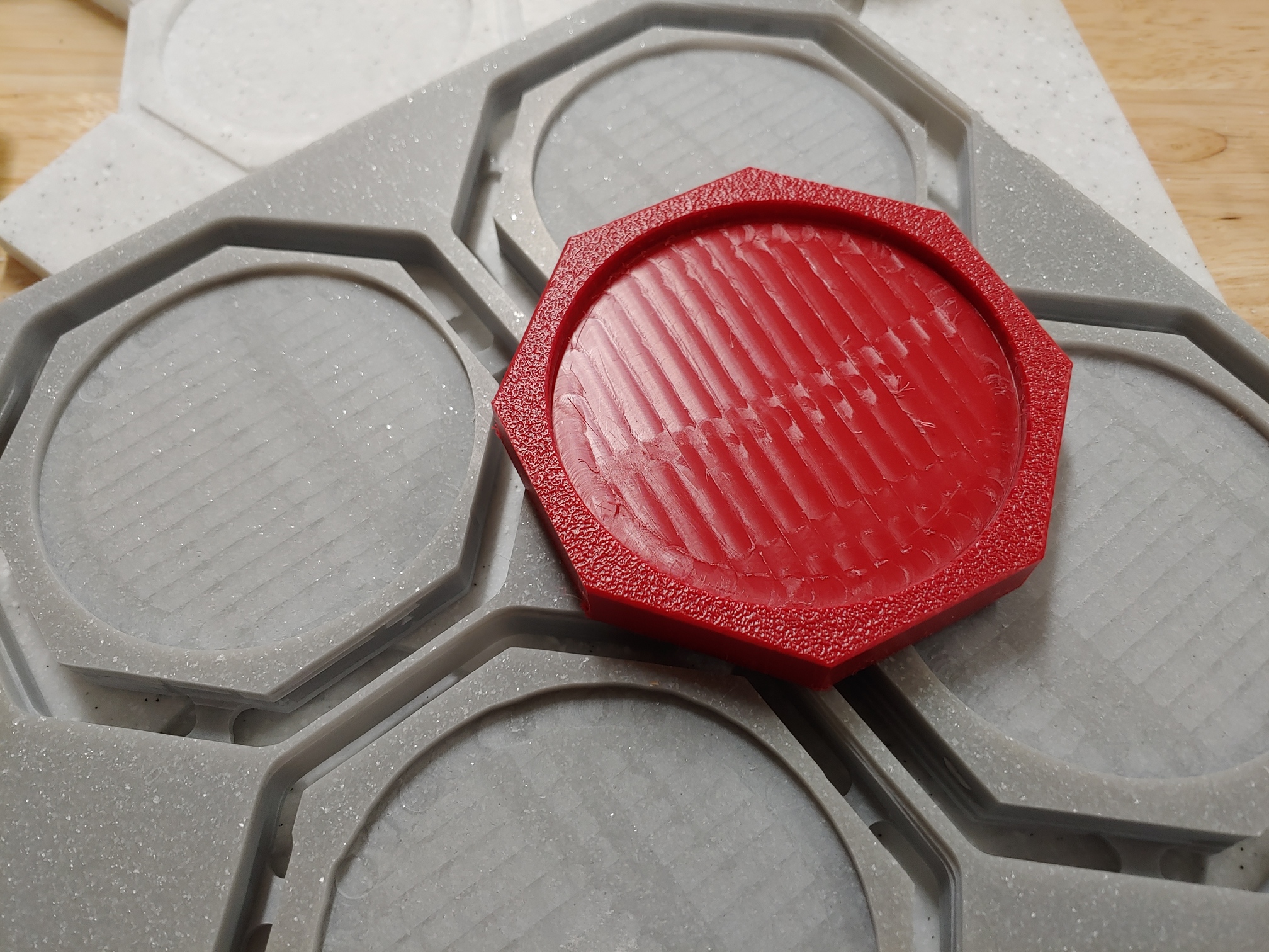

So I did a test with a scrap piece of ABS…and it’s perfect. So, new question.
HOW DO YOU CARVE CORIAN!?
I’ve made piles of coasters in the past, just this simple design, and no issues. Now they are offset, or have the step in them. Clearly the material is doing something to the machine.
And then immediately we swap back and same two spots!!! These are rediculously shallow passes (.04) at 60ipm. This should be like butter.

I am taking a pass after the fact. I can not for the life of me figure out why this keeps happening. It’s almost too perfect to be random glitching or skipping. It’s ALWAYS a small shift to the right looking at the machine. It’s always on the X axis, and always about .06-.08 shift to the right. And it’s not immediate. It’s after maybe the 2nd to third piece.
I changed my plunge method to just be a constant spiral and the wierd step in missing. Now it’s just a universal shift in that direction that happens 2-3 parts in, and then stays that way for the rest of the run. When it returns to origin…it’s back at the zero point…no detected shift to the right!
I suspect it’s a flawed section of belt — if you have an SO3 or XXL swap the X-axis belt with one of the Y belts (or replace it if you have a spare length).
