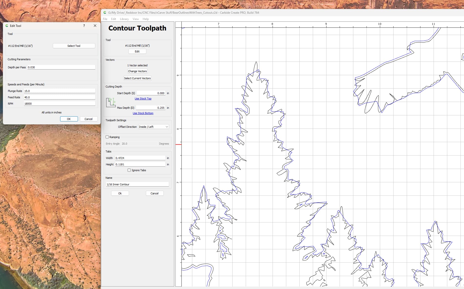

I’m trying to do a Contour cutout of some trees and a bird. It is more detailed then anything I’ve previously tried. I cannot figure out why my toolpaths are cutting off parts of my design? (See attached image)
Ahh, that appears to have fixed it. Many Thanks! I always assumed I was on the most updated because i never got any update prompts. I’ll make sure to manually check every so often.
v815 has been out for a while. In the past they used to push notifications about new versions and they stopped that. In the CC app you can check for updates.
Under the menu Help is “Check for Updates” and it takes you to the latest CC download page. That is v8 and cannot remember of v7/v6 had that feature.
