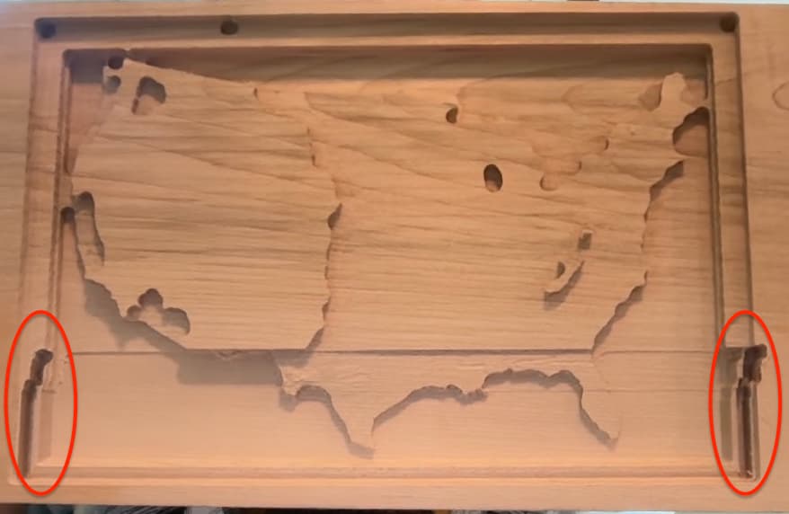

My Shapeoko 5 Pro CNC is messing up all my 3d carves every time. I keep on trying and it messes up again and again. I can’t figure out the problem. Looking forward to hearing back from y’all. Thanks!

I am using carbide create pro and carbide motion for this project.

I’am setting it in the lower left corner of the stock. I’am also using the clamps that shapeoko sells.
For the roughing toolpath I used the 1/4 inch bit and the speed dial was set to 1, for the finish toolpath I used the 1/8 ball nose bit for the finish the speed of 4.

It would stat good then it would do that.
I used the clamps shapeoko sells.
And zeroed it in in the left hand corner

looks like a slot cutting issue to me. When the bit has to cut in a deep slot the friction is high, therefore the force needed to continue cutting exceed the power the stepper motor can provide, the stepper motor misses steps, and that way looses the proper alignment: it is out of position, tries to cut very deep with the now very deep cut, gets stuck and even can cause fire.
Therefore narrow slots -if needed- must be cut with extremly conservative speed, proper bit (no down-cut or compression bits), or if ever possible should be cut as a pocket, the very last depth cut then as contour because of the tabs. Tabs are only possible with contour cuts, not with pocket cuts.
The latest motion version (still beta?) has that feature automated, I think, did not try it yet.
