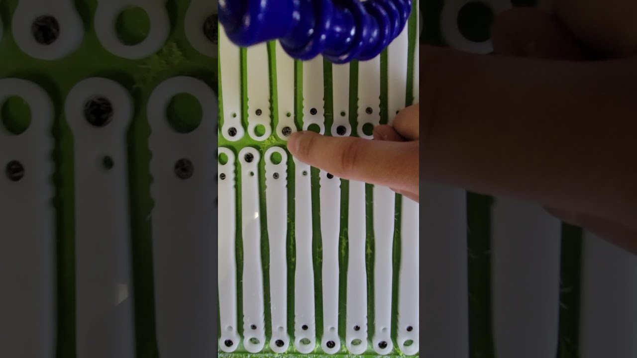

Wildly innacureate limit switches. (0.0135" off)
My limit switches are frequently off by roughly 0.01" or more, forcing me to throw out about half of my projects. Any ideas on how I could increase accuracy here? Are there high end limit switches I can buy? (currently using a carbide3D set that came with my HDZ.

video of issue
drifted was not the right word to use, the change in y position happens during the homing process, not while milling
Is the change in Y consistent across the X axis movement or does it vary?
consistent

I apologize if I am missing the issue, but one thing I noticed is your use of a MDF jig.
I use a jig like yours to complete milling on the second side of an initial cut, when I first setup this jig I was using MDF. Then in CAD, once I flip the parts the machine should know where the parts were, but the MDF was expanding/contracting meaning I was not getting the cuts that I wanted. Could this be your issue? The MDF jig you have at the bottom of your stack may not be perfectly square due to moisture making the MDF expand/contract?
To solve this, I am using a jig that was cut out of aluminum. I was getting cuts that were off by 0.1 mm to 1 mm, due to my MDF jig expanding/contracting.
I know the issue is with the switches because the holes for the screws will be in the right place, then without turning the machine off, the Y axis of the next operation will sometimes be off ±0.0135
Are the screws in the right place? See my comment above, you are using MDF figs/fences with expand contract.
I doubt that the fixturing is the issue because if I turn the machine off and on /re home the thing, it will have the right positioning (or with a similar range error ±)
