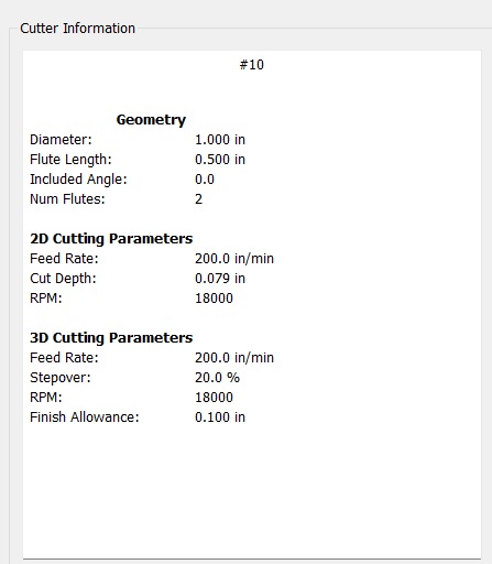

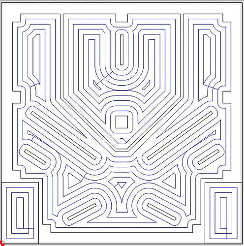

I have to do a lot of pocketing with a Shapeoke XXL and purchased an Amana 1" 2 flute to speed things up. I configured the 1" flute in CC Tool and the CC preview looked fine, but when then file was loaded to CM, it cut 1/4" too wide everywhere (almost like it though it was a 1/2" flute). I did configure the Diameter to 1" in CC Tool. I use CC V7 and CM 613.
What am I doing wrong ?

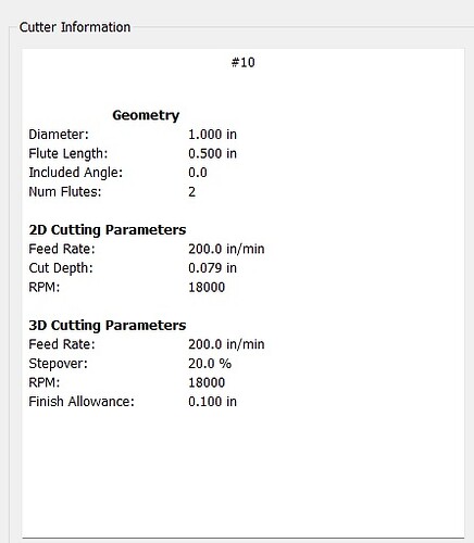

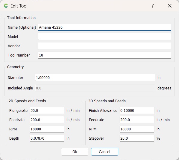

Also include a picture of the tool parameter page, since anyone that opens your file won’t have that tool.

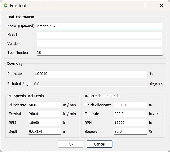

Please also post a screen grab of your custom tool setup.
Amana 45236-3

The definition seems okay and to match:

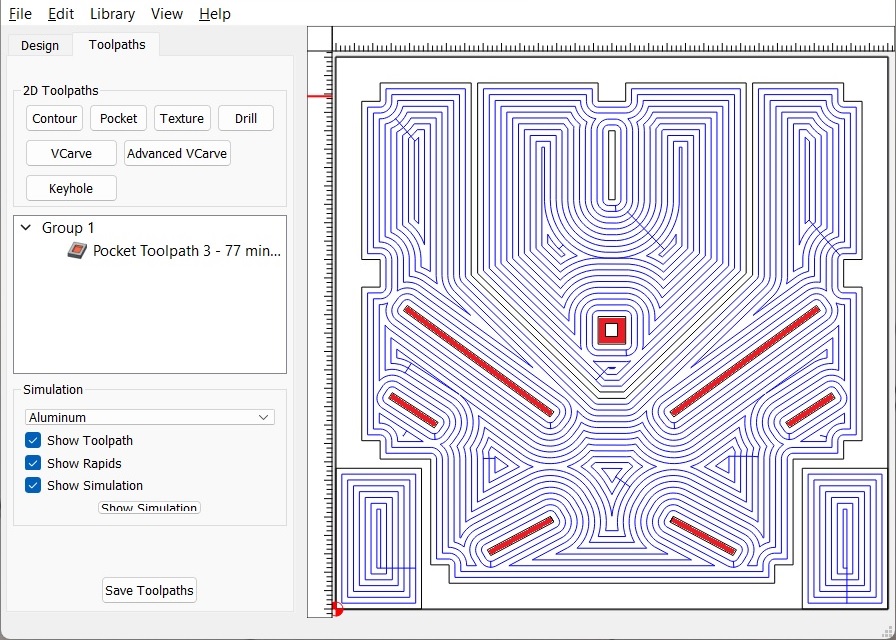

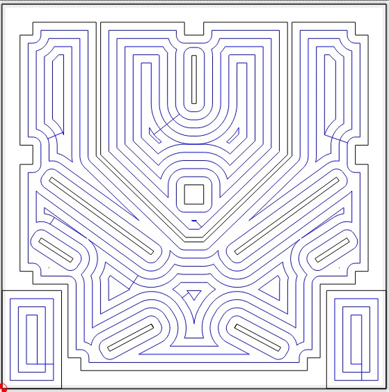

Here is the CC preview. Plate is 24x24x1". This is where I stopped. The red should be solid, and not removed. C2d file attached.

The first thing I notice is you have the Amana 45224 selected for the path (1/2" tool), rather than the 45236 you are showing above.
Thanks. Probably just a file problem then. I will erase the c2d file and generate a new.
Why?? Just replace the tool with the right tool & you’re good to go. :wink:
Thanks. This looks better.
