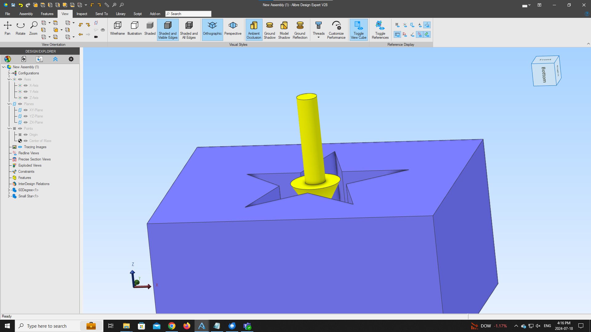

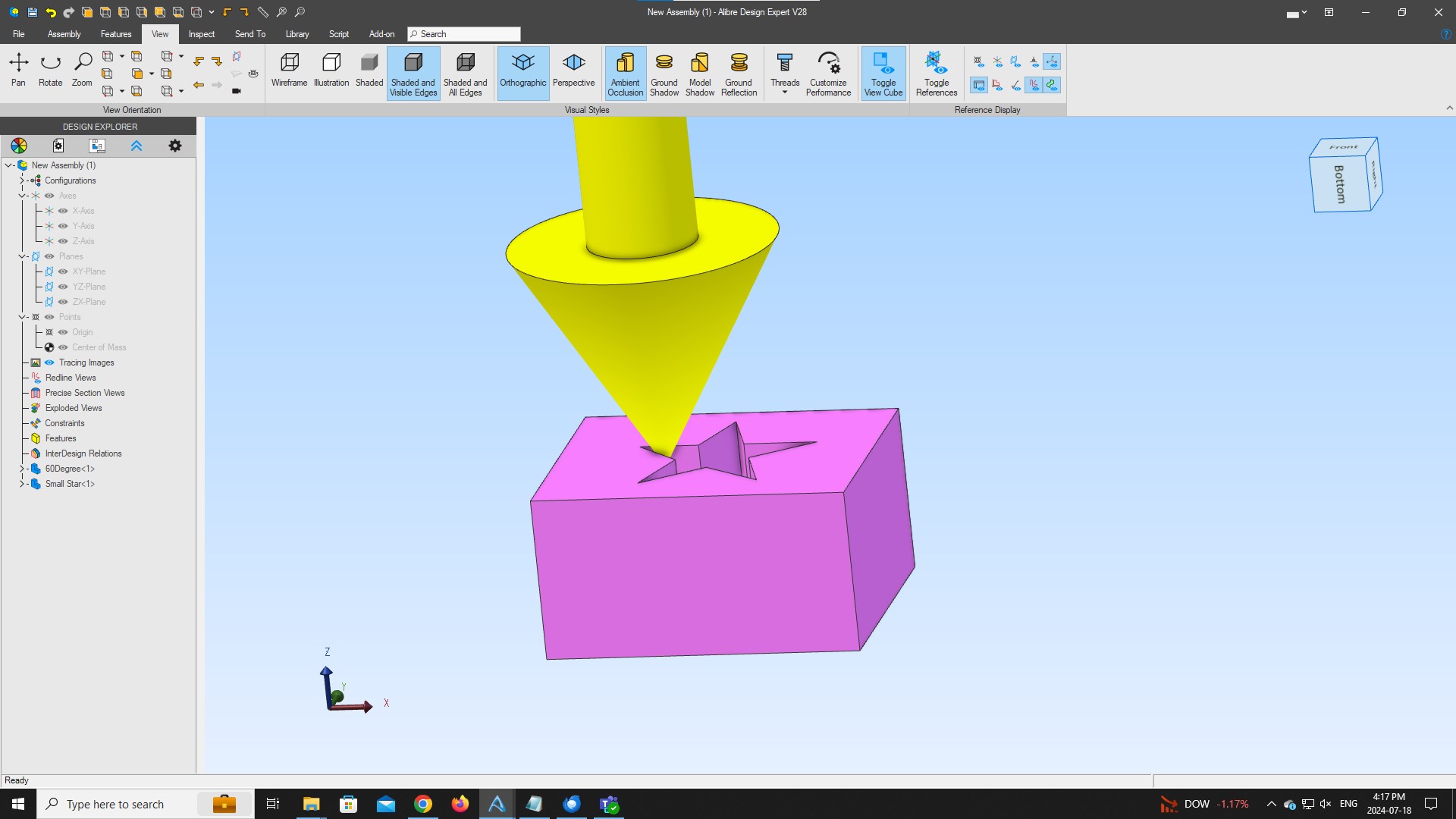

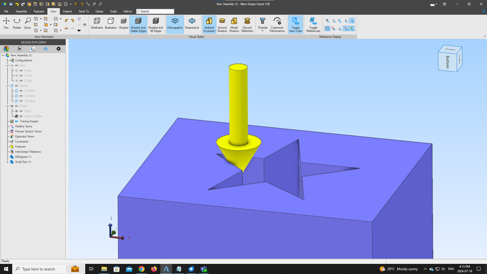

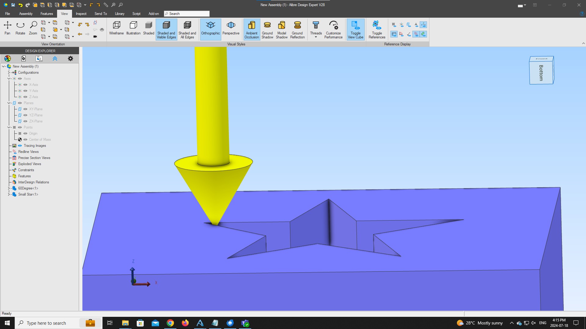

Its my understanding that the depth of a Vcarve is constrained by the drawing dimensions rather than by toolpath settings (I assume toolpath settings can just limit depth). Meaning the V-bit will plunge until both sides of the cutter touch the drawing. See below in blueish-purple an example of a star big enough (Too big) to get the effect you’re looking for.
I think you just need to scale your stars to get the desired effect? I think what is currently going on is pictured on the pink block
