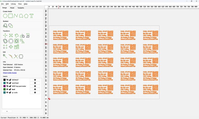

Im having a lagging issue when creating an array of business cards. I have 1 designed and placed, then create an array 4x6 to make a batch of 24 as pictured.

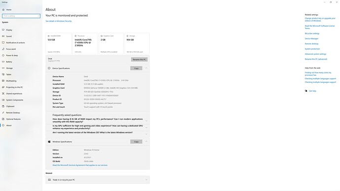

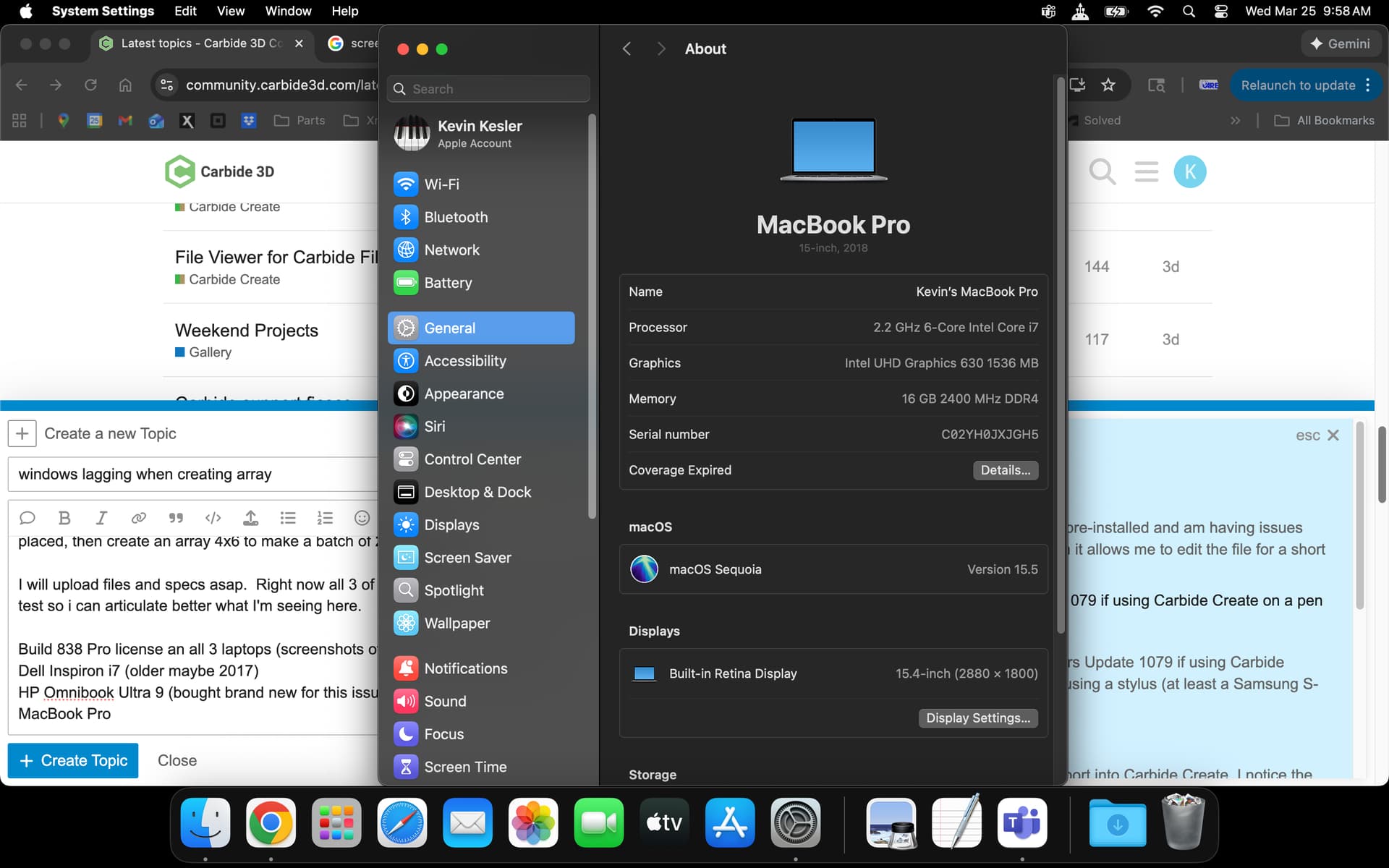

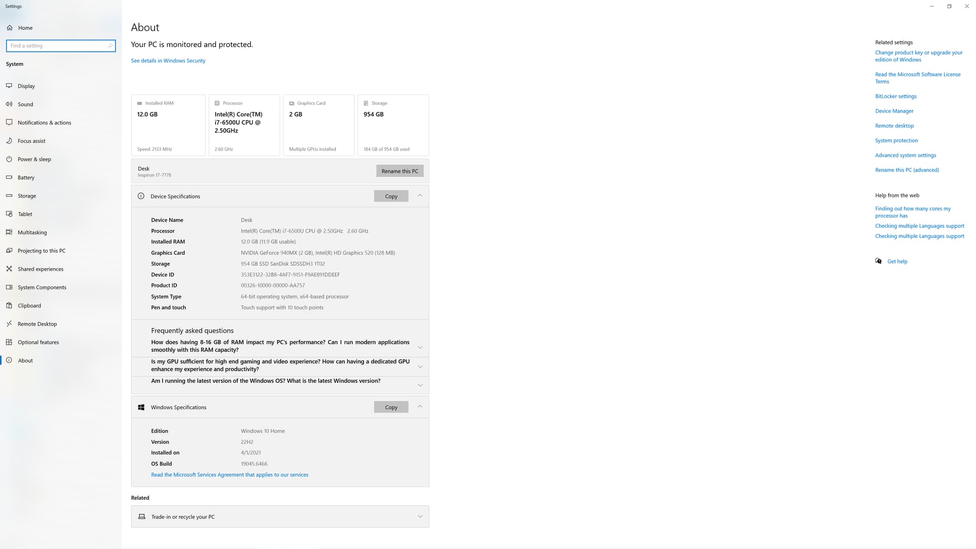

Build 838 Pro license an all 3 laptops (screenshots of system specs attached)
Dell Inspiron i7 (older maybe 2017)
HP Omnibook Ultra 9 (bought brand new for this issue)
MacBook Pro (2018 i7)

was getting the details from all 3 computers together. I set out to compare the processing time for each as a comparison. all 3 run about the same amount of time, even with the newest having WAY more power.

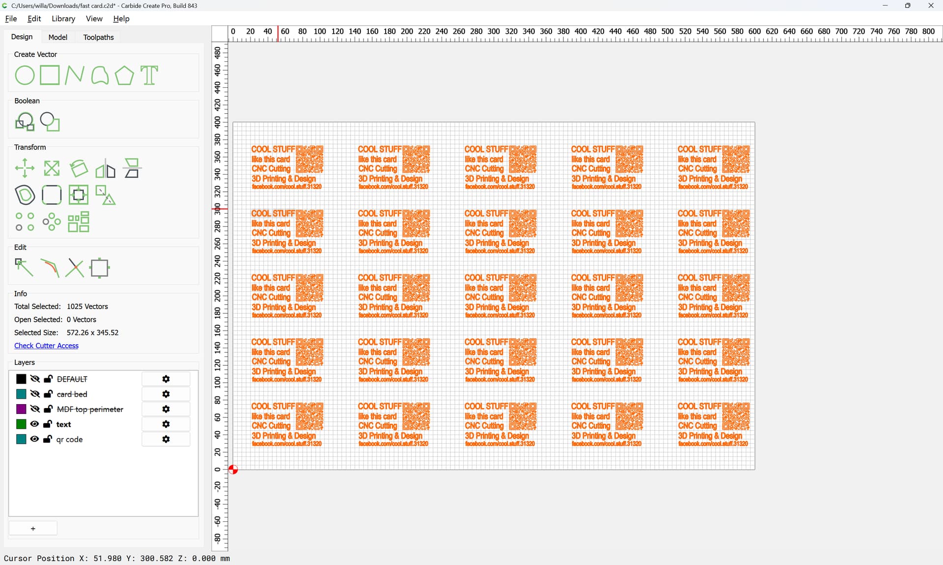

after replacing the chrome generated qr and the cube, my process time for array (including toolpaths is a few seconds, followed by maybe 10 minutes of toolpath calculating, but definitely NOT getting STUCK in the array application.
fast card.c2d (564 KB)

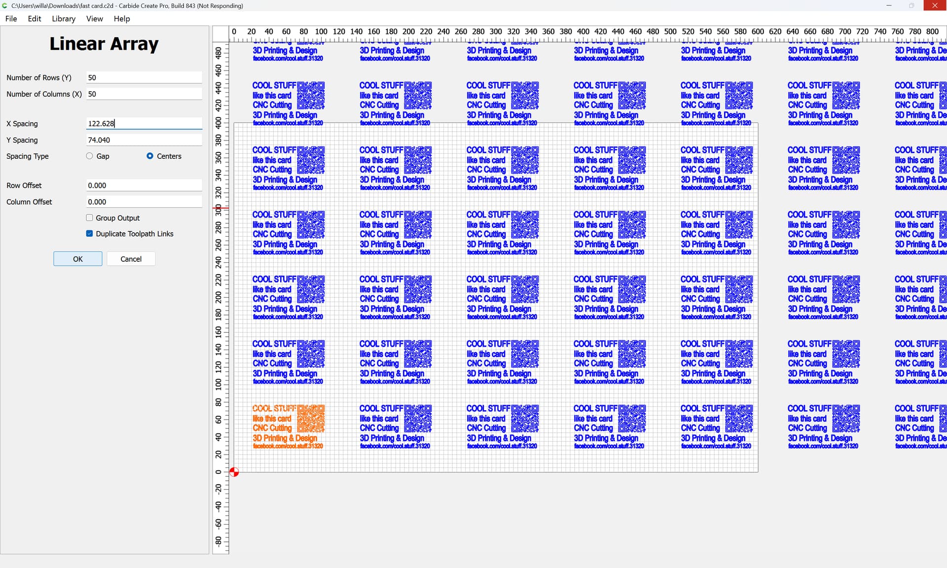

It took a while, but I got my computer to cough up a 50 x 50 array:
(but it’s still working on re-drawing it)
I found that making a smaller array:
is essentially instantaneous — if the toolpaths are disabled:
Enabling them then requires a bit of a wait while toolpaths are recalculated.
