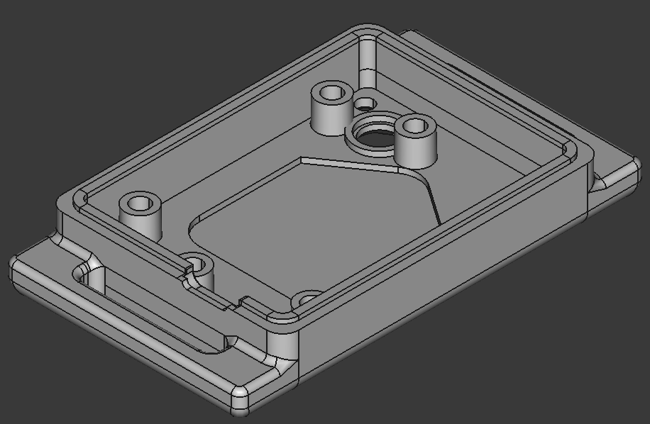

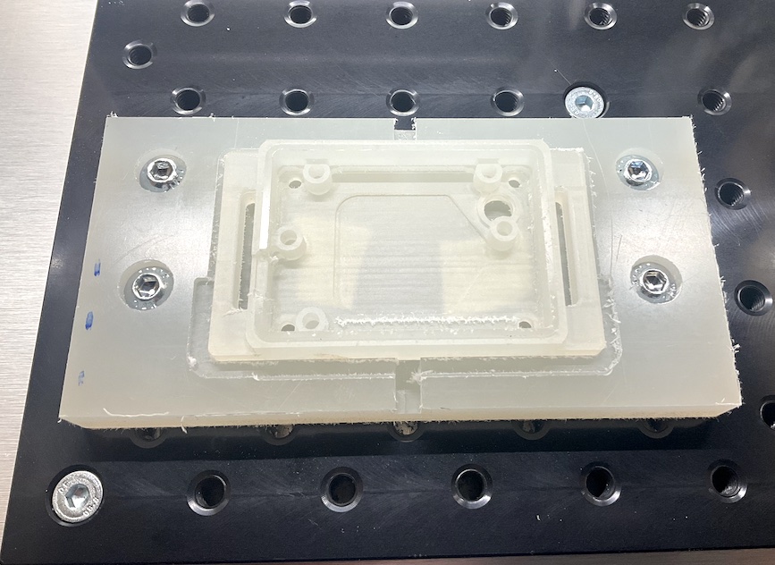

I am milling an electronics project enclosure (see attachment), dimensions ~1x2x3" on the Nomad3
The enclosure will be machined in two parts, separated nearly midway in the vertical axis. This accommodates a circuit board access port on the side.

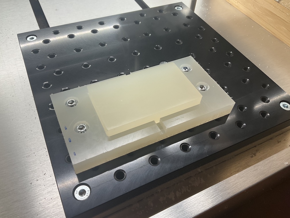

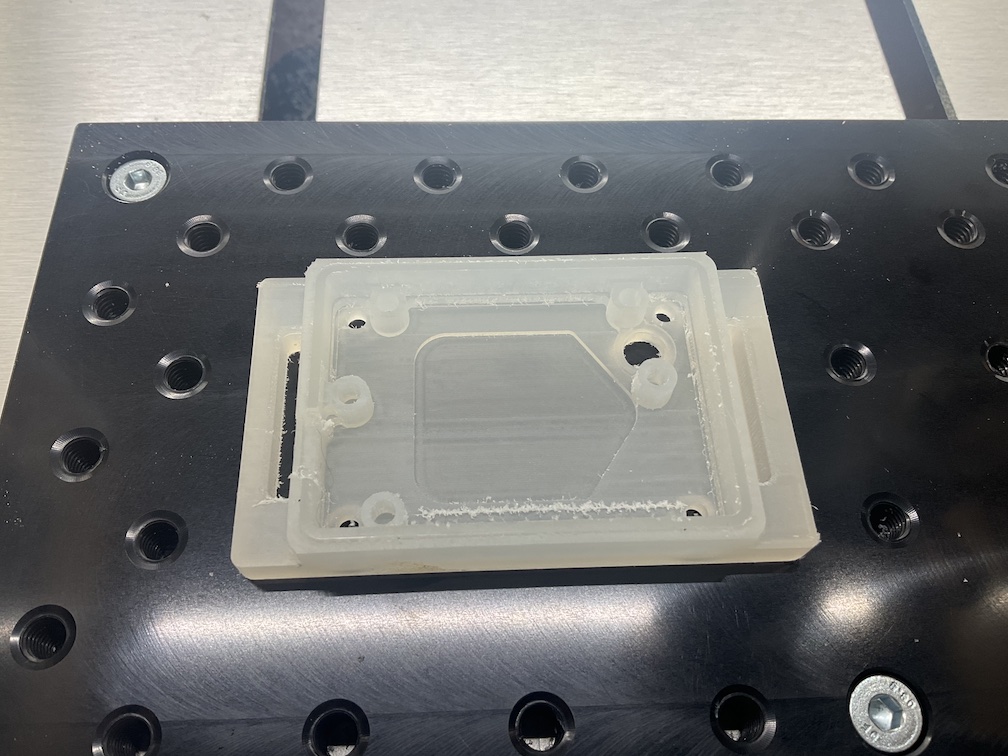

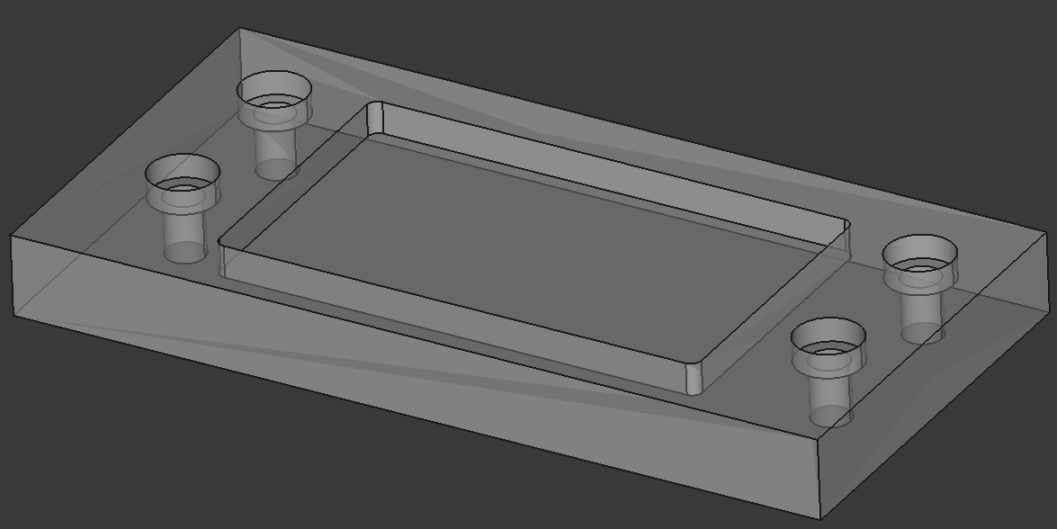

To help with alignment on the work table, I’m milling a fixture to fit the Nomad Threaded Table, using the 1" pitch array of M6 threaded holes
The design intent of this fixture is:
  • fix the work piece rotation about the z-axis
  • support flipping the work piece (front and back milling)
  • aid repeatable localization

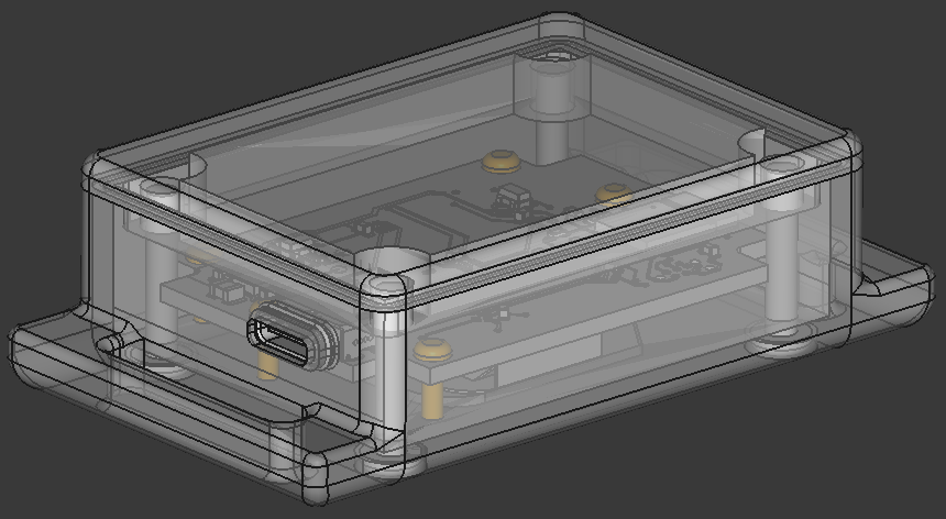

I’m not sure what the mating surface looks like on your enclosure but you might be interesting in shadow lines
Shadow lines are great–I’ve used them on my 3D-printed estop enclosures.
Integrating the shadow line with the case split at the USB port level would be interesting. I envision a wide shadow line (the height of the current USB opening) with the USB port set in it like the turbo exhaust port in the Death Star equator trench… :slight_smile:
Seriously, @andres , I like your design. Hidden assembly fasteners and you have thought through the fixturing as part of the design process. :+1: And doing it on a Nomad. :+1: :+1:
Thanks for the reference! I will incorporate a shadow line into the mating surface of the milled parts.

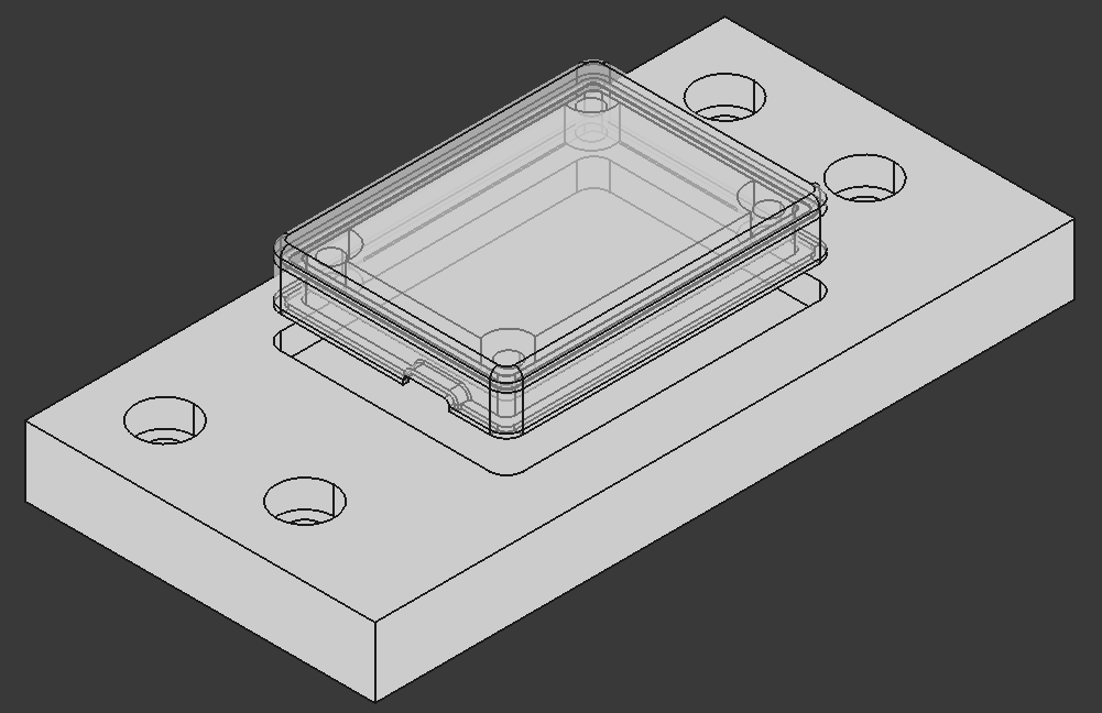

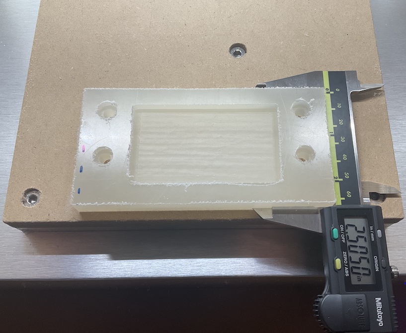

Channels are added to the fixture to aid removal. The “blank” press fits into the fixture’s pocket.
Workflow is:
  1. FreeCAD export STL
  2. MeshCAM import STL, generate toolpaths (Roughing, Unified Finishing). Feeds and Speeds are manually transcribed from CarbideCreate
  3. CarbideMotion import gcode, zero, and run

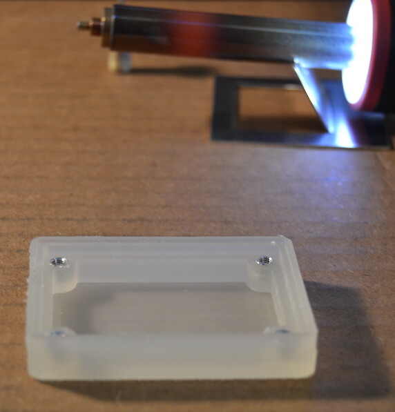

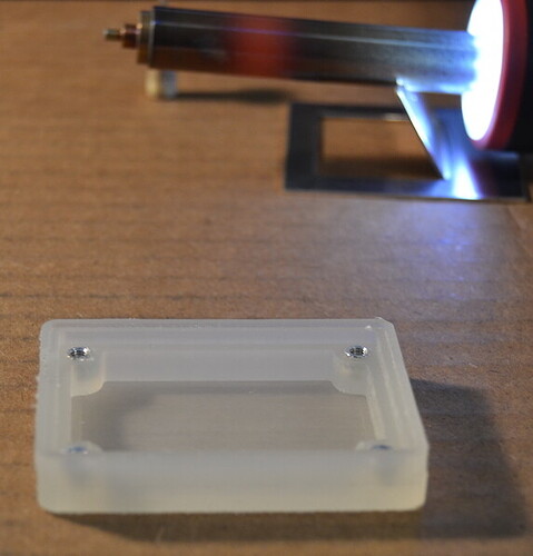

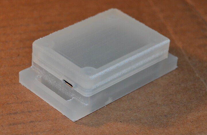

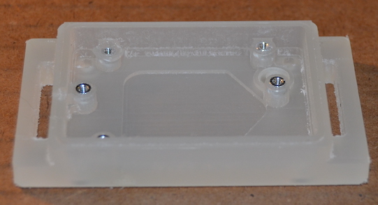

I added a shadow line / lip feature to the lower enclosure and milled it today. It turned out well!
MeshCAM’s “Area to Machine: Whole Stock” helped save time and material. Some material was accidentally removed from the fixture due to a bad z-axis zero.
Looking good. I think most folks have removed a bit of their fixture at one time or another. Fortunately you’ve learned that lesson in a forgiving material :grin:
(I might have accidentally plunged a bit several mm into 7075 aluminum when I learned that lesson :sweat_smile:)

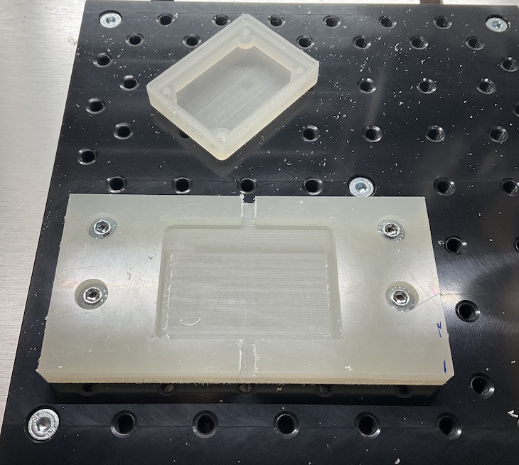

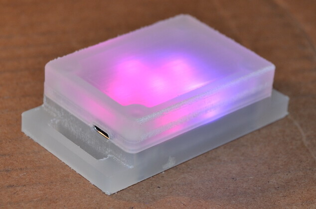

  • Created upper enclosure model with complementary shadow line / lip feature
  • Created a press-fit fixture to hold the work piece and support flipping
  • Milled the upper enclosure, both sides
build day photos
thank you @HeuristicBishop and @Randy for the encouraging words!
You’re welcome :beers:
The heat set inserts being silver is really nice as well, I’ve only ever seen brass for some reason. I might have to pick some up.
Oh or are they just standard nuts maybe?
And the shine through is really nice as well…makes me want to design a track ball with an rgb ring embedded for silly things like lighting the ring in the direction of cursor movement. Too many other projects on the stack though. Maybe someday :see_no_evil:
These inserts are aluminum and very shiny. Stainless-steel is also an option. Brass is the least expensive, but contains lead which is undesirable. ref: mcmaster.com

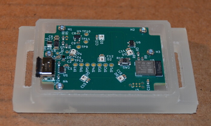

This is my first time using these. Only one boss was melted in this effort :sweat_smile:
Very nice, @andres ! What does this do? With the pentagon of LEDs do you plan to polish the top surface, or is the diffusing part of your desired effect? I do like the very clean design.
Thanks! I designed this as a wearable visibility light. Prototype v1. The front/top of the enclosure acts as a diffuser. The original design intent supports swappable front elements, and I would like to try an epoxy resin cast as well (with the mold cut on the nomad). This build cycle has been educational. Next version will be smaller. :scientist:
The mold could be cut out of hdpe or machinable wax if you’re looking for something quick/easy to cut, cheap to buy, and nonstick to epoxy.
In theory the wax can be reclaimed and remelted to make iterations really cheap but it’s not a straightforward process.
(Delrin also works a treat but it’s expensive. Maybe worthwhile for high usage molds if/when you’ve vetted the geometry with your lower cost molds)
Regardless of your mold material, if it’s rigid you’ll want a bit of draft on the mold. Getting a straight walled part out of a mold can be a nightmare.
