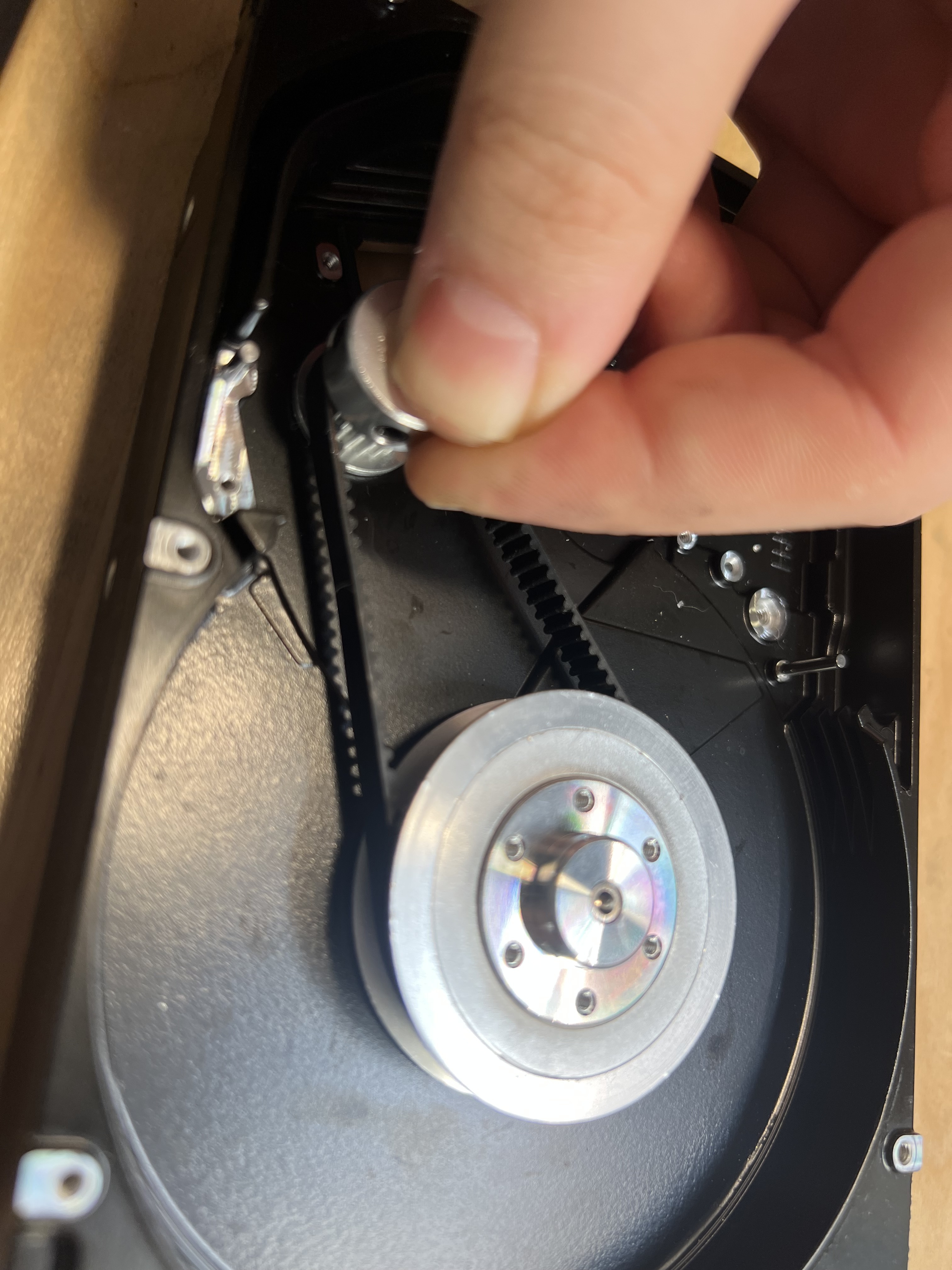

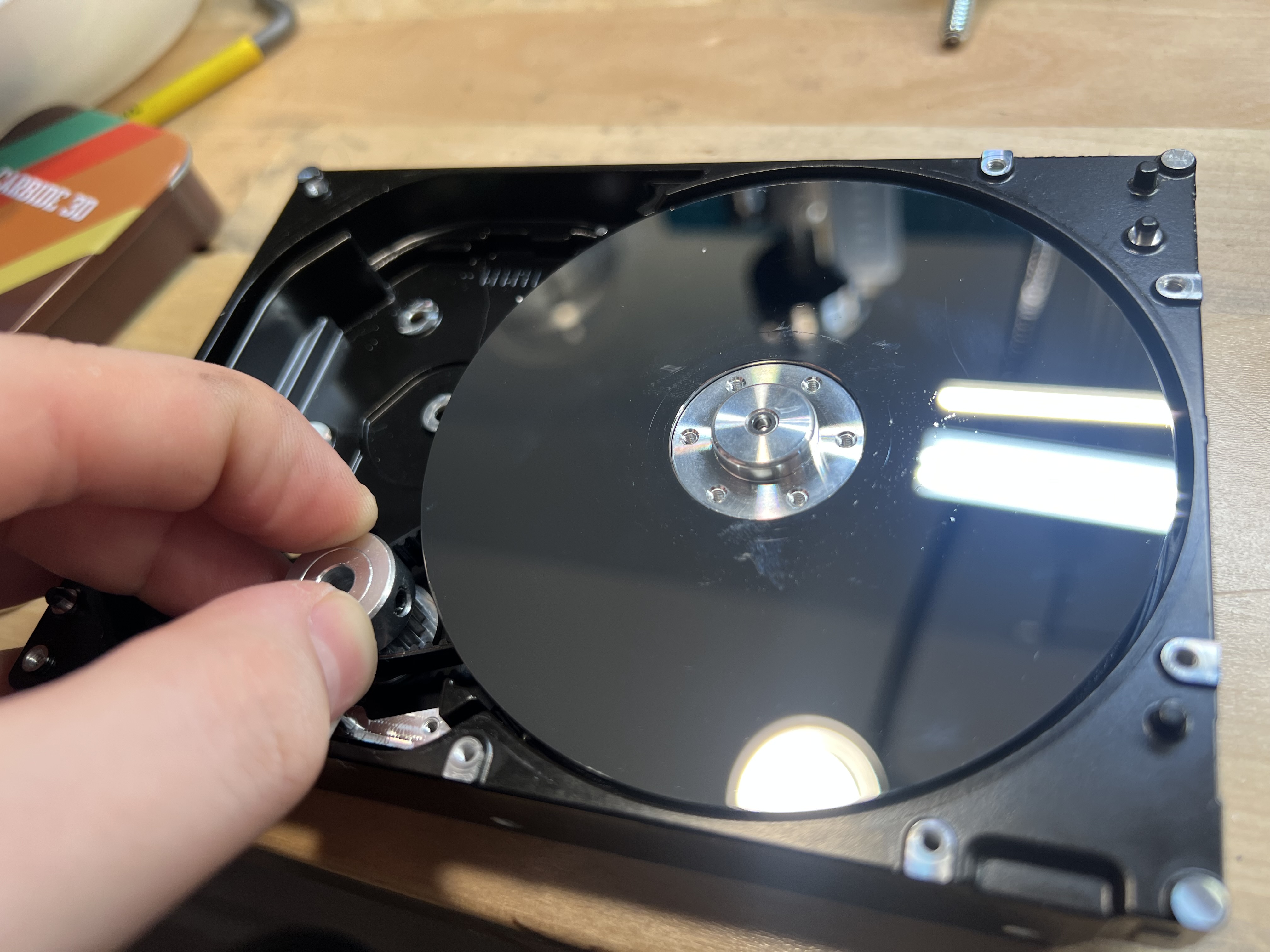

These constrains led me to the 3.5” HDD.
The platters of a hard drive can be aluminum or glass/ceramic. We want aluminum platters. These can be charged with lapping compound to get a good cutting and rolling abrasive action.
The platters are just absurdly flat, probably the flattest commercially produced mass manufactured product in human history.
There are generally multiple platters per HDD which is a nice bonus.
The only problem is that they may have some heavy metals sputtered onto the surface. Platinum and cobalt seem to be common so care must be taken if they are to be used safely.
Cool, that’s the laps figured out, what about the spindle?
Well that’s already answered by the HDD as well! The brushless motor assembly is very precise and fit for purpose to drive the platters we already plan on using. BUT that motor doesn’t have nearly the torque needed for our relatively modest requirements. They generally spin at many thousands of rpm and we’re looking for the high tens or low hundreds of rpm.
Still, I think it’ll make for an excellent stack up if we can drive it with a belt or pulley system.
I spent a bit of time mocking up a test bed and boring out a gear to fit the HDD shaft. It looks promising so far:

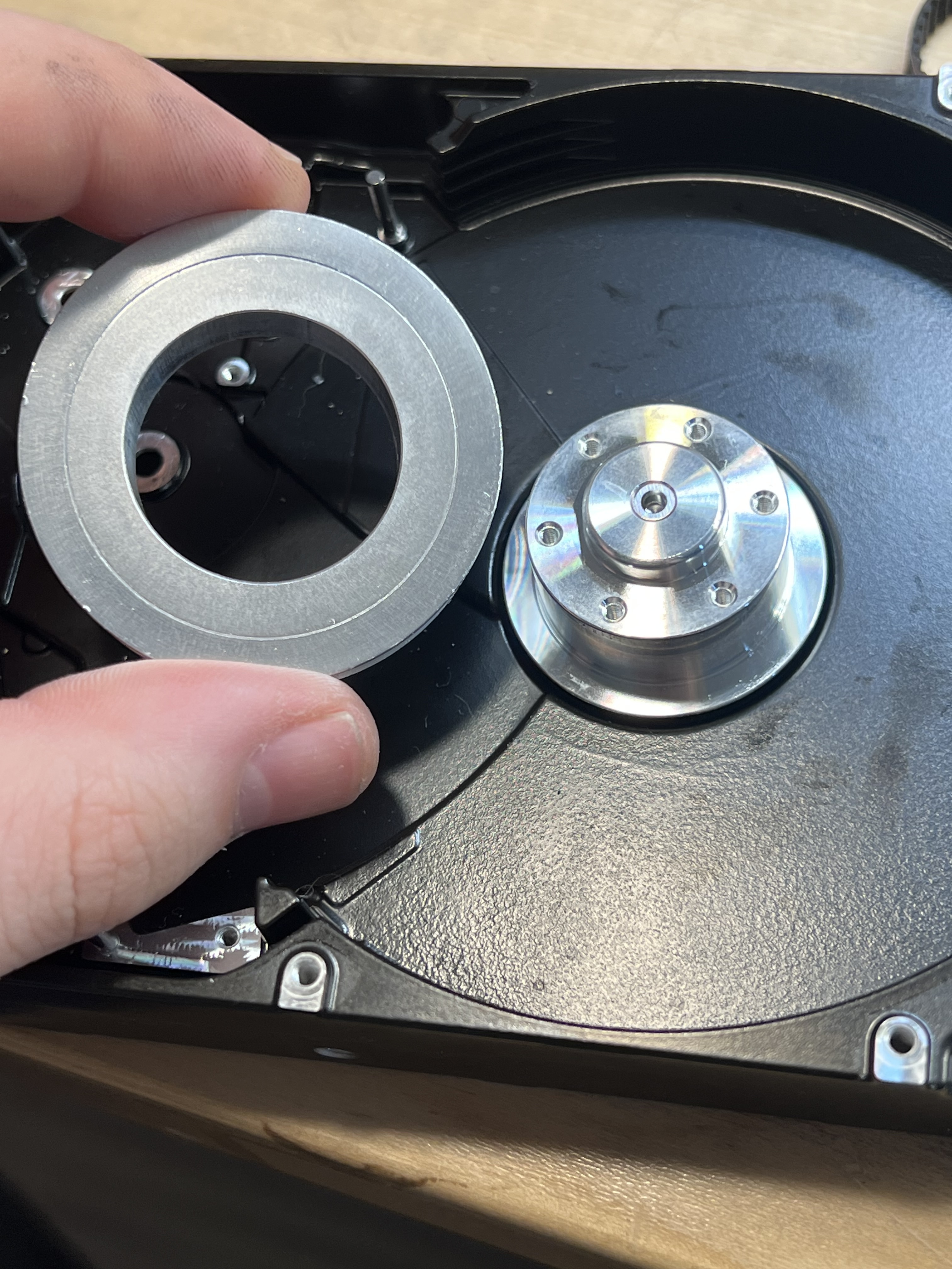

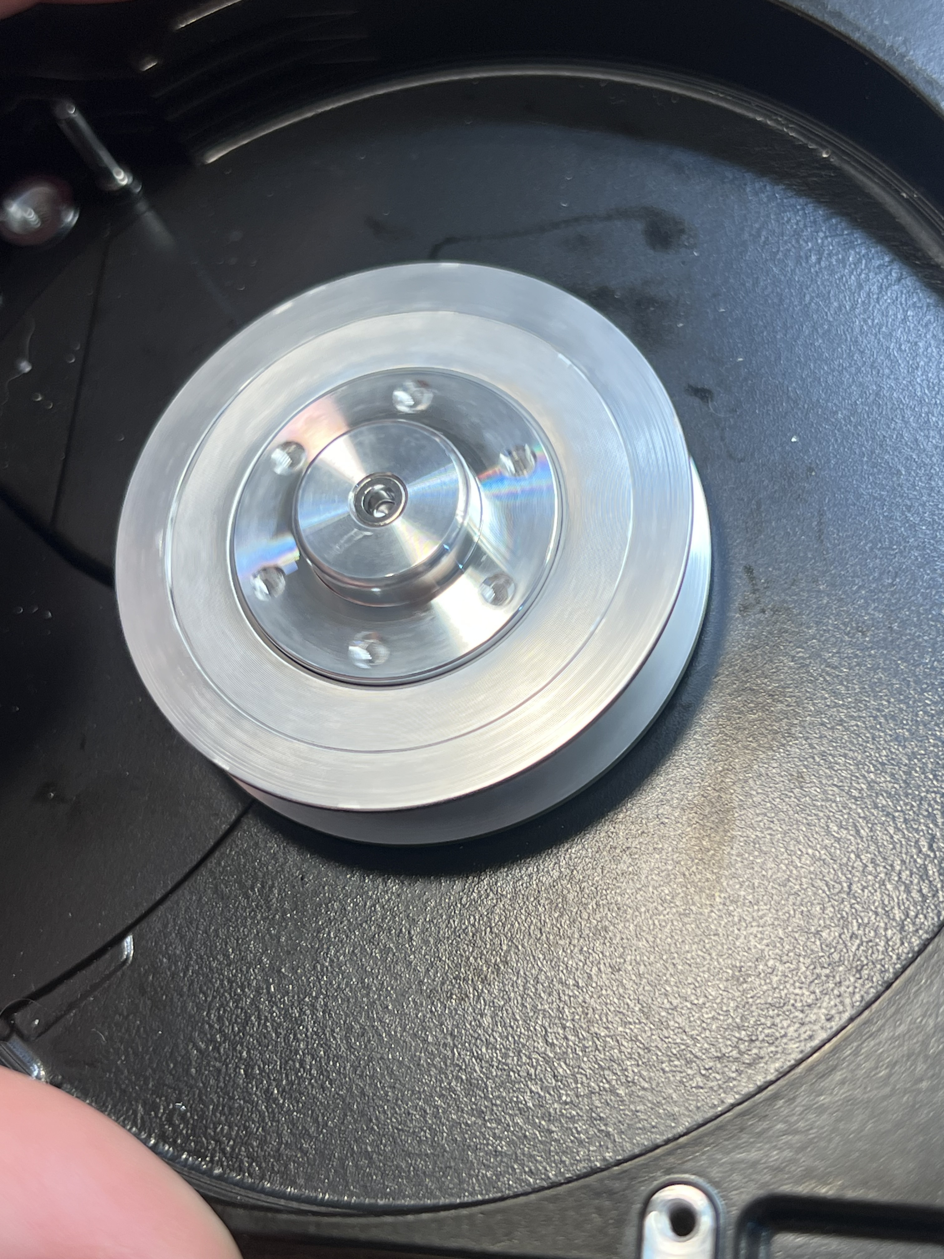

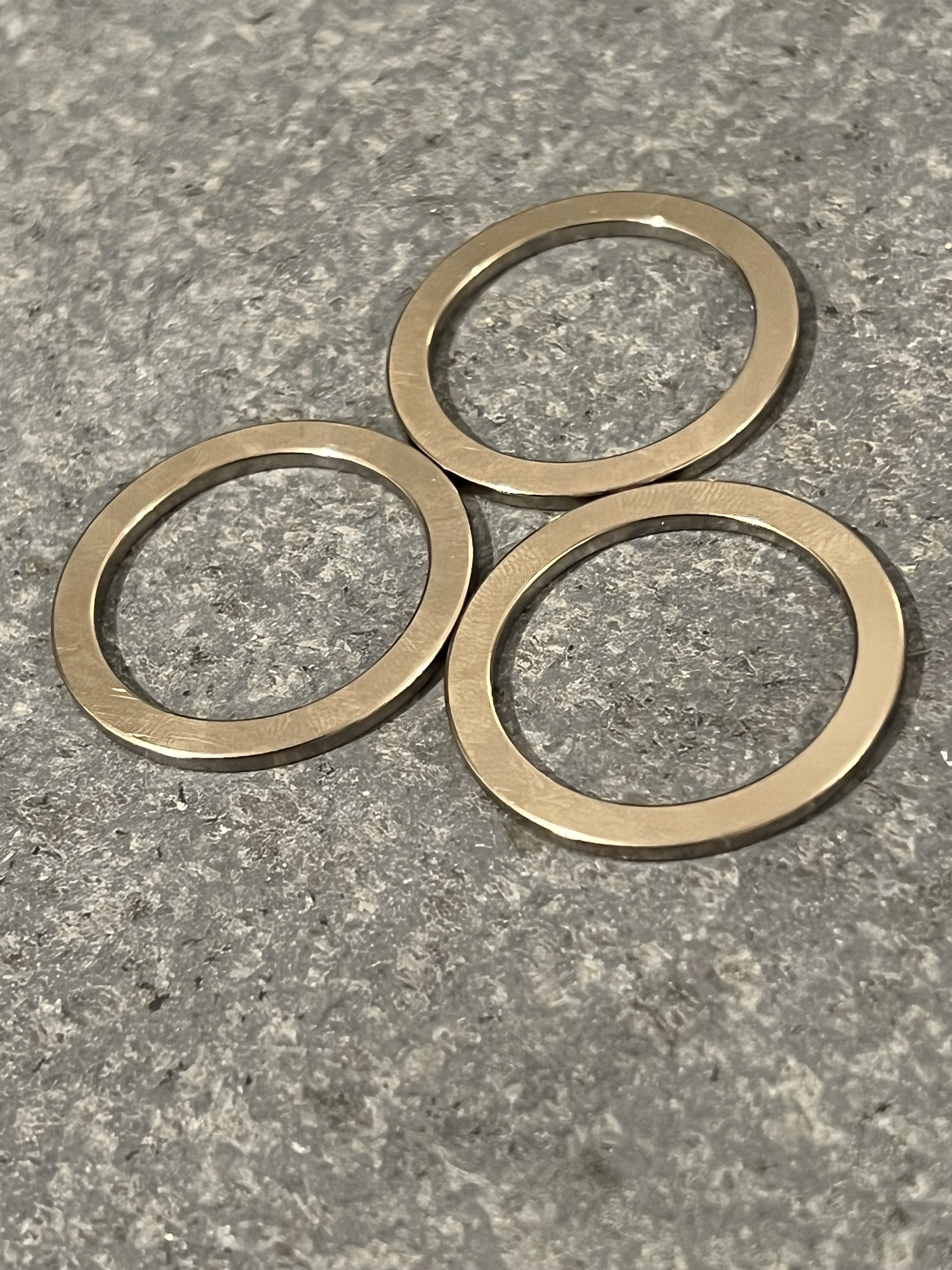

Small update, I got around to measuring the spacers used between platters. As expected, they’re incredibly flat and parallel with exceptional consistency ring to ring.
I’m thinking they could make for decent conditioning rings :thinking:
Though if I end up going with lapping films I suppose conditioning doesn’t matter all too much. It’s coming along, slowly but surely :slightly_smiling_face:
