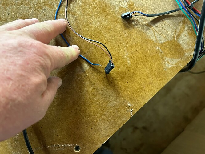

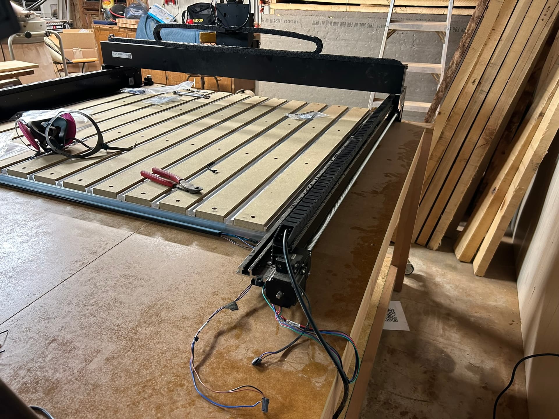

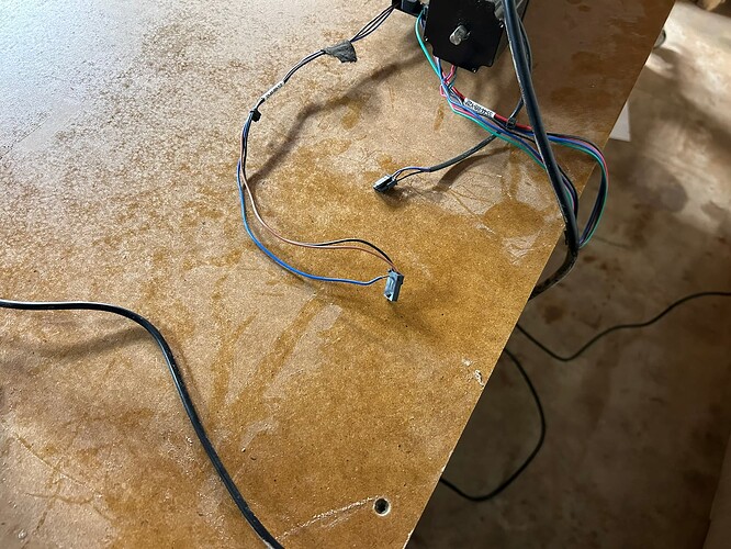

Anyone had any issues with wire not crimped from factory? I have a blue wire pulled or not crimped from limit switch on Left Y Rail
Do you think there would be an issue if i tried to open up the terminal connector and try to fix it myself or should i ask for a new cable from carbide? To be honest i dont think i pulled the cable out and from what i can tell it dont look as if it was crimped to begin with.
The Micro-Fit connectors require special tools to unmake/remake, so please contact support and arrange for a new cable.
Yea wasnt what i was wanting to hear but you are probably right. It kinda sux i have been waiting for my spindle for a couple weeks and it came in today. I just got everything set up and was double checking my wiring so i could turn it on and that is when i seen it. :triumph: :triumph: i wish i would have seen this couple weeks ago!!!
