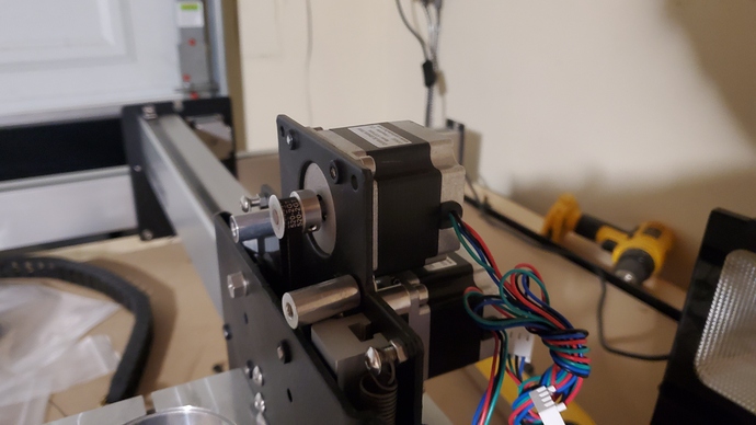

Hello, I have reached this step in setting up my Shapeoko: https://docs.carbide3d.com/assembly/shapeoko/xxl/step-6-wiring/ and I am having some issues.
When installing the X-Axis Drag Chain Bracket I do not have 2 standoffs preinstalled and am not sure if I should use one of the ones in the packaging to make it 2 or if I need that for something else. I attached what it currently looks like.
Davit,
Did you get any forther on this?
It might sound like you are missing some standoffs
  • 4 should be used around the Z pulley to hold the Z limit switch. (2 of these were pre assembled on my machine.)
  • 2 should be used for the X limit switch mounted on the Z carriage.
  • 2 should be used for the Y limit switch mounted on the right Y carriage.
How many do you have in total?
