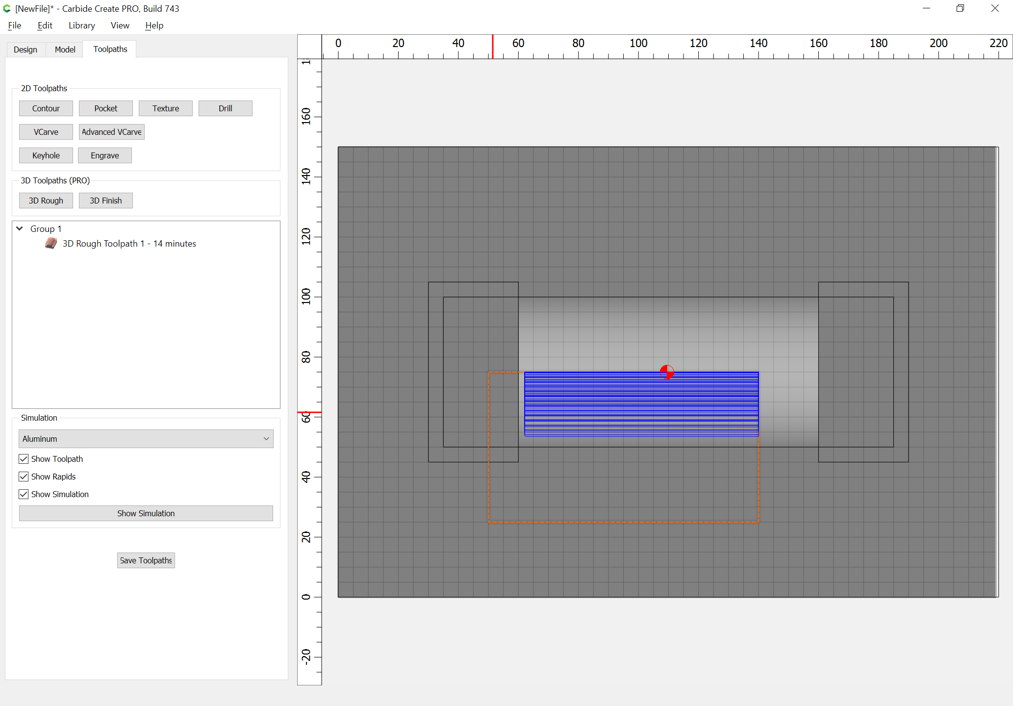

  1. (Pro version) Basic 3D forms like cylinders and spheres, please. I tried unsuccessfully to create a half-cylinder recess in a flat shape, but could not make one with (nearly) square corners. It always ended up with oval ends (way beyond the diameter of the bit, so not that problem).
  2. (Pro version) Some way to export a 3D roughing shape as a set of pockets, so I can clip them to compensate for large swaths of air where my stock is already gone.
  3. (Pro version) Control over the major axis of cut in the 3D roughing pass, beyond what’s possible by physically rotating the stock.

  2. Workaround for this is to make the cylinder longer than it needs to be, then use geometry at the ends to force the height to equal the original height
  3. It should work to draw in geometry which defines where you wish to cut and so limit the 3D toolpath
  4. (and 5.) We’ll put that in and see what the devs think.
Here:
CC_Pro_example.c2d (624 KB)
