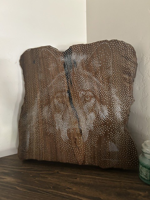

wolf stipple on black walnut slab. Slab was leveled stained, epoxy clear coated then stippled then white paint in the holes and wiped off excess,
New to the CNC world but did teach architectural drawing AutoCad in high school for many years.

Looks very cool! How did you design the stipple effect? Was it an image that was already stippled, imported and then traced?
One way to do this is:
I’m also curious about the stipple. What software did you use to create the stipple? Was this done with a flat mill pockjeting the holes?
file was an Etsy and was machined with a 60deg vbit

Looks as if the tool is now a bit simpler, maybe the help file will be updated presently.
This link works…
https://cutrocket.com/halftones/
