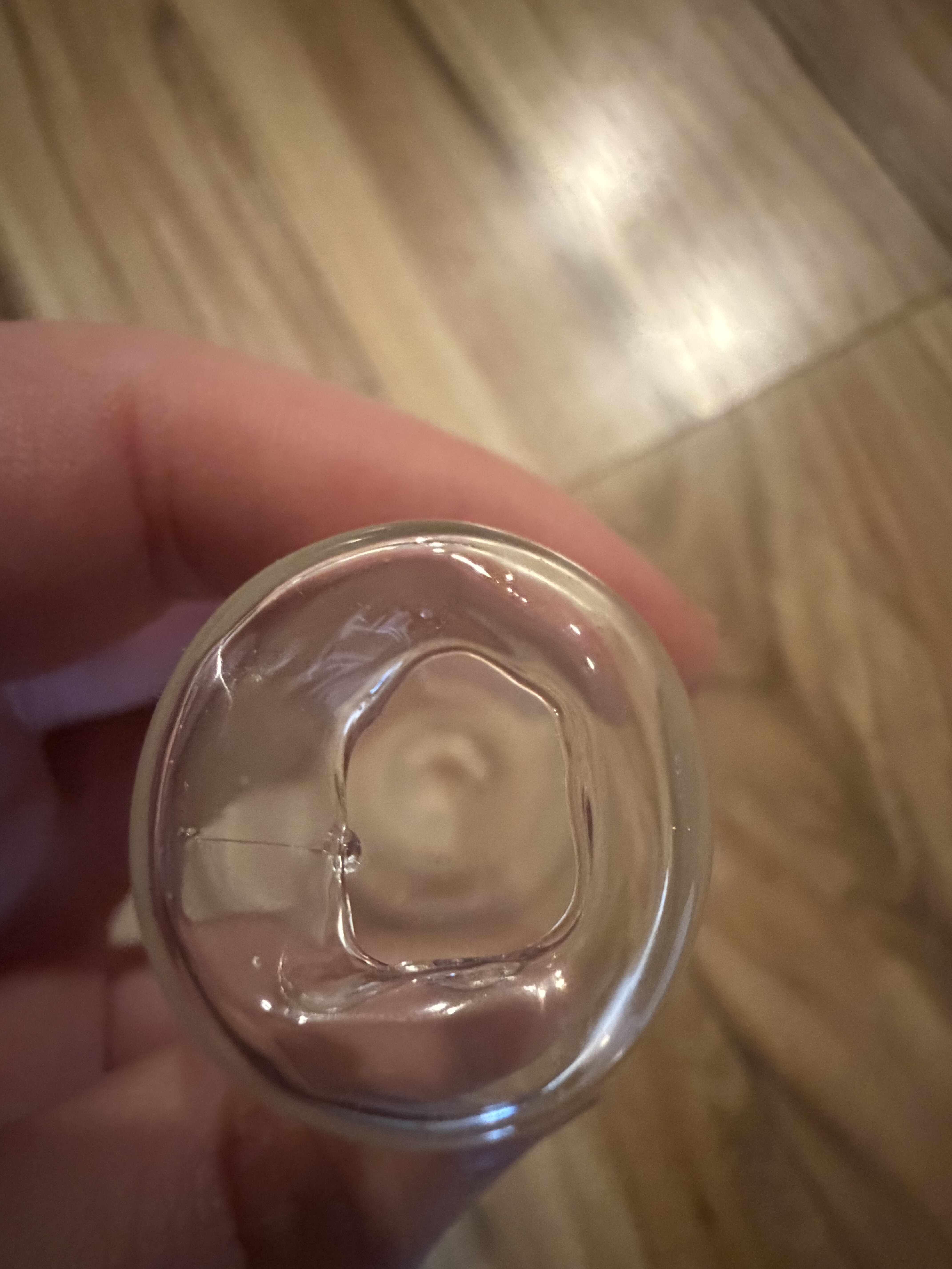

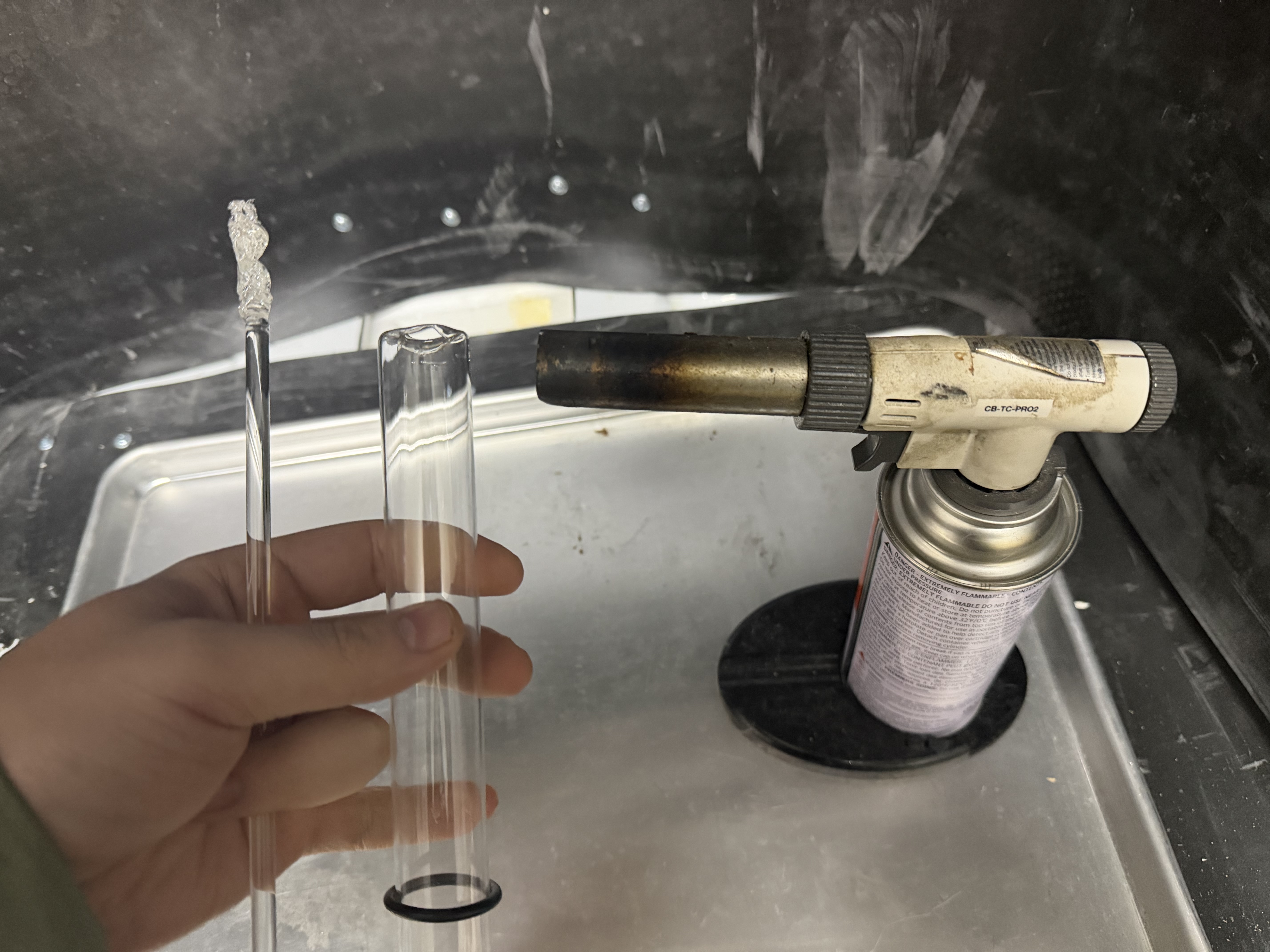

I was gearing up to grind some glass, I’ve done plenty of glass cutting and drilling to be comfortable with it. But then I saw a squirrel…and that squirrel looked an awful lot like a torch.
So I figured I’d try my hand at heated glass working.
Not terrible for a first attempt. I fully expected it to shatter and prepared as much. Full face shield, apron, blast chamber, the whole 9 yards :slightly_smiling_face:
Turns out there was no fuss, it took about a minute, and it worked well enough that it might warrant a metal form tool to poke the hole consistently.

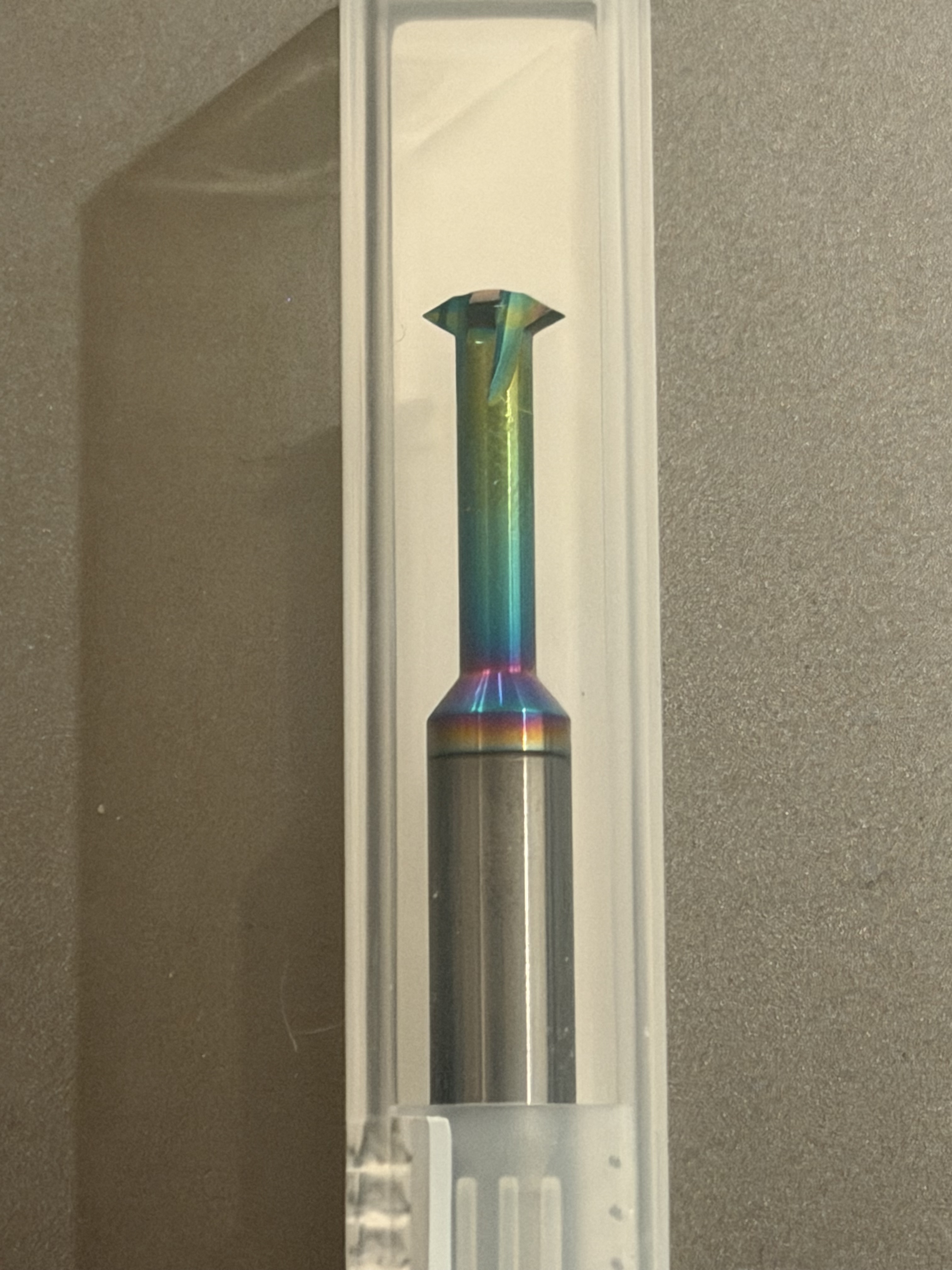

Since I don’t have a proper grooving tool on hand I’m going to try and get away with a large single form threading tool :crossed_fingers:

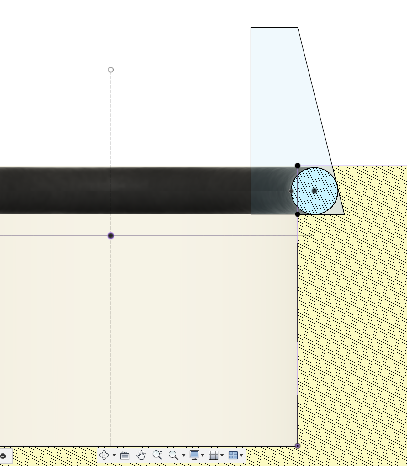

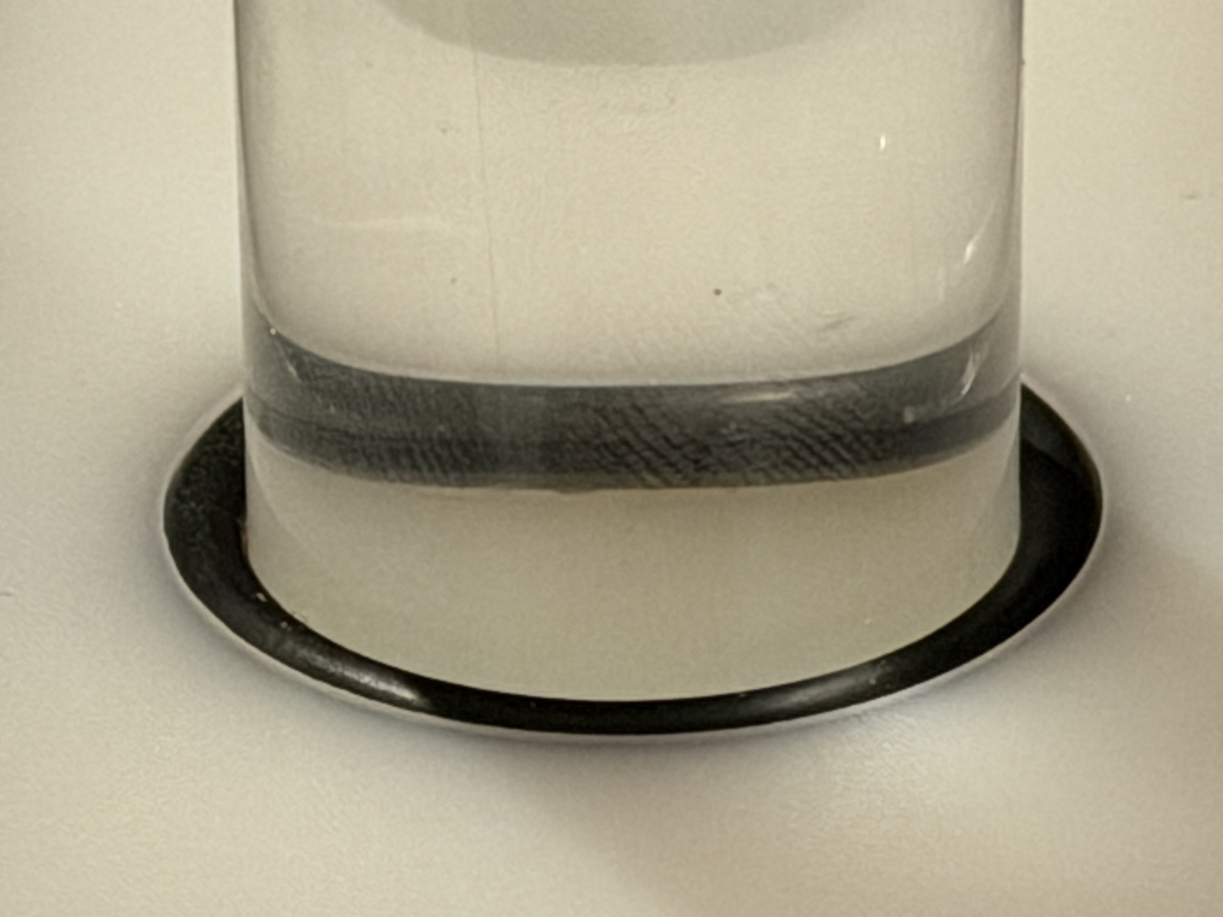

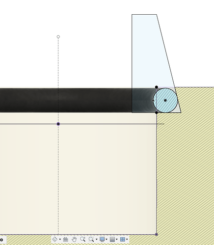

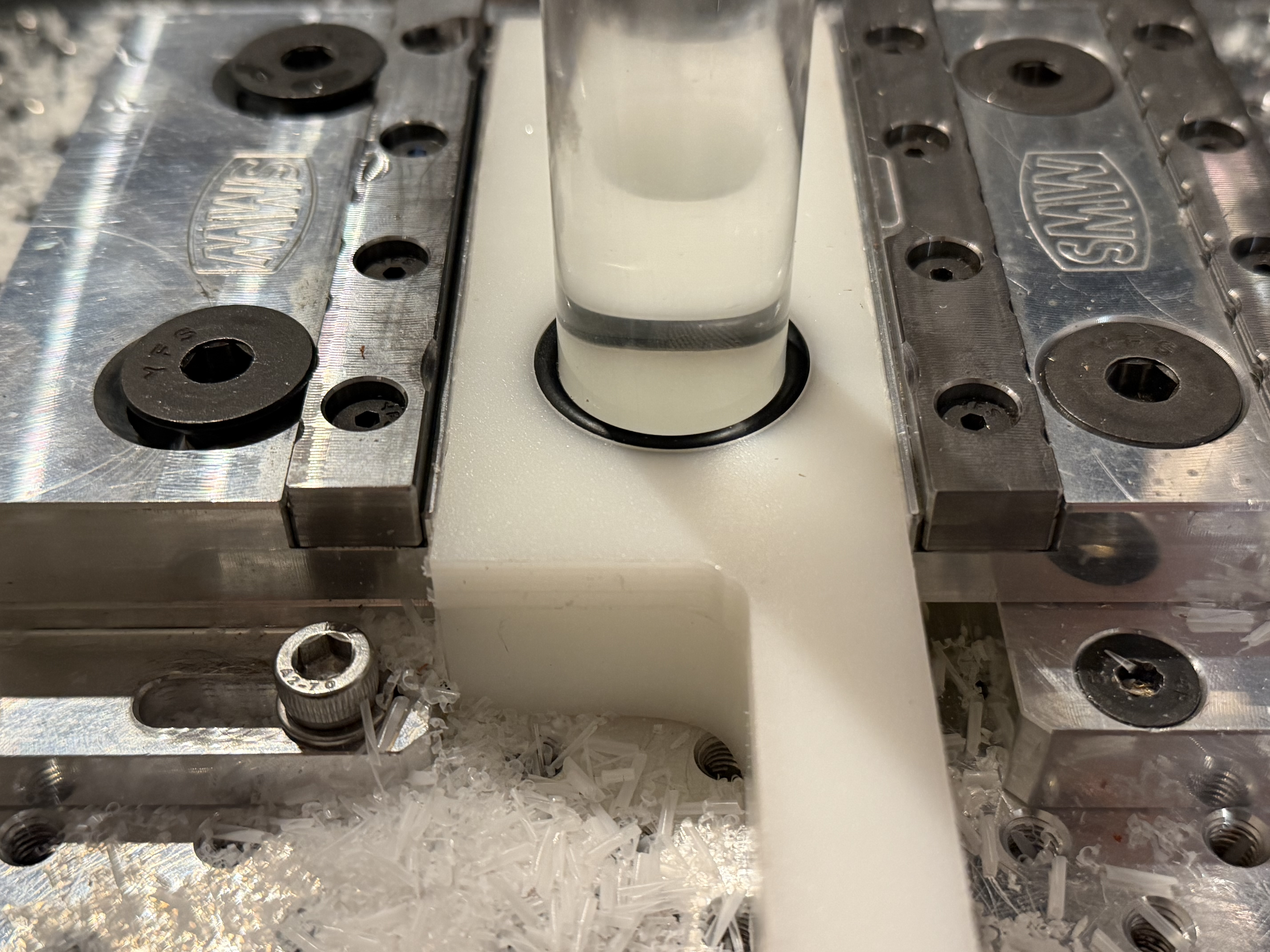

And another small pivot, I tried the 14 degree dovetail as a groove cutter for the 1/8" nitrile o-ring.
It worked out pretty well! There is about 1mm of compression on the o-ring, some of the compression can be in the z axis as the dovetail provides some relief.
Here is a cross sectional view:

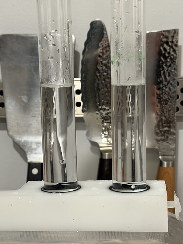

And a photo of the fixture holding water:
This is going to work out just swell.
Water leveling works as expected. For a quick prototype hot glue makes a fine removable drain plug.
Proof of concept is done, not bad for a lazy Sunday.
I mean, it’s not terribly hard to believe that a gasket holds water but let’s still celebrate the small victories :beers:

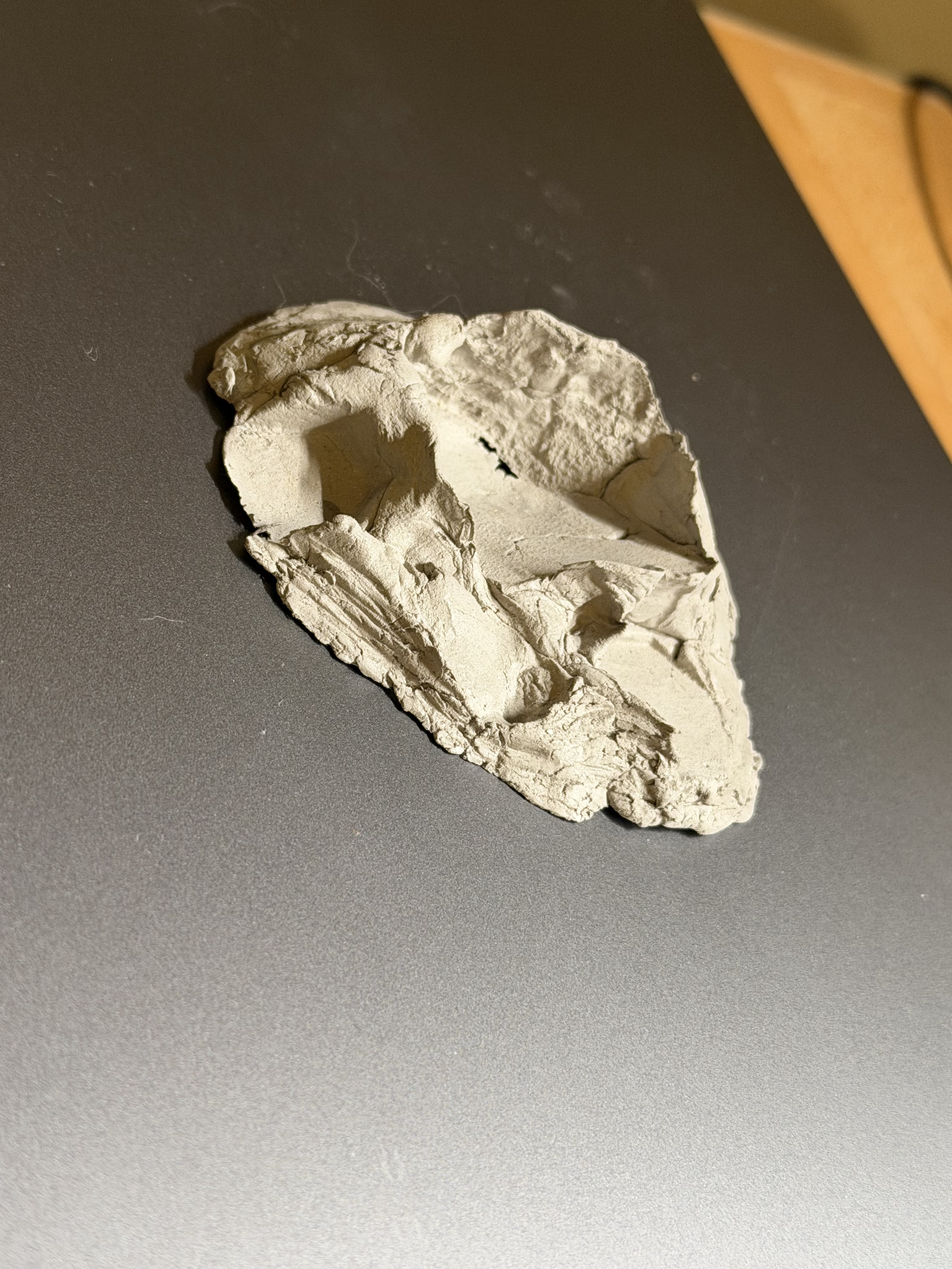

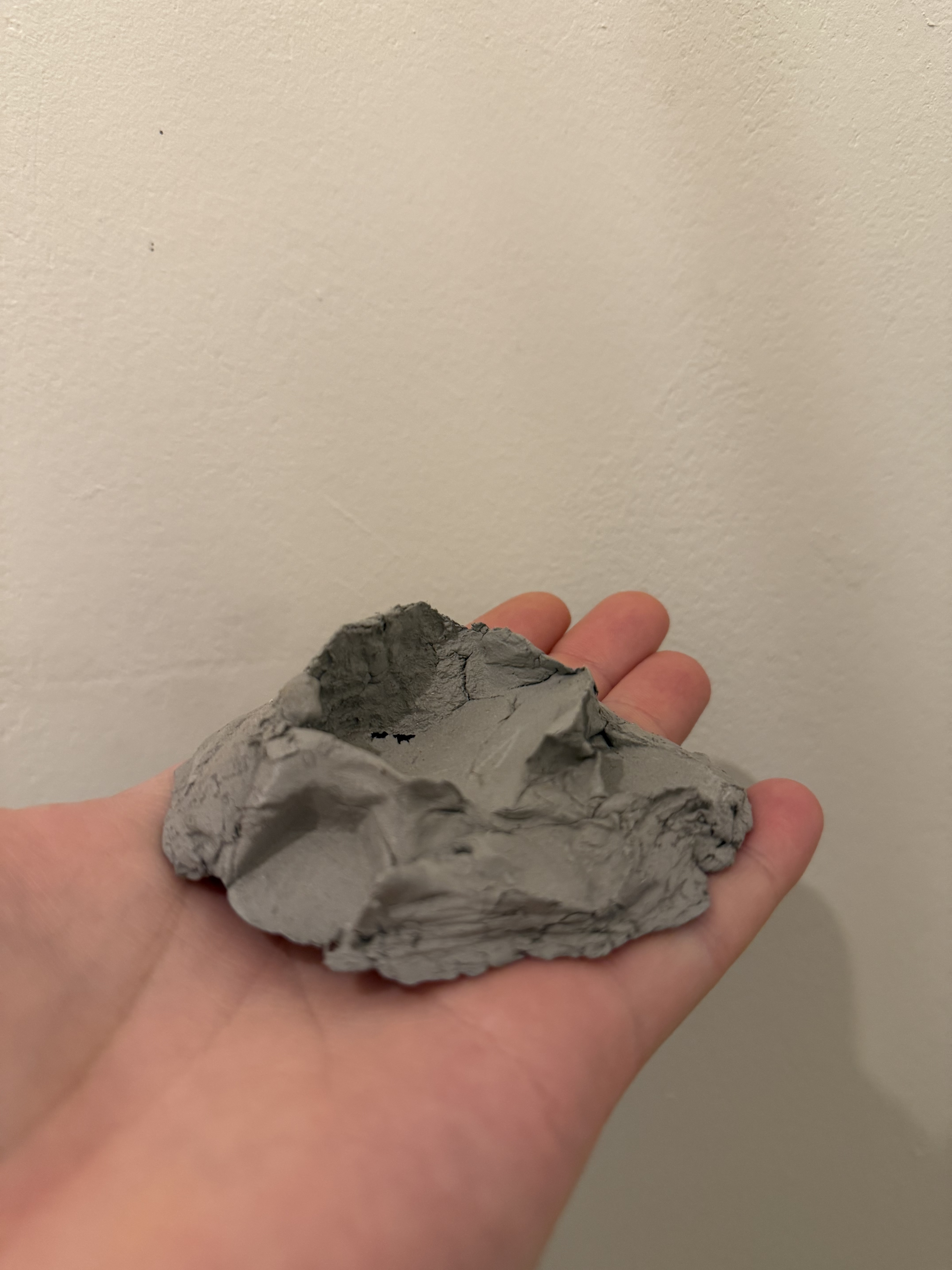

I’ve had good results with das stone modeling clay for small sculpted stonework so I’ll probably use that wherever it’s necessary. Here’s a photo that doesn’t do the product justice but it still gives an idea:

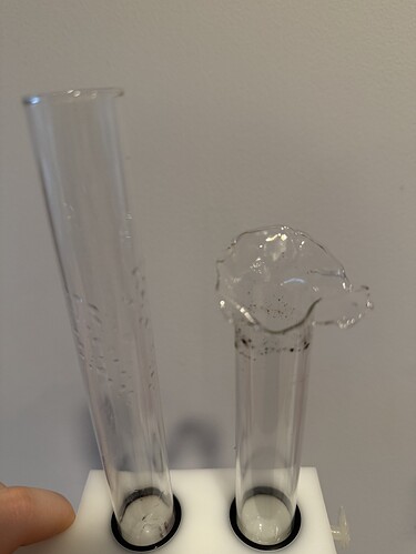

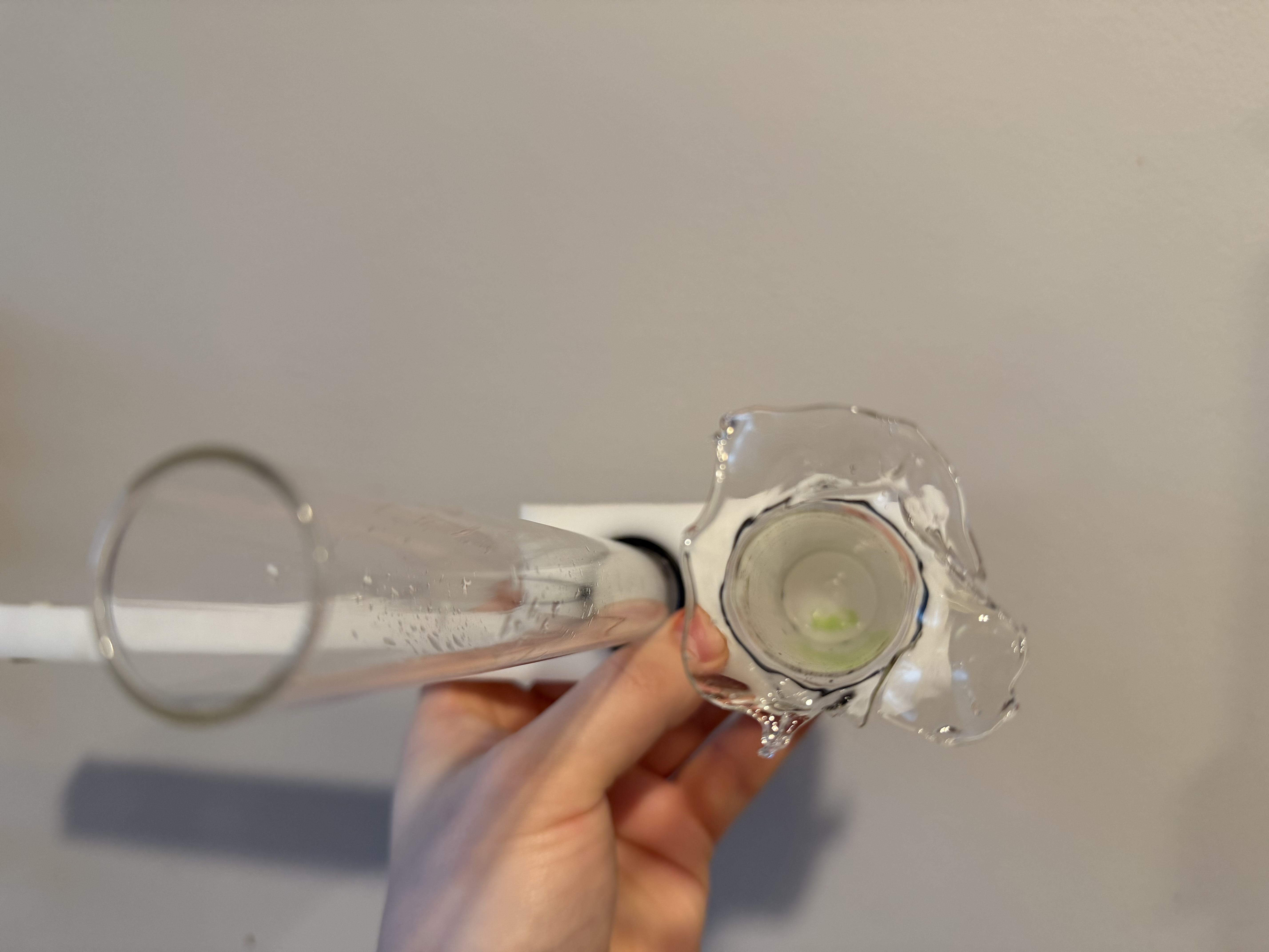

Over lunch I tried to flare the top of a tube to give it sort of flower petals. It went OK for having no idea what I’m doing.
A friend and I going to take some glass working classes in the new year so this will probably become a thing I integrate more often :slightly_smiling_face:
PSA: I’ll say that hot glass is an awful lot like hot plastic when working with injection molds. It looks like a lot of things that you might be used to handling. The comparison most folks use is hot glue.
Hot glue is plenty hot but it’s still somewhat workable by hand…who here can say they haven’t shaped cooling hot melt glue with their bare hands :stuck_out_tongue_winking_eye:
The danger is that glass and plastics look and to some extent behave similarly to hot melt. The real difference being that glass and plastics burn you instantly and can stick to you while continuing to burn.

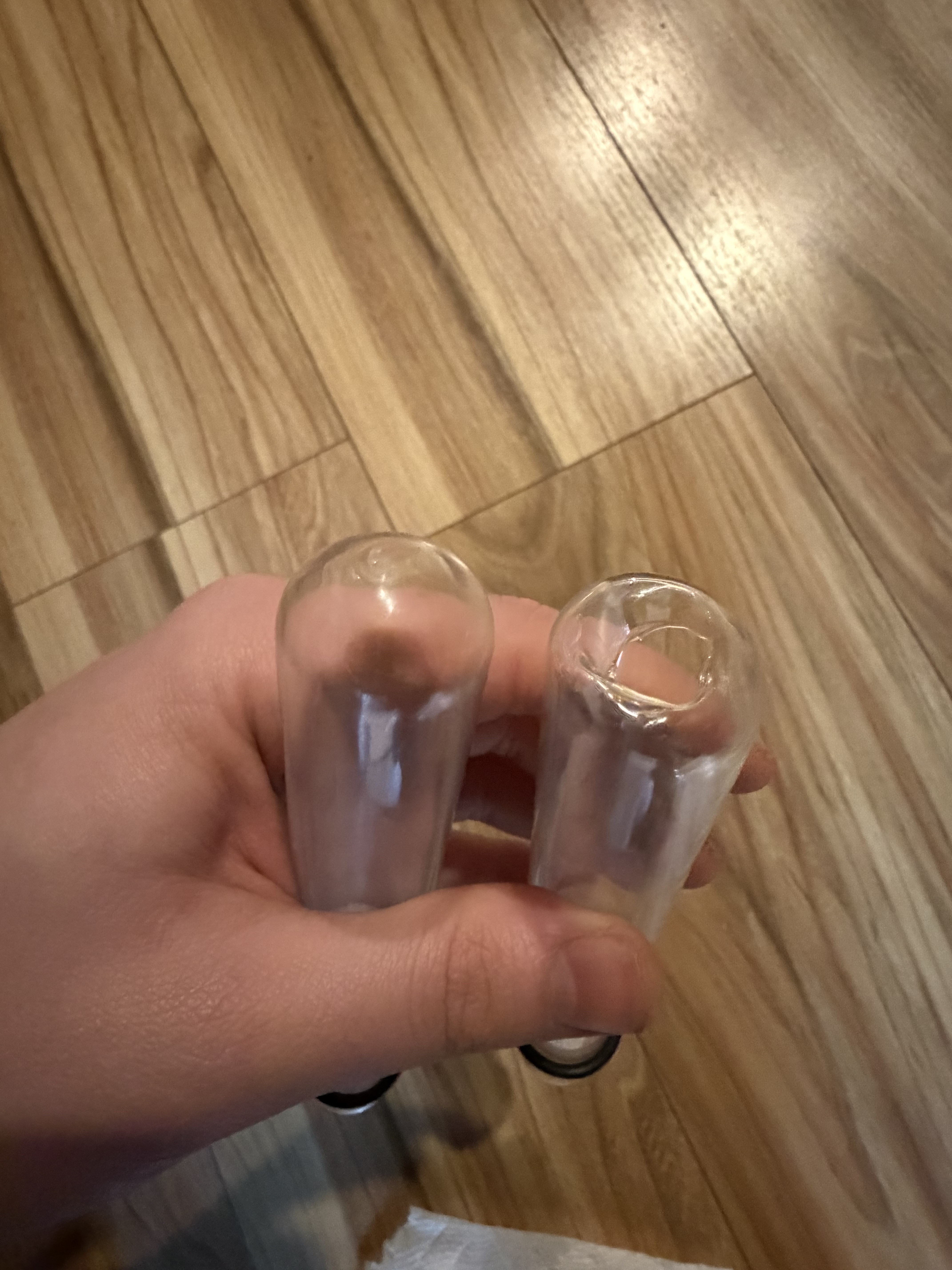

In playing with this flower tube, I cracked a piece of the glass while forming it. The small shard bounced off my hand leaving two instant blisters. (Again, full face shield and apron, I just don’t like gloves if I can avoid them)
I’m not trying to scare anyone away from exploring. Just know what the hazards are before firing up a torch :grin:
