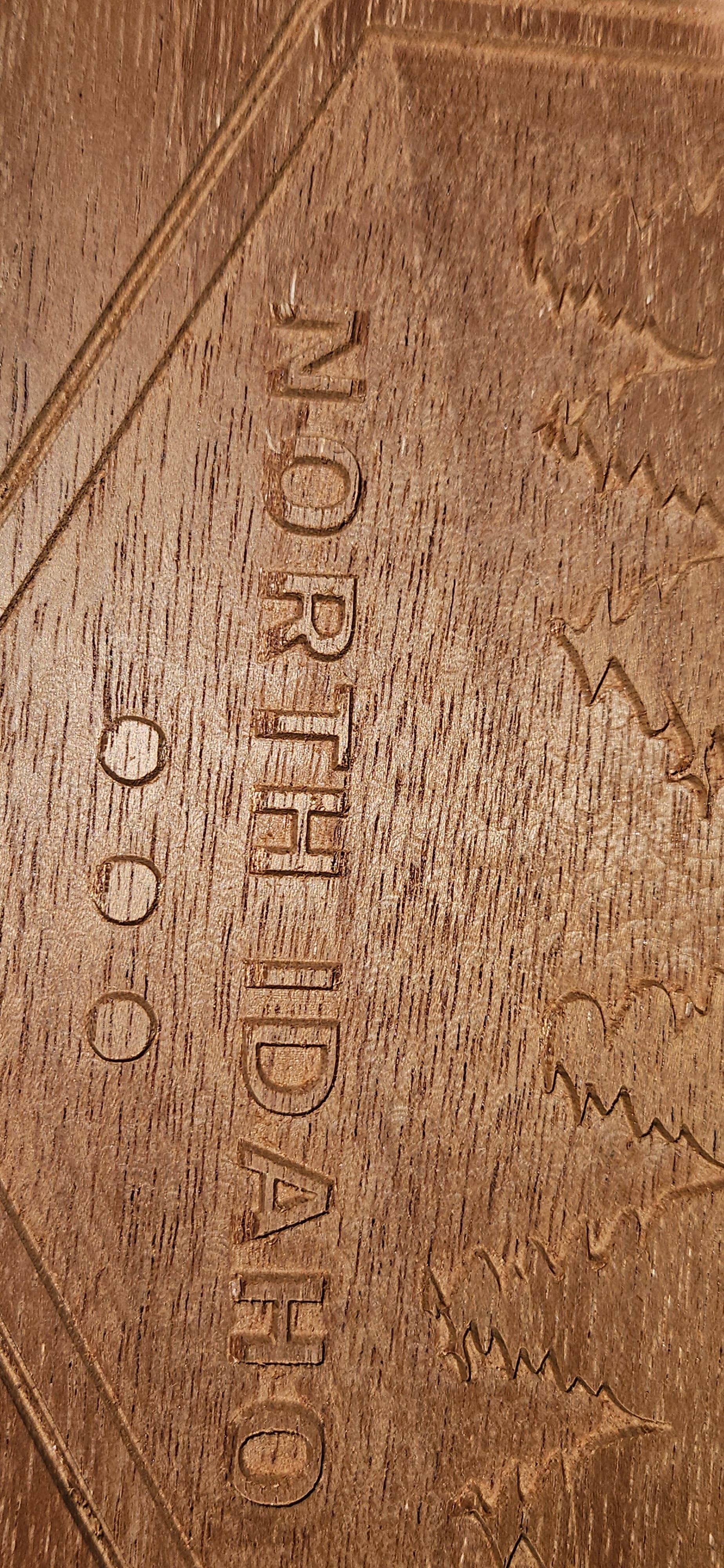

I am cutting a company logo that has raised fonts. I have tried ash, beech, and mahogany, and the grain is breaking around some of the letters.
I have made the fonts as big as I can
What species of wood seens to hold its form the best?

What is the size of the lettering?
What sort of toolpaths have you tried?
Photos of the results?
Where will the logo be displayed?
How will it be finished?
I am using Franklin Gothic Medium Cond, .375 tall with 120 spacing.
I am using a 1/8 bit followed by a 30 degree vee.
Pendorheim Draft 3.c2d (252 KB)
I might try a downcut bit around the text and tree first, then go back with another bit for the flat areas.
Or
Cut the flat area first but leave a border around the text and trees, then use a downcut bit for the remaining features.
I would go even smaller with your bit diameter. Smaller bit - smaller bite. Less chance of tear out.

Your issue here is grain direction and wood types, in order to stop this from happening you should cut with a vee first to keep the structure but that will greatly alter feeds and speeds required for a clean cut, You have to think about the individual fibers and strand/pore orientation and how that affects these small features.
Additionally the Vee is it 2 flute or 4 flute a 4 flute vee is going to have a smaller chip per tooth meaning less stress on the wood you’re cutting. Next is the vee still sharp? Does it have a coating? How many Hours are on it? All of these things factor into how your final product will turn out.
