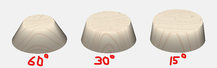

I’m a complete noob so forgive me if this may look very simple but I’m trying to figure out how to design cutting board feet made of Walnut. Please see attached pictures. I’m struggling with how to design the tapers.
Draw two nested circles, set up a V carving toolpath with a suitably acute V tool?
Do a perimeter pass with a V tool which matches the desired angle?
stupid question Will, what v-bit do you recommend based on the picture above? Would you say 60 degrees?
I believe you will want a more acute tool than that.
We sell a 30 degree tool:
but it’d defined as an engraver, see:
(but note that you will need to test feeds and speeds and so forth carefully)
Here’s what they look like with 60°, 30° & 15° Vee bits.

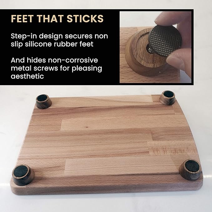

@Tod1d gives some good examples of various angles. However here is some free advise. The feet are on the bottom and no one will be looking at the feet. So why not just have straight walls. If you want a pocket to put your gripper pads a straight wall would look just as good and take a lot less work. Some times we cannot see the trees for the forest.
Which ever design you go with use stainless steel screws. You should not be putting a cutting board under water or in a dishwasher but it is subject to getting wet. A regular steel screw will be hidden from view and might just rust away over time.
Most cutting boards are made of hardwood. So when you predrill for your screws be sure to put a stop or some tape on your drill bit so you dont accidentally drill through to the top of the cutting board.

One other idea: You don’t need to model the tapers at all, or even use V-carving. Just chuck a skinny tapered endmill in the spindle and tell the machine to do a contour cut (no offset) around the walls of the foot. The tool will naturally leave a tapered wall.
I just assumed ~anything cut with a v shaped tool was v-carving :person_facepalming:
Tapered mill and a contour is what I’d do as well. Use the same mill for the rubber foot pad to save a tool change…I bet the slight angle is basically imperceptible at the depth of the pad

I recently used this kind:
Google Photos
but they are not really cheap! appr. $5/piece

I usually use threaded inserts to attach them, so that one can remove them easily without wearing out the hole for wood screws.
