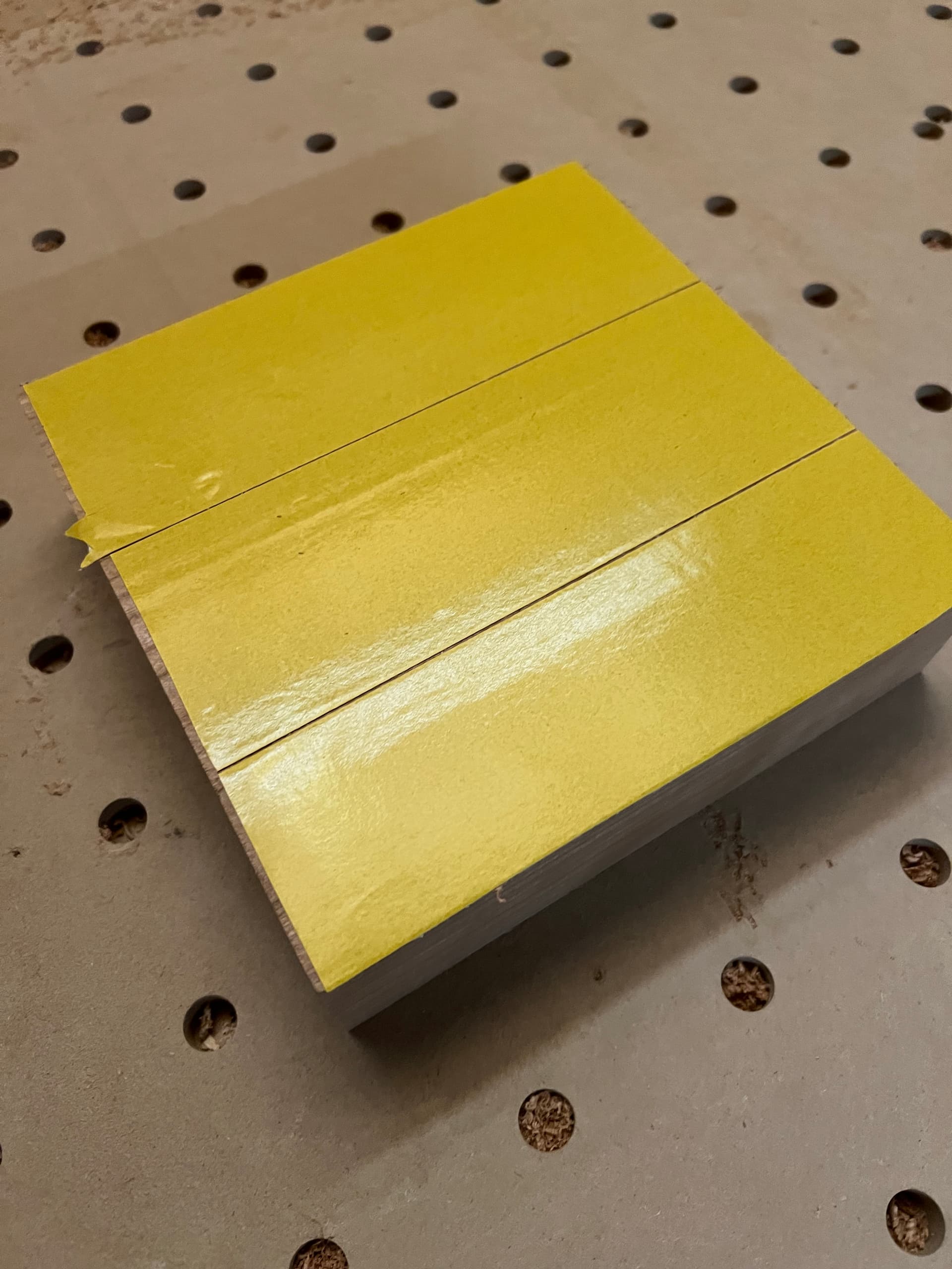

Currently, I flatten one side of the work piece either with a planer or with the CNC itself. Once one side is flattened, I double check for tram, hit it with a sander if needed, and then completely cover the flat side with XFasten Double Sided Tape. I then stick the work piece to the spoilboard and sit on it. Or put a big lump of lead on it.

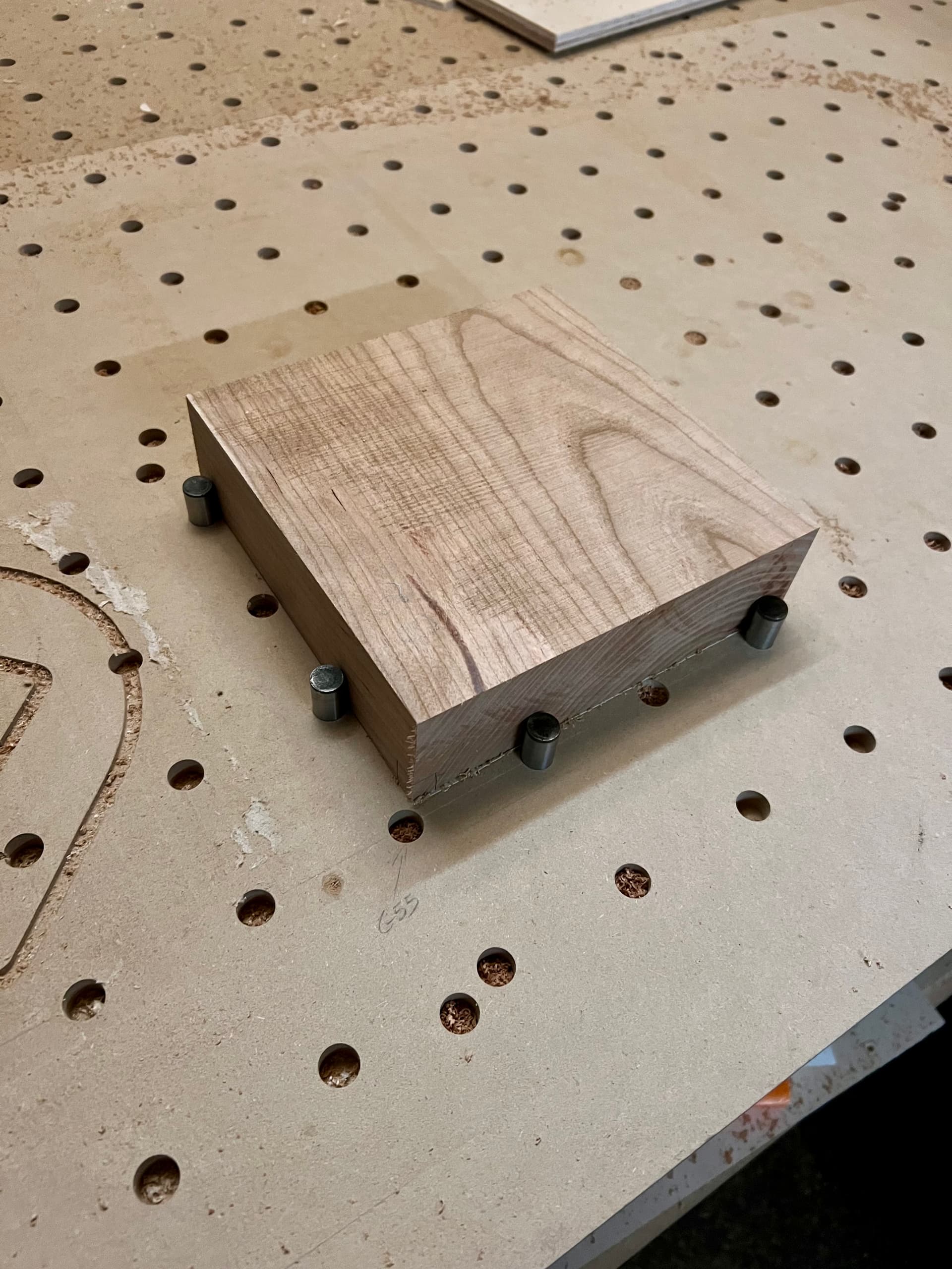

Here you can see the application of XFasten’s tape to a 181mm x 181mm chunk of cherry.
I locate the work piece on the spoilboard using some fixturing pins. When I’m actually ready to work (not at the moment), I will have stuck the tape down at this point. Usually I’ll put some weight on it or just sit on it and check my email (if it’s big enough) for a few minutes.

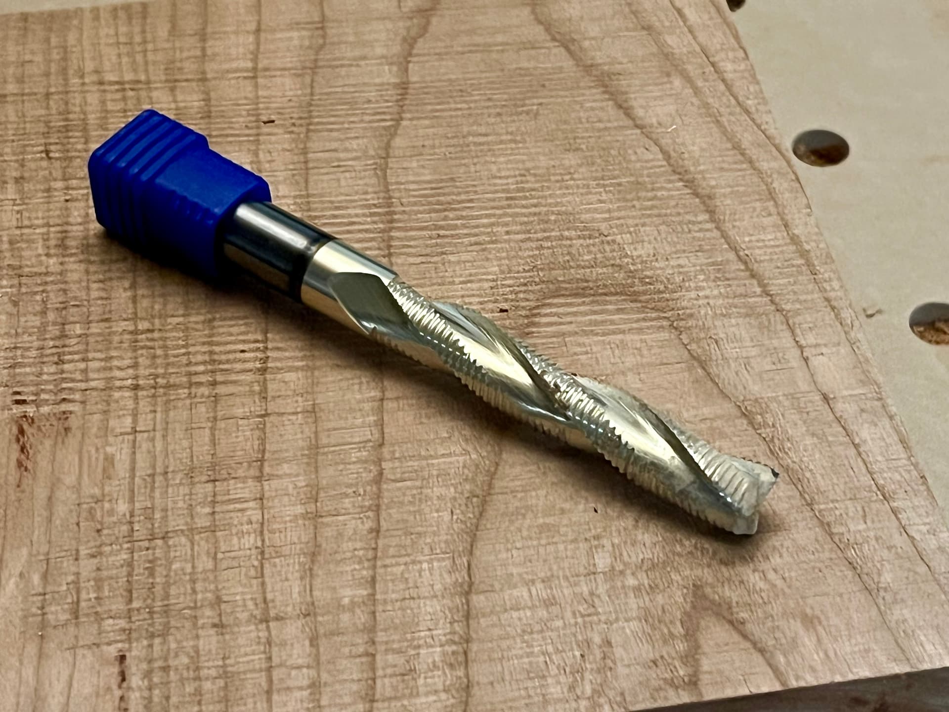

The tool in question. Recommended settings are as follows:
  • Spindle Speed: 18000 rpm
  • Feed Rate: 300 in/min
  • Plunge Rate: 200 in/min
  • Stepdown: 0.5 in
  • Stepover: 0.3 in
  • Chipload: 0.0056 in
I’ve kept the chipload at approximate 0.0056, but I’ve lowered other settings to get there.

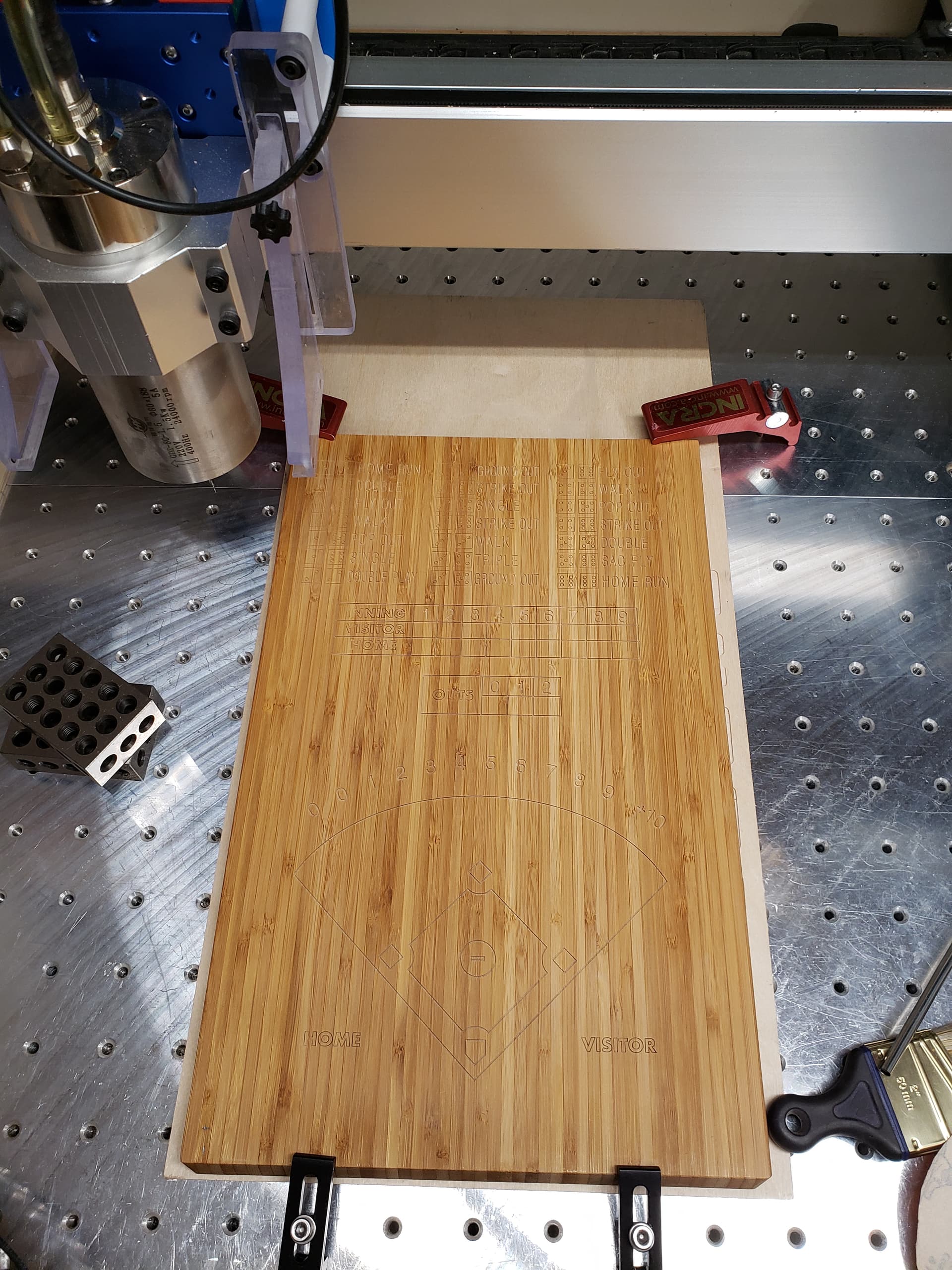

I started my work holding journey before Carbide got into the game, so I use - depending on the size of the stock and how much edge margin I have to play with - the following:

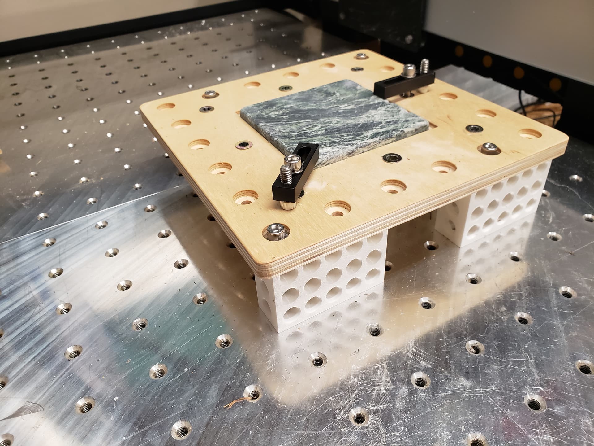

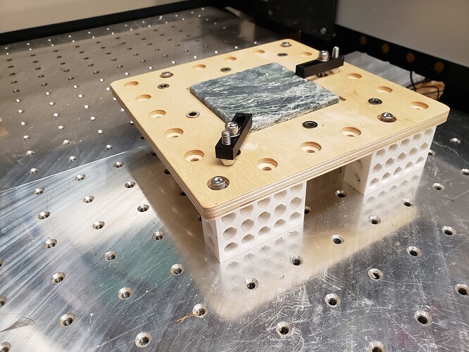

Note: I am using 1/4-20 SHCS and an aluminum spoilboard with threaded holes every 1.5"
Incra Build-It clamps for larger stuff.

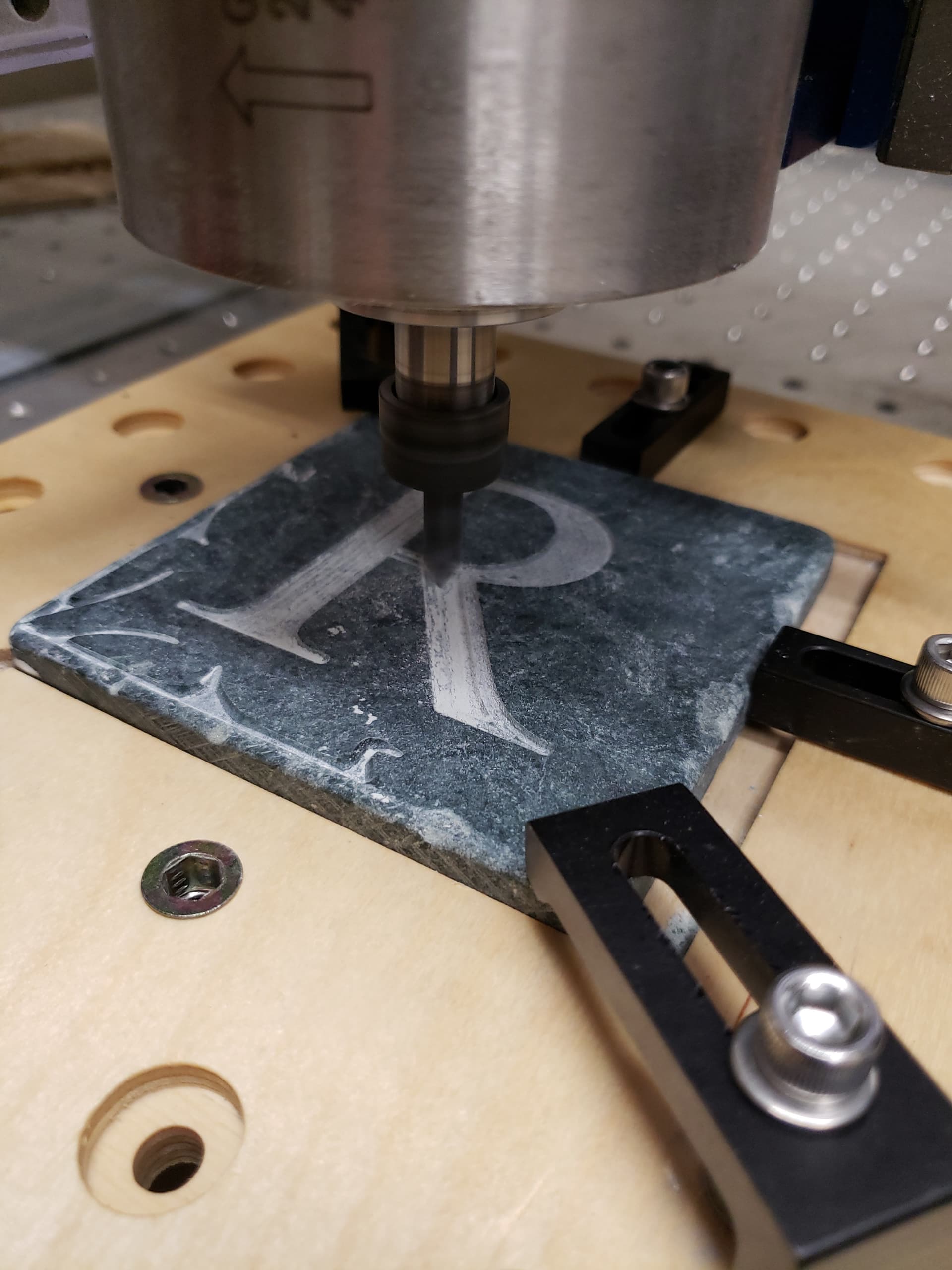

Thorlabs CL2 clamps, CL3 clamps and CL5A clamps. The Thorlabs clamps come in both 1/4-20 and M6, so if you are metric, you can stay metric with these clamps.
This is the CL5A clamp in the foreground and CL3 clamps in the background.
One of the things I like about the Thorlabs CL2 and CL3 clamps is the threaded hole allows me to clamp parallel to the stock surface no matter how thick it is, because I can put in whatever length SHCS to compensate.

I have a beefy L bracket for the front left corner for repeatability that I made with the CNC. I use the clamps in T tracks that came with the machine. I’ve never had any issue (other than cutting a few clamps). These clamps have good holding power for my type of work.

Here’s what I have learned over the course of experimentation today.
TL;DR - if you are using double stick tape, go slow, be careful. Remove less material at once.
Tool paths
My tool paths are too aggressive for my work holding technique (double-stick tape and hope).
What I did
I reduced depth of cut and feed rate and stopped having the machine yeet the work piece into next year.
  • Feed rate was reduced to 120 inches / minute.
  • RPM reduced to 12,000
  • Depth of cut reduced to 1/4"
  • Step over remained the same.
End result
  • Better cut quality.
    • Minimal chatter.
    • Minimal swirly marks that will need sanded off.
  • Work pieces stayed on the spoil board.

Double Stick Tape; Love it. I use Nitro Tape, works great.
I clean my spoil board with a bit of alchol on a rag. Tape on Spoil Board, part squared as I place it down. I first used a 20 pound sand bag to apply force on my part, then parts got bigger. Now I just firmly push, rub, or smack my part several times,
Never ever had a failure, and I push it with 100 ipm or more.
Only issue I have ever had is with soft wood breaking when I pull the part off the tape. Solved that with string to cut the tape loose.
