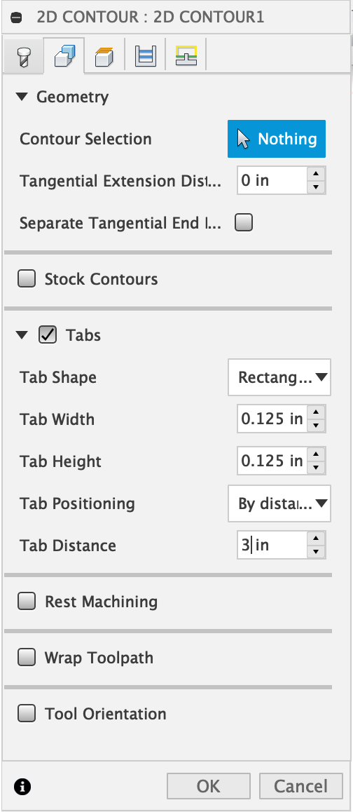

I wanted to add a couple of tabs to hold my SCD test that I am trying to setup in Fusion 360. It appears as if the tabs must be created in the model itself. Is that correct?
2D Contour CAM operation has the tab functionality in Fusion 360
I do not have that option (I am using a 3D Contour if that makes any difference)

No, 3D contour doesn’t have the capability to do tabs. What design features does you part have requiring a 3D Contour op? A picture of your part could be helpful, if possible.
I’m still learning the differences between the CAM operations, as some can overlap in milling specific features and providing variables and differences in functionality, machining time, finishes, etc. I typically do a 2D contour with tabs as my last operation to cut out the part from my stock.

2D contour has the option, as the 2D contour can be used to, and is in part intended to, plow a uniform depth groove in your stock. Strategies that would not generally be used for, essentially, cutting a part free of surrounding stock do not have the option.
If you want to use 3d contour and have tabs or support, there are three easy options:
  1. add tabs to the model. They are not critical, as they just need to extend far enough into the unmachined base stock that the part remains attached.
  2. set your bottom for the 3D contour to be your tab thickness above the material bottom, then run a 2D contour with tabs to finish the cut
  3. set your bottom height for the 3D contour a small bit above the material bottom and leave the part attached by a skin, maybe 0.2 to1.0mm thick (depending on the material and what you are machining)
In a case where I want to leave tabs (or a support skin), I will sometimes do the profile cut in stages, or do the upper portion with a different strategy, early in the machining process, so there is clearance for tool entry and chips to get out. Then, the last operation is the final depth on the profile cut.

i’d opt for number 2 typically.
also keep in mind you can utilize stock to leave on 2d contour to rough slot. (leaving clearance)
then, you can duplicate the toolpath and clean up the part to size without bouncing off both sides.
