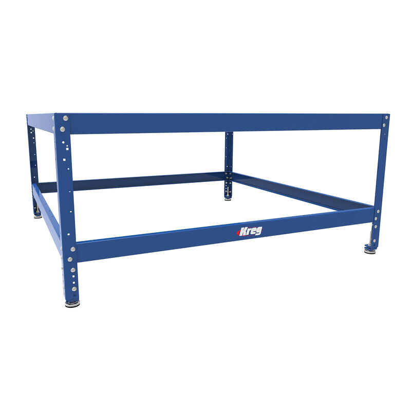

Just took delivery of a Pro 5, very excited to jump in. 23 year 3D professional with AD’s 3D Max and Fusion so no learning curve on the Carbide software.
What size tables do you use to hold your machine?
Since the foot print is 5’ x 5’ , I thought I’d do a 42" high table at 6 x 6 so I could get around to each side.
Not sure I want to cut the two 8 foot posts in half, 48" might be too high?
I’m thinking 8’ long will get me further away from the front than I want to be.

I’m still waiting for mine to be shipped. But making the table now. I’m doing mine at 62"X62". I’ll build another table that will sit next to it that will have the computer and storage for endmills and stuff.
48" high seems pretty tall to me. I want the work surface to be about 36". That will match the rest of my work benches and tables in my shop.
Quite a few people have ordered the Kreg 64" X 64" metal table and used their own material for the top and/or shelf. Just reinforce the top so the heavy machine does not sag over time. You can certainly make your own using 4x4 and 2x4s but the cost is relatively the same getting the Kreg but you can calculate that price. I would definitely put wheels on it. Everything in my shop is on wheels and it makes it much easier to do maintenance and cleaning and if you decide to reorganize it is easy to rearrange things.
On the kreg.com site the 64" x 64" table is $369.00 but I think you could shop around and do better.
If you do get wheels get ones that lock in both directions. There is a lot of momentum on the table with the heavy machine and rapid movements.
The wheels are $69.00 as of today on kreg.com
Thank you Steve and Guy!
WHEELS! Yes for sure. Going to Home Labyrinth later today for locking versions.
62" x 62" sounds interesting Steve.
And yes the Kreg table looks sweet Ill keep my eye on it for the next table. hope i need it soon. :slight_smile:
Thank you gents.
