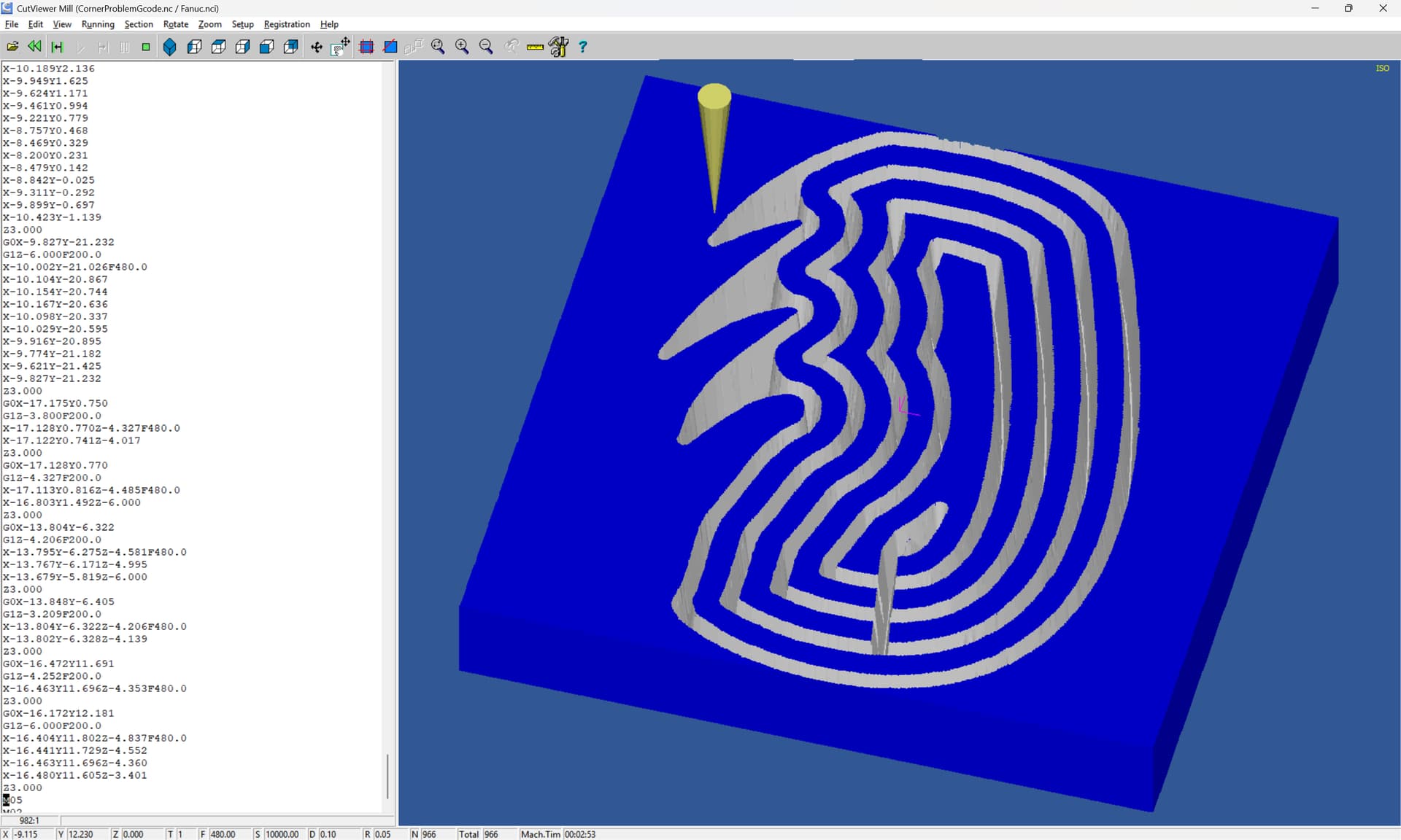

here’s part of the Gcode i’m using, it seens to be making holes where corners should be :thinking:
CornerProblemGcode.nc (14.5 KB)
There are no plunges that are disconnected from the rest of the shape, so I’d check that your Z zero matches what you programmed in the file.
I see from the support system that you’re running a machine you made yourself, so I’d also check that the axis movement is correct and nothing is jamming up.
If you preview this in a tool using a tool which matches what Carbide Create expects to be used you get:
