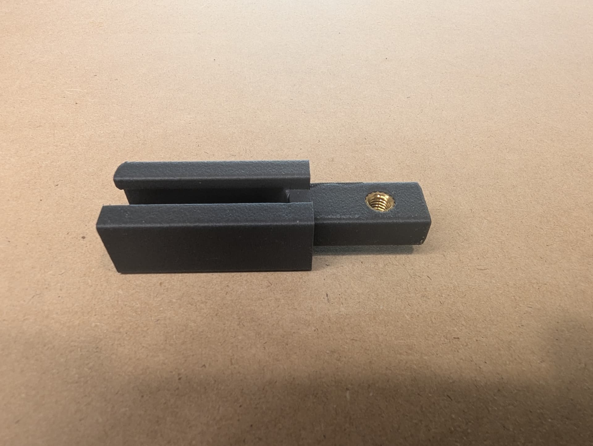

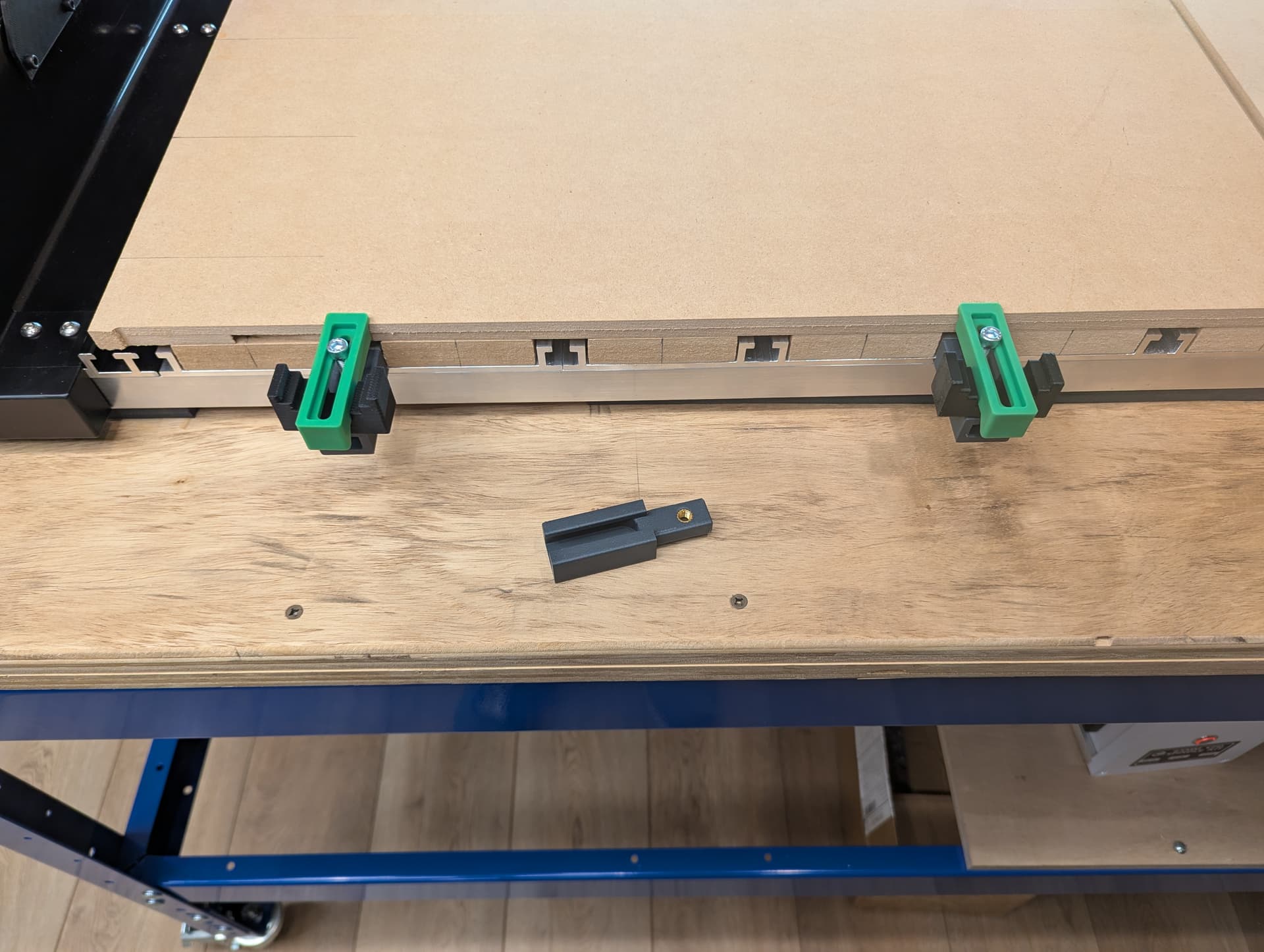

I struggled with the painter’s tape and CA glue method simply because with a full panel on the table I found it was really hard to get the tape on the underside of the workpiece and on the spoil boards that lined up without a lot of elaborate measuring. What I finally elected to do was one of Ryan Quick’s suggestions: make clamps that work. I printed extensions to allow me to extend the T-track out beyond the ends of the table.
The extensions are printed from a carbon-fiber based filament that is quite stiff and strong. I added a hole for an M6 heat insert thinking I’d secure the extension in the track with a low-profile flathead hex screw, but it turns out the fit in the track is snug enough that whole arrangement is solid after tightening the clamp to the t-track nuts.
-M.
Thanks for that photo and tip!

I like your solution for making the bed clamps useful at the edge of the T-track!
