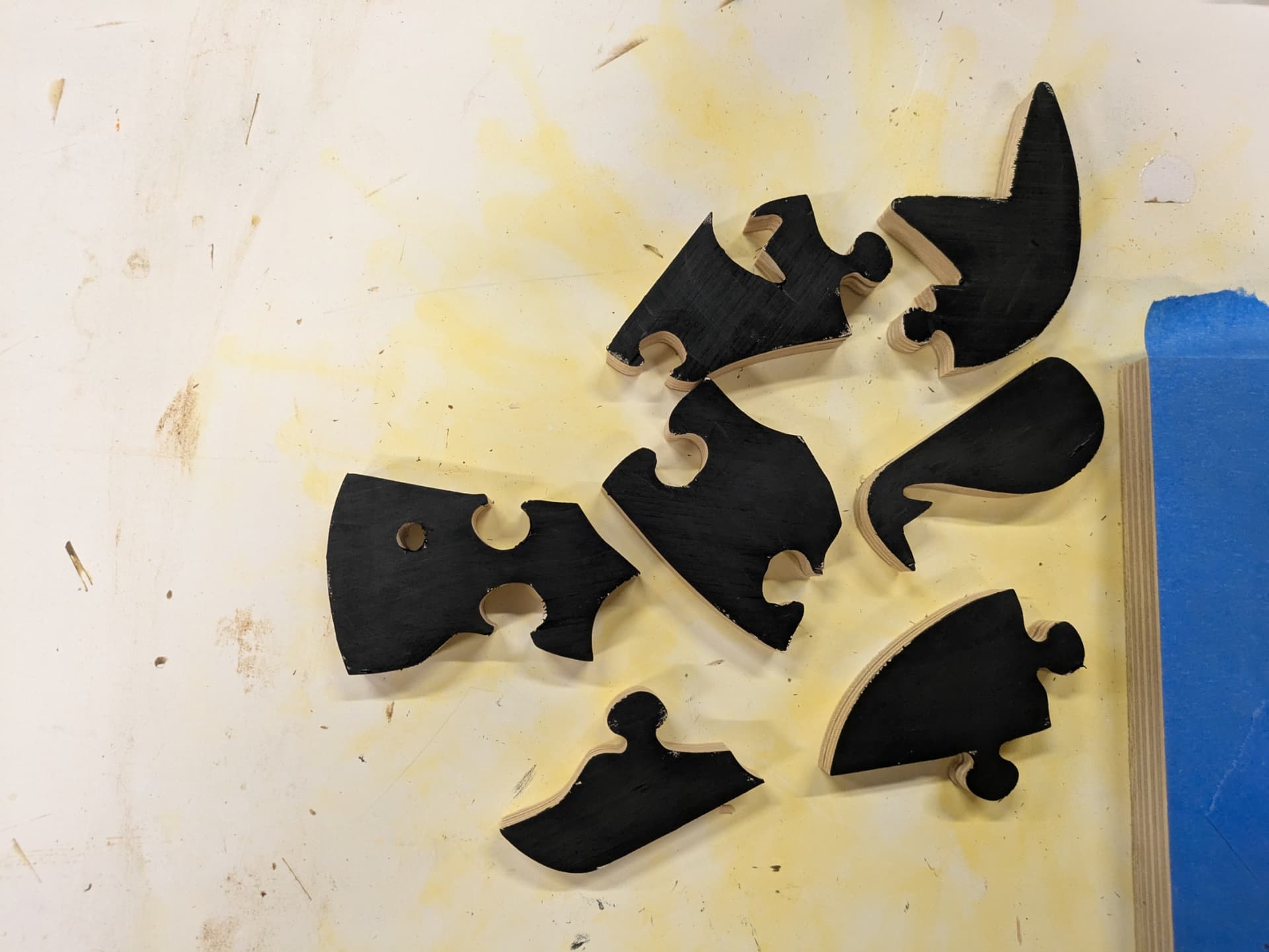

This second one was sent to me from here on the forum. I will look up who sent it to me and properly thank them. The puzzle came as a zip file and each piece of the whales were already individual pieces. I just moved them and figured out the offset to get them to fit into the negative space of the whale outline. I have them partially painted. Because these are small children I painted the back side of the pieces black and the fronts silver.

I followed the post from @WillAdams and the Whale puzzle seems to have been developed from him. Thanks Will. Each piece was already individually separated. I did reduce each piece separately by 0.015" with an offset and then deleted the original piece and kept the reduced size piece.
whale_puzzle_whale_parts.c2d (312 KB)
In the file above I moved each piece around after applying the offset. Then I saved the file as above. After saving I moved all the pieces out of the way and then centered the whole whale outline and did a contour of the whale on the inside all the way to the bottom. I then saved that file with another name. After cutting I glued a piece of 1/4" plywood on the bottom of the 1/2" baltic birch.
Here is the original whale with each piece separated. Just select each piece and move it away from the main whale. These were the pieces I did the offset to give room for the puzzle pieces to fit together.

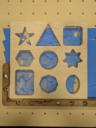

Here is my latest iteration of the shape puzzle. The star and triangle have larger offsets because of the sharp points on them.
Here is the beauty of using bottom of material and using painters tape and super glue. No onion skin and no cutting into my spoilboard. Also no tabs to remove when I do contour cuts like the individual pieces.
