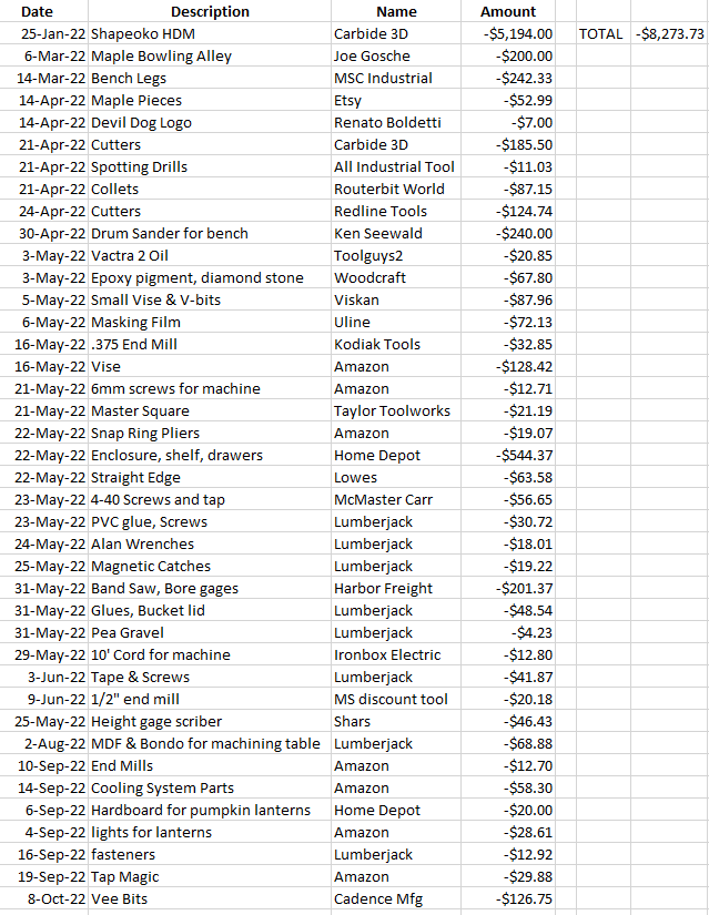

$5k machine, $3k in extra ‘stuff’. And I already had a bunch of tools that I didn’t need to buy.
And this is just the beginning!!! :smiley:

Let me know how the HDM works I plan on upgrading to it when I cut more aluminum. Also great job on the spread sheet that’s what I need to do and a great Idea.
