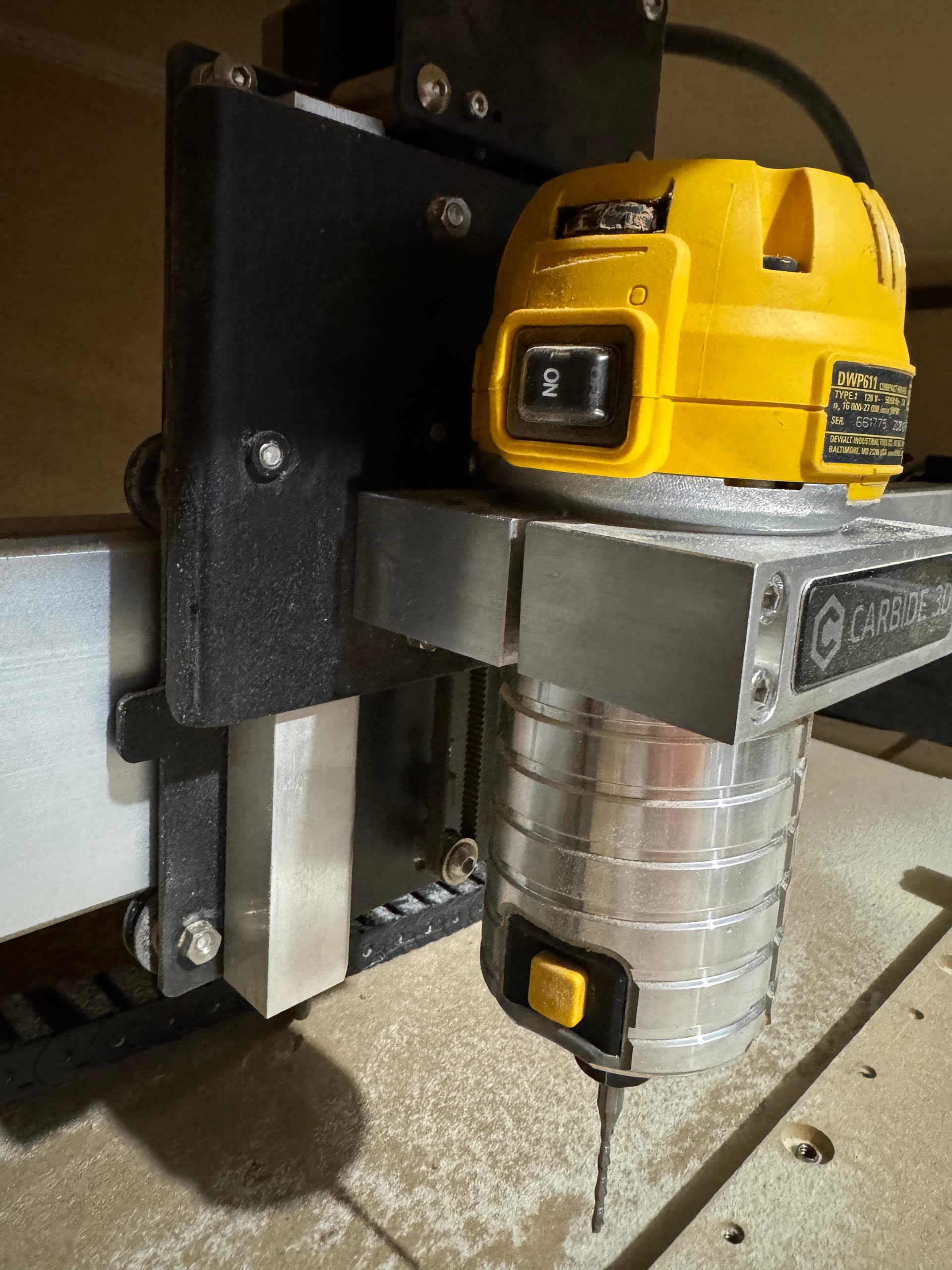

The machine cuts fine, and will do a full width project, no skipping or errors at all, everything is going great. Only thing that I keep having happen is when I goto Z the center mark and jog left it won’t travel past left center at all. If I adjust my piece a little right, and Z it there it will cut the whole width to the left tho, it is really weird. Am I missing something, software error, I have all updates…
Any suggestions?

Which machine type/size did you configure for?
Perhaps an incorrect parameter in the Carbide Motion settings?
How far you can jog the machine seems to be dependent on the parameters within Shapeoko.json in CM v6xx.
The parameters should be set for your machine when you run Setup Machine wizard.
It is the XXL machine.
I will definitely look into this, as it just stops on a dime and won’t jog anymore, will go up and down tho.
That did it! Thank for the fast response, it was set as the right machine, but when I changed it to belt drive it went further, It has the small black belts so it is a belt drive right?
Yes, the XXL is a belt drive machine. :+1:

If you are unsure of what you have post a picture of the machine.
It is definitely the XXL machine, belt drive; The settings come up as X:830mm Y:850 MM And Z: 100 MM when you put it on belt drive, which seems wrong as it will travel to the end of its X axis as you have to stop it before it hits. When you click on the “Load defaults” its comes up as X: 415 MM which definitely isn’t right though, but then select “belt drive” and it populates the X: as 830mm.

Could you post a photo of your machine and detail photos of your Z-axis, and controller (remove the cover to the enclosure and send us a clear, well-lit, edge-to-edge, in-focus photo)
